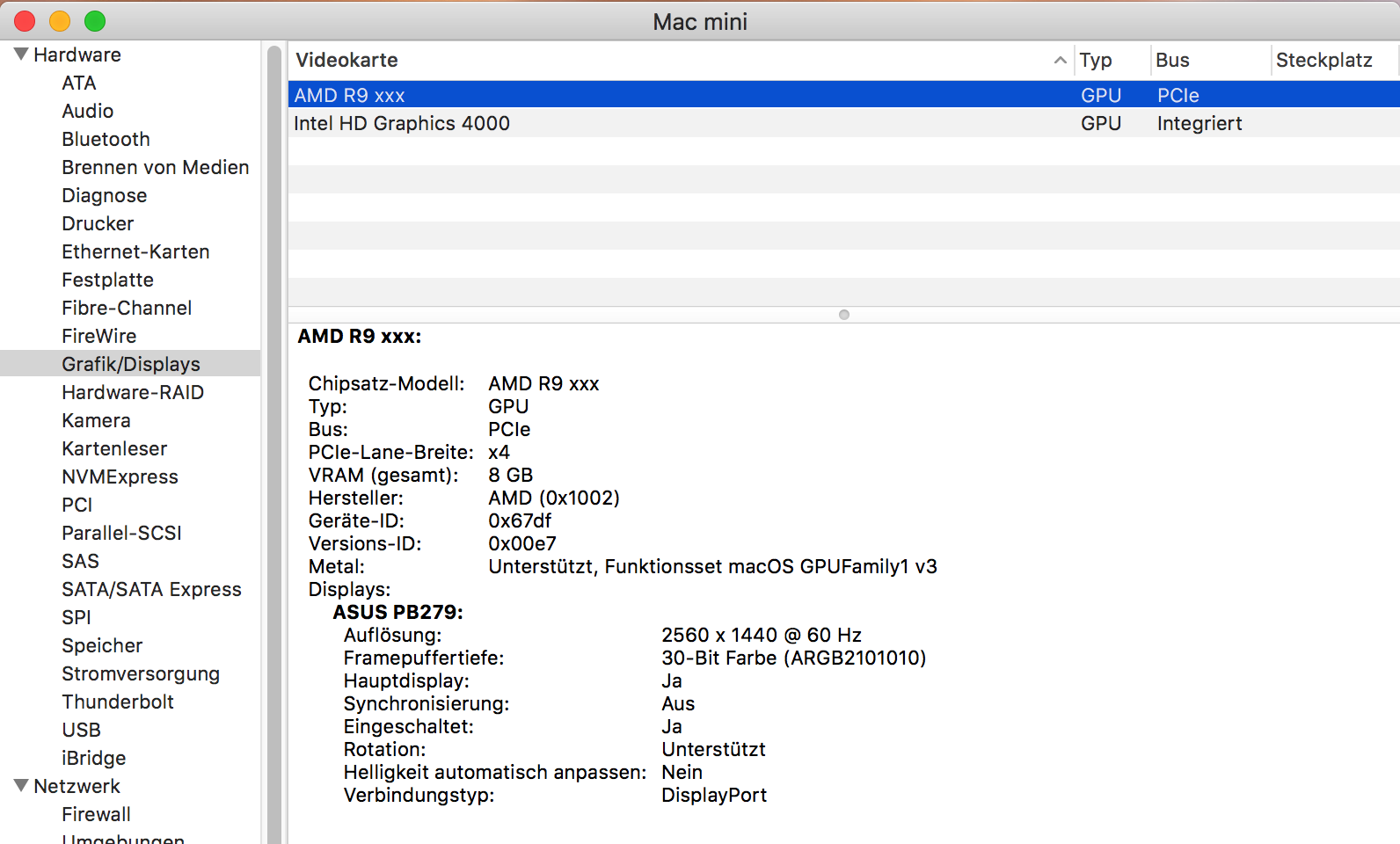

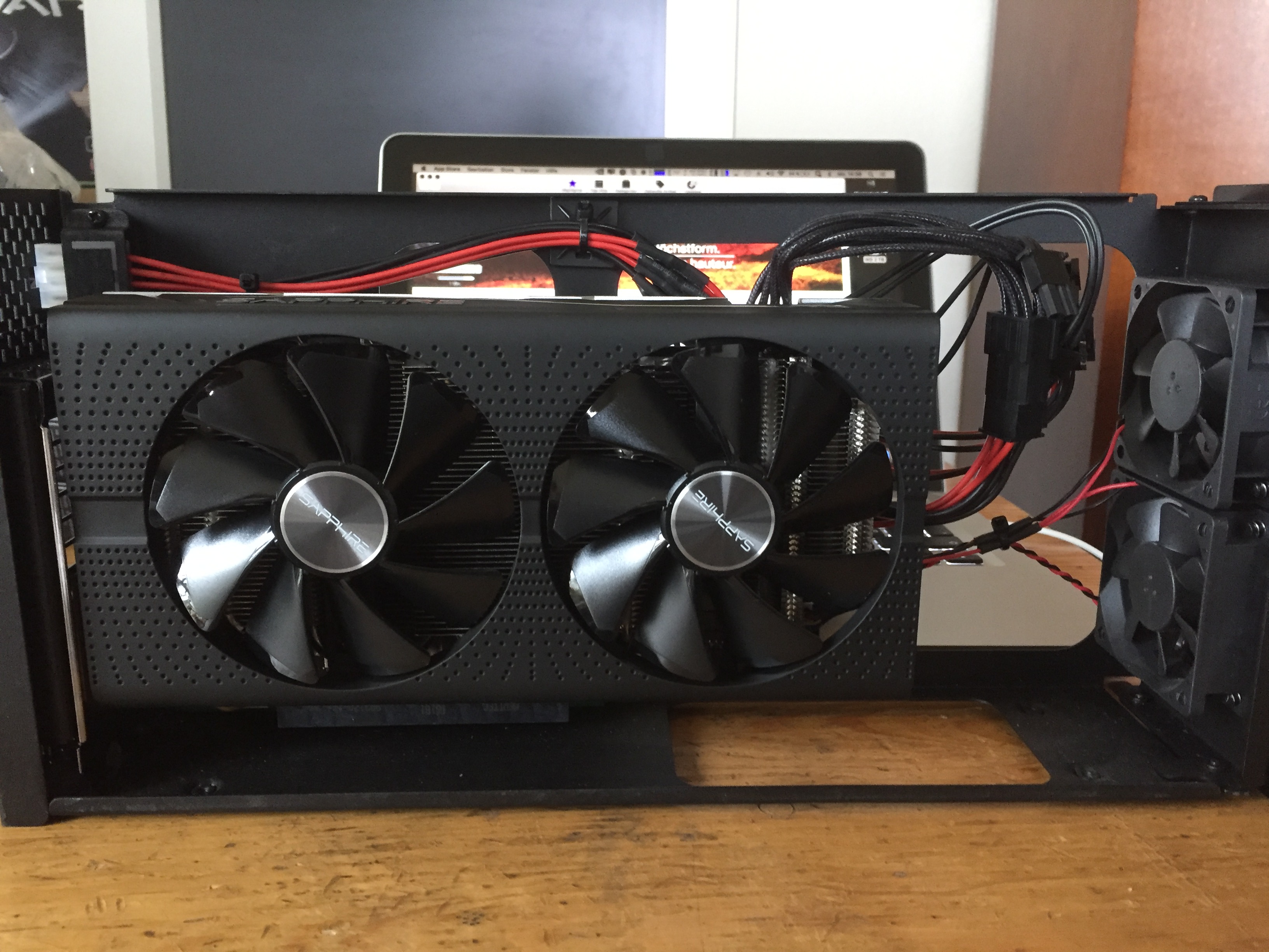

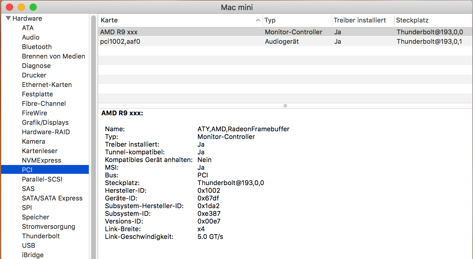

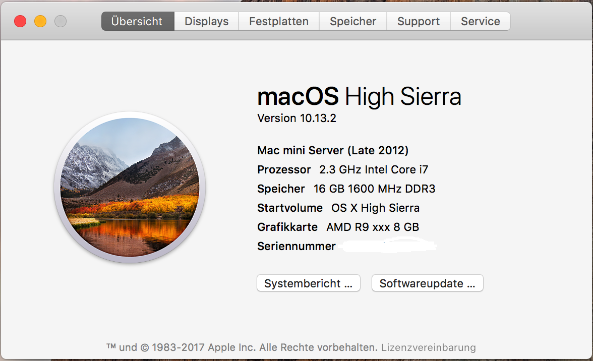

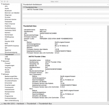

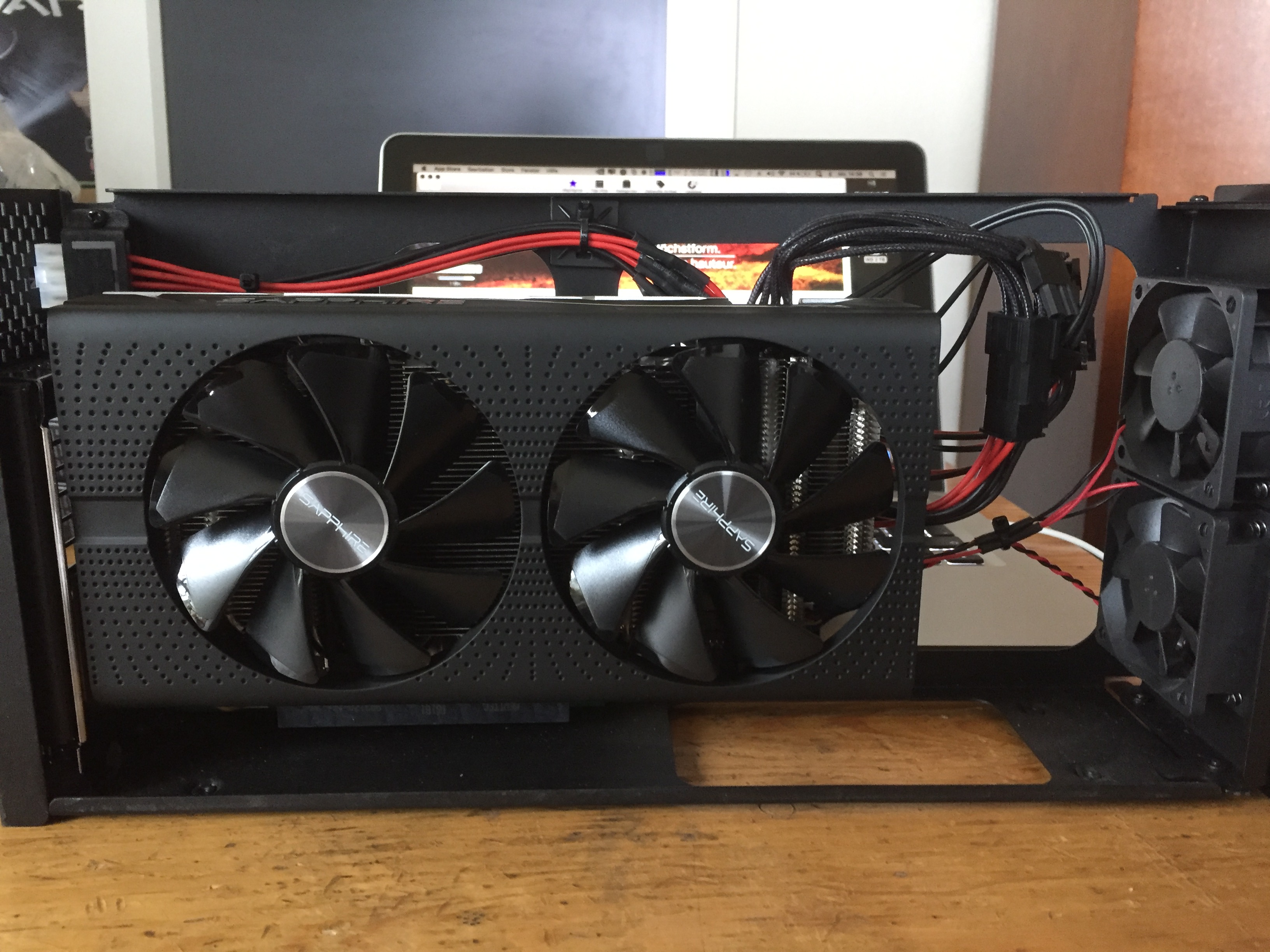

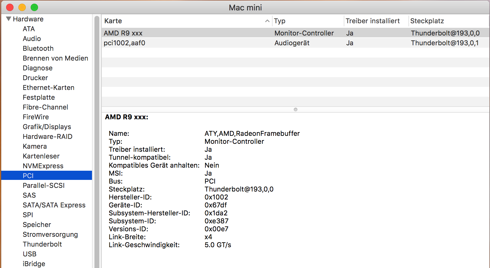

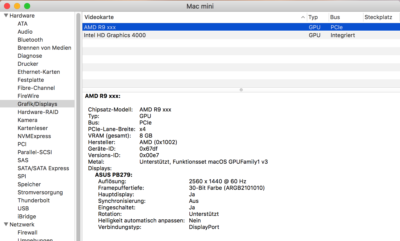

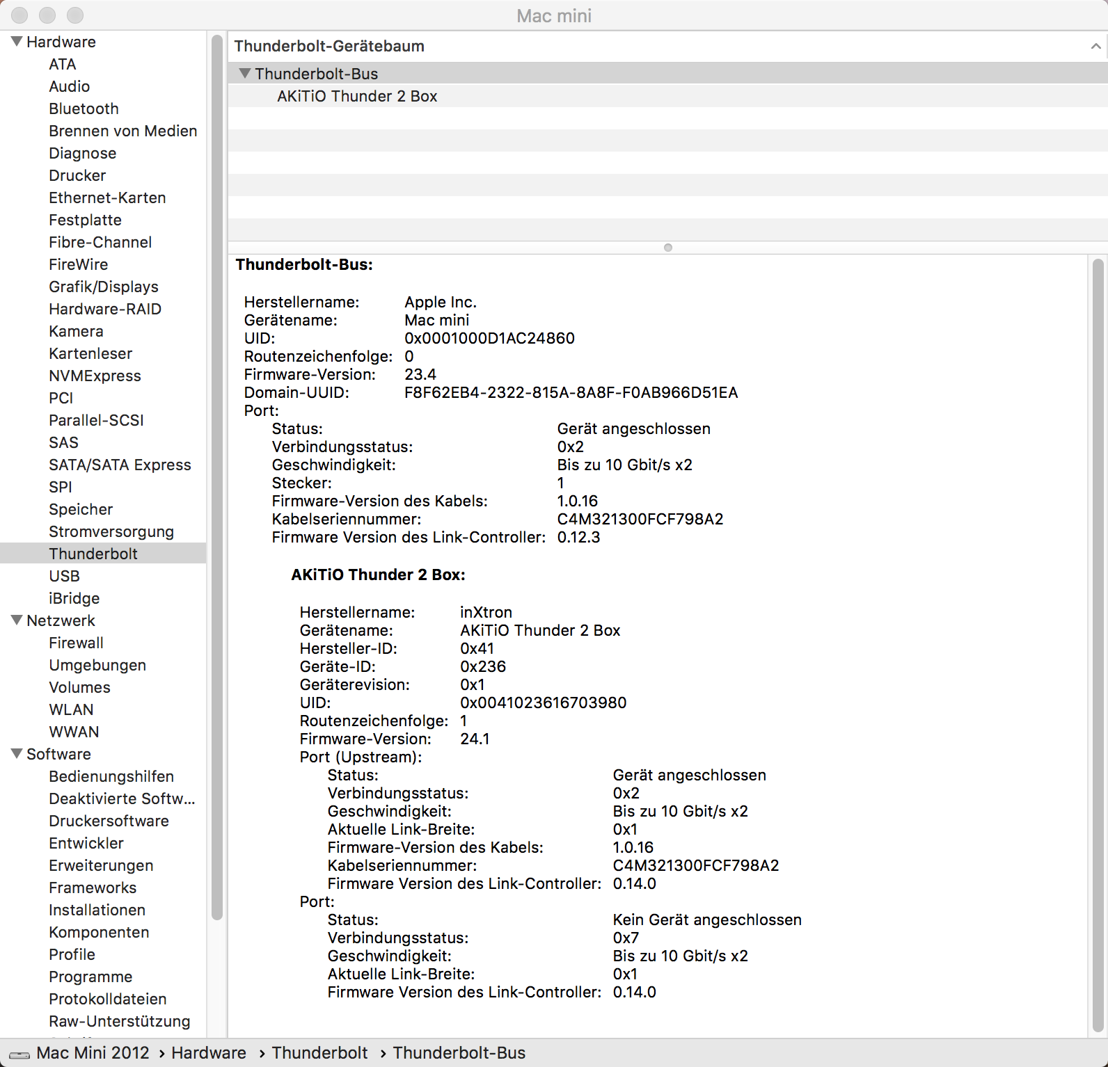

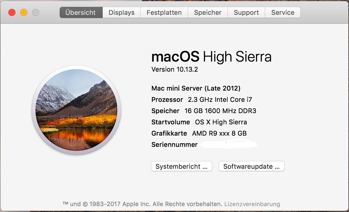

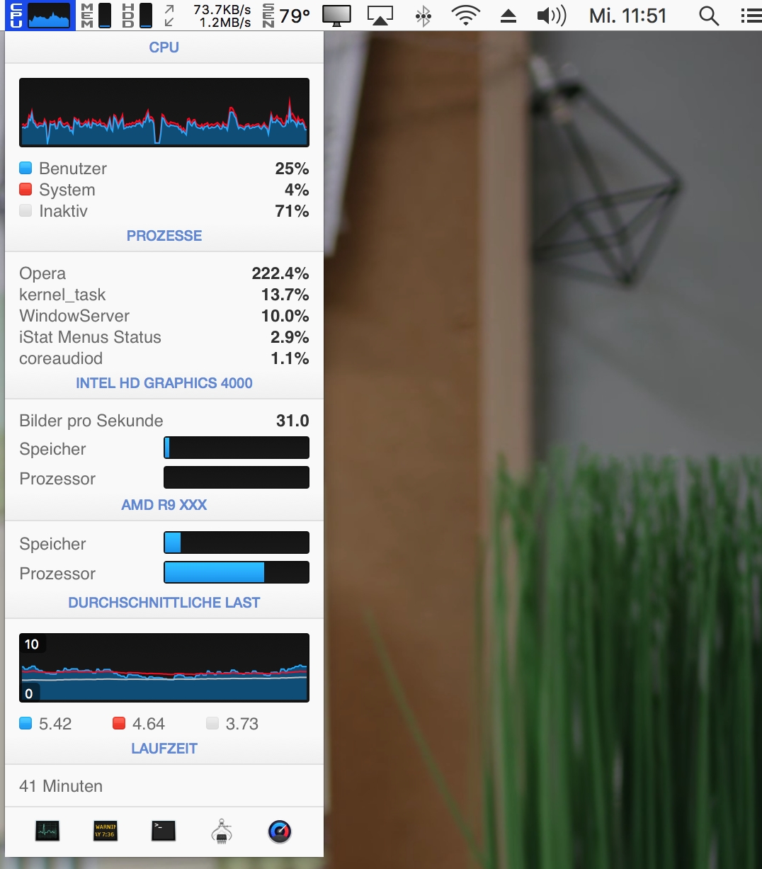

eGPU working with 10.13.2 without issues (even sleep works):
My config:
Apple Mac mini quad "Core i7" 2.3 (Late 2012/Server)
16GB
Asus PB279 4K Monitor (connected via DisplayPort)
Akitio Thunder 2 box
Sapphire Pulse RX580 8GB (albeit the card is recognized as R9 xxx card, because second generation)
Apple TB 2m cord (no TB3 to TB2 adapter needed)
OS X 10.13.2

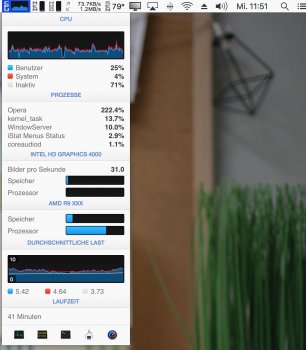

4K Playback:

4K @60 Hz is no problem with my TB1 configuration.
Do you use the Mantiz Venus with a Thunderbolt 1/2 Mac or a Thunderbolt 3 Mac?

1 - My Akitio Thunder 2 is modified with an external power supply
2 - Yes it is feasible, but no eGPU has boot screen, neither the officially supported Sonnett eGFX Breakaway Box. However it boots fine and the desktop appears in the moment the graphics drivers are loaded. HDMI is no problem if you use the Sapphire RX 580 8 GB (first and second generation).
