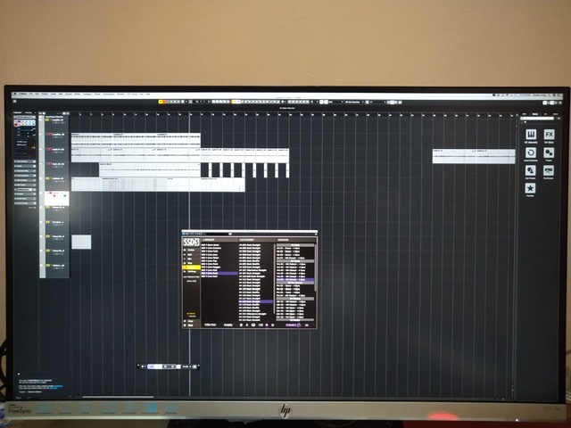

So much wrong information in comment I have to chime in. 1080 max is wrong! The Mac Mini can perfectly display 2560 x 1440 at 60hz. Source: I have a Mac Mini 2012 which I used with a TB display for 6 years.
Now I upgraded to a 4K screen and it can actually output full 3840 x 2160 but only on 30hz.
