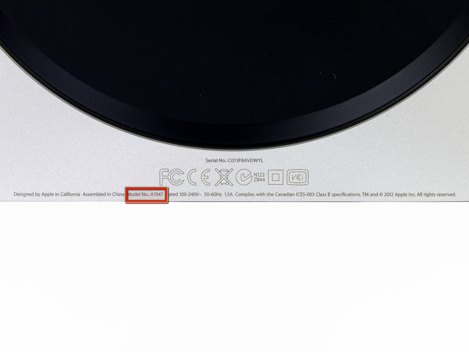

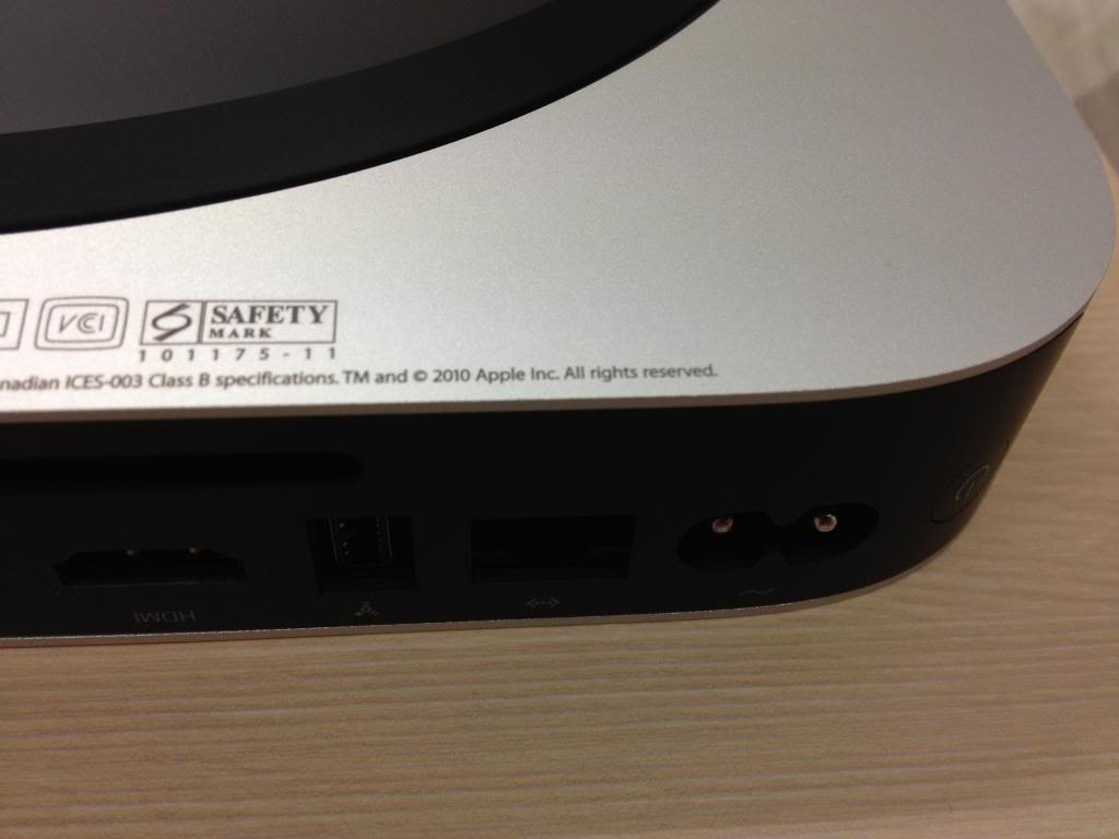

Anyway, Although I purchased my Mac Mini from the Apple Store, I am a bit curious about the printing in the base of Mac Mini. I bought the 2012 base model and I found that the year of the printing in the base is 2010. I saw a picture of 2012 Mac Mini in another website and it shows that the printed year is in 2012. Anyone can explain this to me?
5DLQLQMwSpVLrBgp.huge
I think you are worried about nothing. All mini's since 2010 have had the moniker of A1347. That is when they released the current flat 7" x 7" mini. If you are really concerned about whether you have a 2010 Mini (I'm sure you don't), you can always go to the "About this Mac" under the Apple icon in the upper left hand corner and check what it tells you. FYI: 2010's were Core2Duo based and not the new i5/7's in the 2011 or 2012.

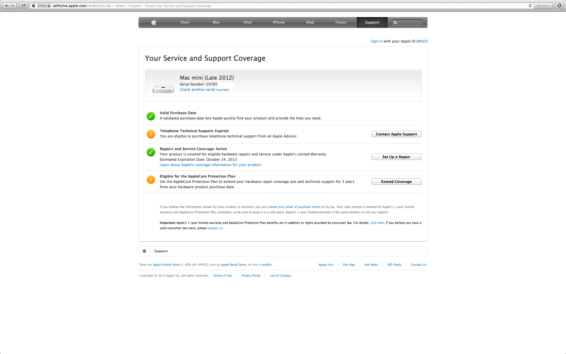

I punched the serial number in it reads the machine is a 2012.
I am pretty sure that I bought a 2012 edition of Mac Mini. I was just wondering if Apple used some old 2010 components to make a 2012 edition of this machine.
Did you try to insert the serial number in the second picture? It is not my Mini and it was taken from another website which shows the teardown of their machine.
I just looked at the bottom of my mid-2011 model Mac Mini i5 2.3Ghz that I purchased in late spring of 2012 and it also has the same text and 2010 date. It is probably only the general production run stamping for the aluminum shell part. It doesn't mean that they are using old used parts. It's much less expensive for Apple when these identical parts are manufactured in bulk production runs for use in the factories that assemble the new Minis in China. They probably have mass quantities of new shells for the 2011 and 2012 production years on hand. That particular assembly run of late-2012 Minis most likely just happened to use a new stock of 2010-2011 manufactured shells. The internal parts...logic board, HD4000 graphics, CPU, etc.. should be same as any other late-2012 model of Mini. If you are still concerned about it you can call Apple and get a confirmation from them. Hopefully Apple can also help figure out the signal issue you said you are having.
