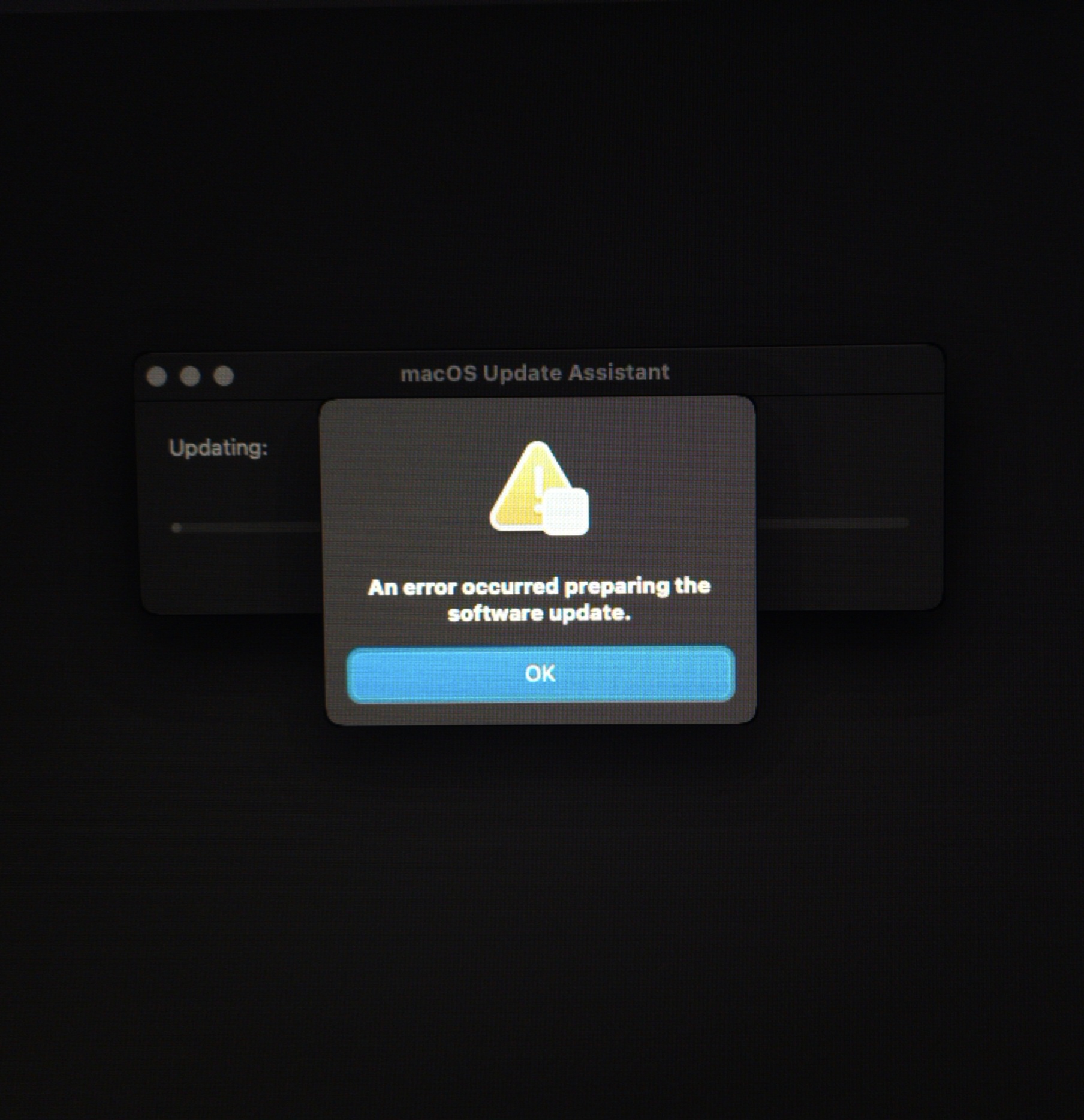

I'm trying to install Ventura on a Mac mini 2012 Quad Core CPU with Open Core Legacy, I followed step by step from here:
, but it doesn't install, basically after the first boot it tells me: An error occurred preparing the software update.
I tried by a clean install and also as an upgrade from Catalina, same error.
Does anyone know how to fix this?

Had the same issue. What I did was spoof the smbios to a suported model (I chose MacPro7,1 but it shouldn’t matter as it is suported) and it installed fine. Then installing Opencore to the disk with the default settings.
I tried to install Big Sur and Monterey, and both of them were installed without issues, only Ventura is the problem.

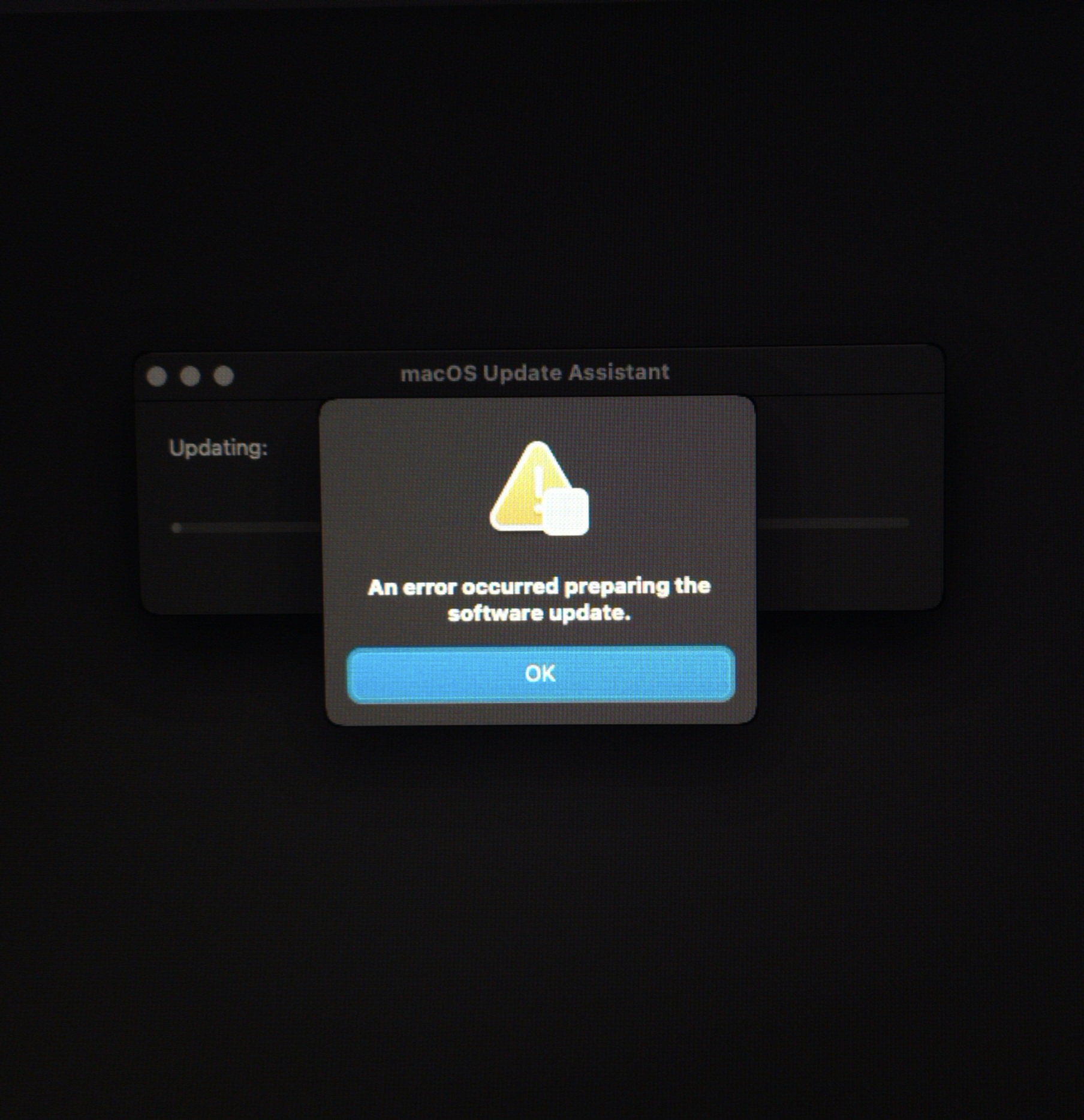

Yup same error message on my 2012 Mini. I must have built OCLP at least 20 times. Same result until recently it installed. Try installing the EFI bootloader to the internal drive instead of the flash drive. That worked for me but i've got to say, Ventura ran on my 2012 i5 Mini like I was slogging thru mud. I went back to Monterey and HUGE difference in responsiveness. Perhaps your quad core will fair much better than my i5 C2D.
How exactly i have to install EFI bootloader? Could you please guide me? What i have to do, step by step?
Is not about the steps, the steps are okay also on the first post video, what I noticed is that at the beginning when starts to install, before the first boot, at 13 minutes it restarts, then after the restart and around 5 min appear the error.
So, I things it misses some stuff when it restarts at the 13 minutes left, but I don't understand what and why.

Already tried a new thumb drive, and changed the port, the thumb drive is a quality one, 3.2. What is strange, is that Big Sur and Monterey install without any issues.
Yeah, I tried also to be connected to the wifi with the internet active.
I followed the steps, one by one, with no mistakes.

I have already 4 days installing and reinstalling it, and every time I am on the same error, maybe you were right that can be a Ventura issue, maybe I try another previous Ventura version.

I solved the issue in a very strange way, by installing a clean Monterey via USB with Open Core Legacy, then just upgrading directly from Monterey, no USB, to Ventura, via Software Update, and is working, very strange.

Awesome news and congratulations. I did not make the connection until you mentioned it. I also had the same problem installing Ventura using OCLP from Catalina. I had never used an unsupported OS on my 2012 Mini. So I got tired of the problems instilling Ventura and went to Monterey and that worked. I then tried installing Ventura and that installed.
So perhaps, Ventura is looking for a specific version of EFI FW to update. Going from Catalina straight to Ventura might flag an update issue because it's not at a level that it needs to update. Installing Monterey from Catalina is several versions of macOS and surely it would have probably updated the EFI FW prior to that.
That's just an educated guess as to why the Update error shows up and goes away if you install Monterey prior to Ventura. 🤓
