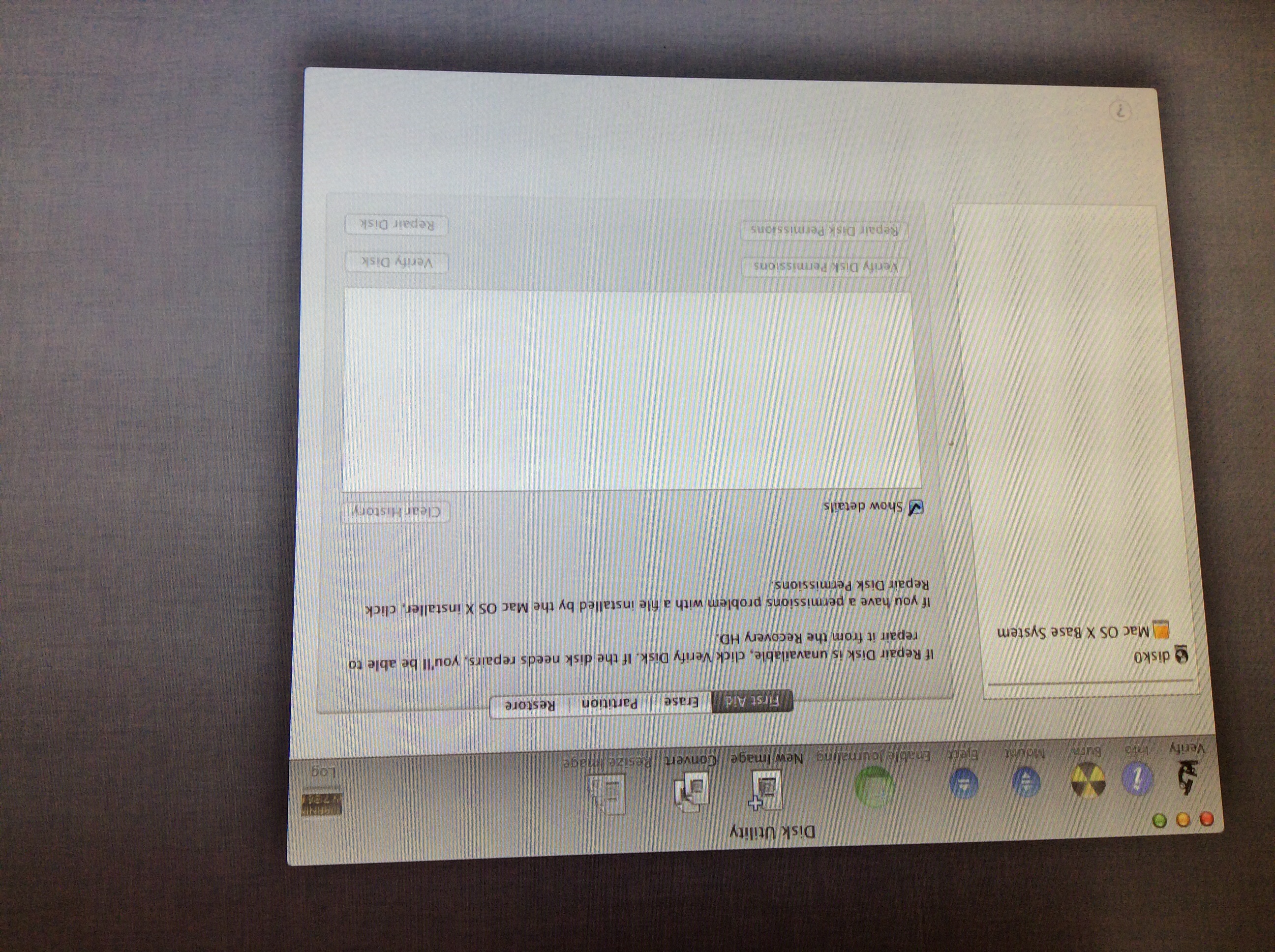

I don't see my hard drive in the disk utility. All options are greyed out. It looks more and more that my hd is dead.
See attached file.

Yea, there's a good chance you're hosed. Like I said, hope everything was backed up.
It might be a loose cable inside - though that seems unlikely unless you bump the computer often. The more likely thing is that the drive died.
I would first try unplugging the drive and plugging it back in. If that doesn't fix it, I would try another drive (either one you already have, a spare from a friend, or buy one you can return from best buy or something). Then take it from there.
