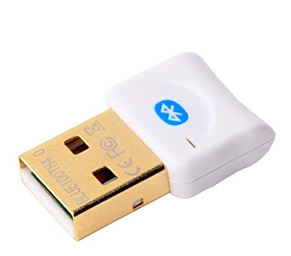

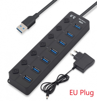

Had an issue. The reason is that my Mini is in closed rack, so issue is expected (worked fine on a classic wooden table).
Issue solved with USB Hub, which I need anyway and a CSR8510 Bluetooth Micro Transmitter And Receiver.
