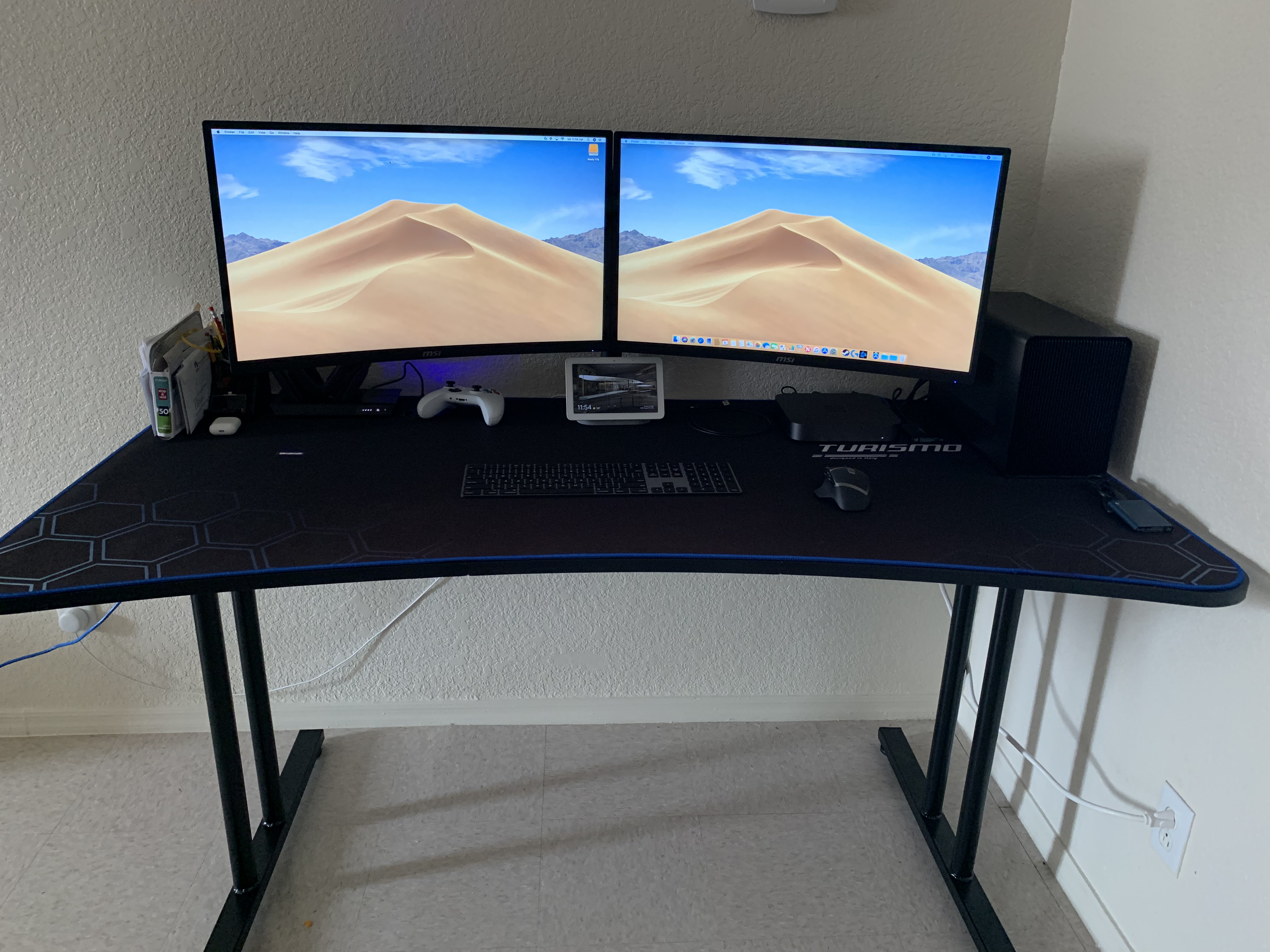

So what you asking is almost the exact setup I’m currently running. I play wow on max settings and run consistently around 100 FPS. The only difference being I went with 2 27” 1080p MSI 144hz screens

[doublepost=1554419753][/doublepost]I was able to snag a Vega 64 on sale for only $399 which at the time was cheaper than the Vega 56 so the 10% thing didn’t really matter to me.
