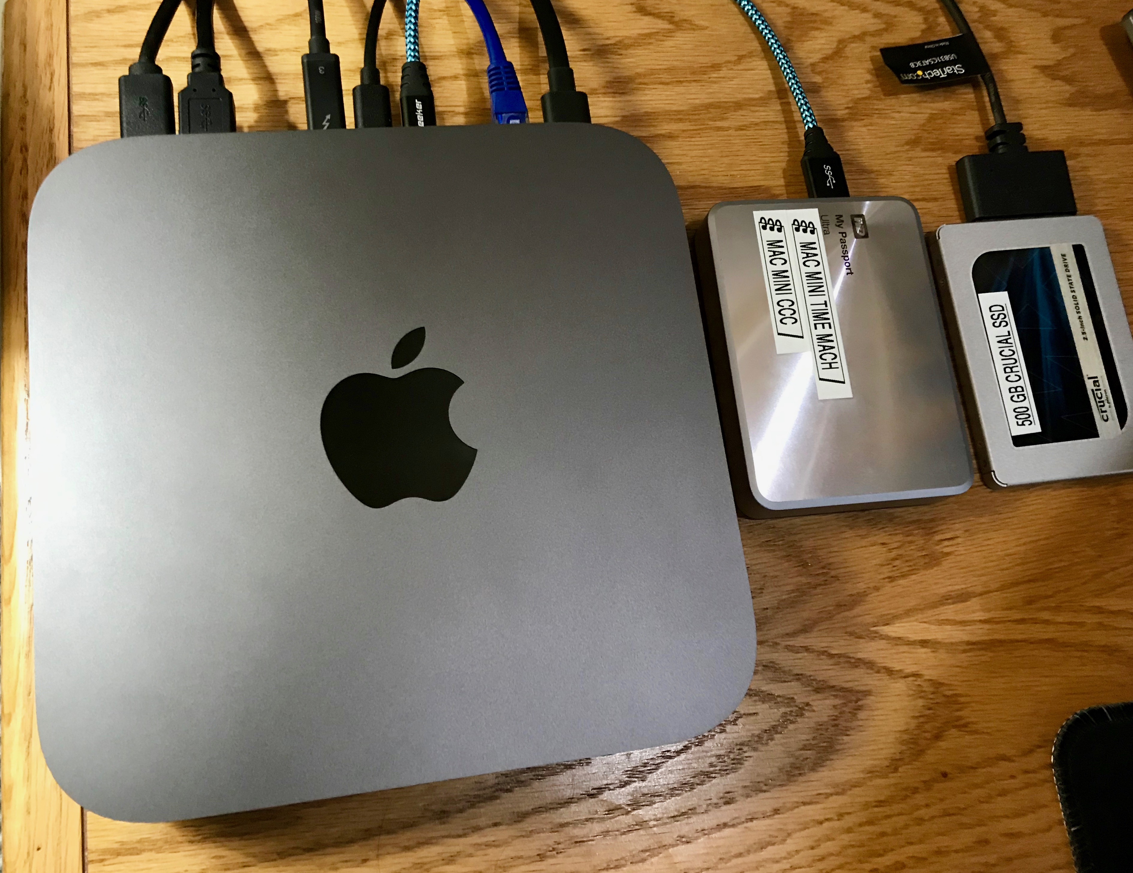

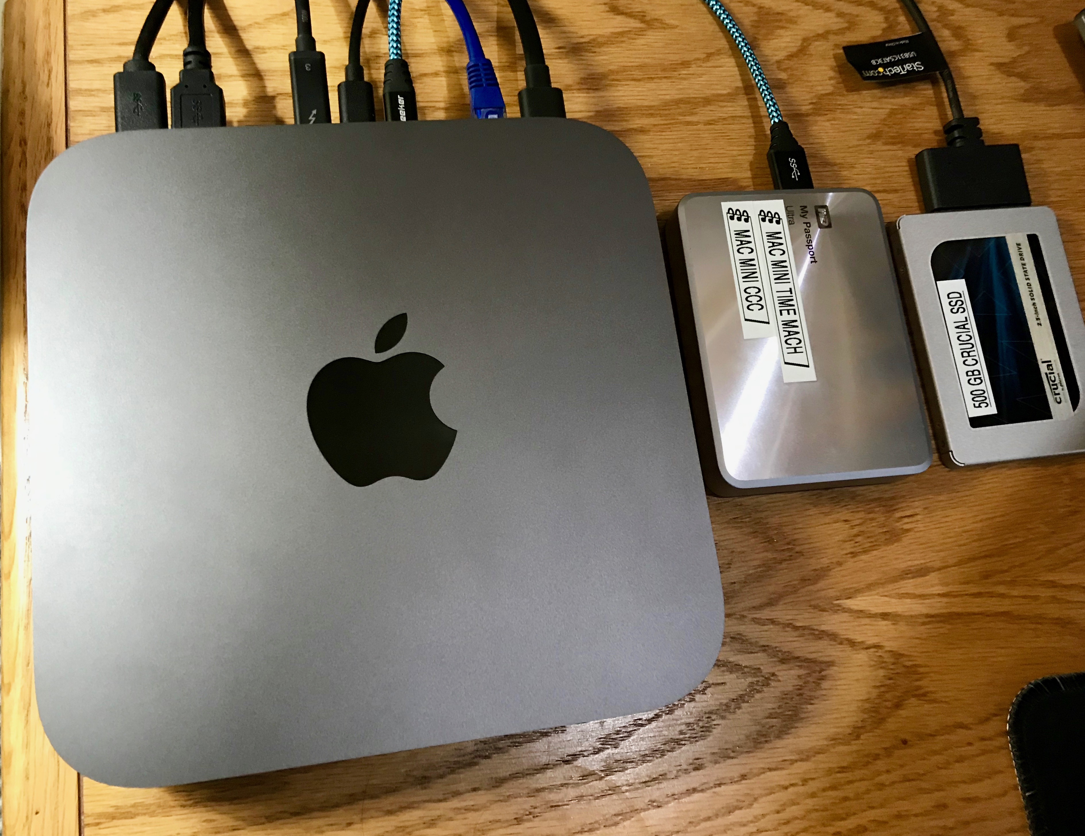

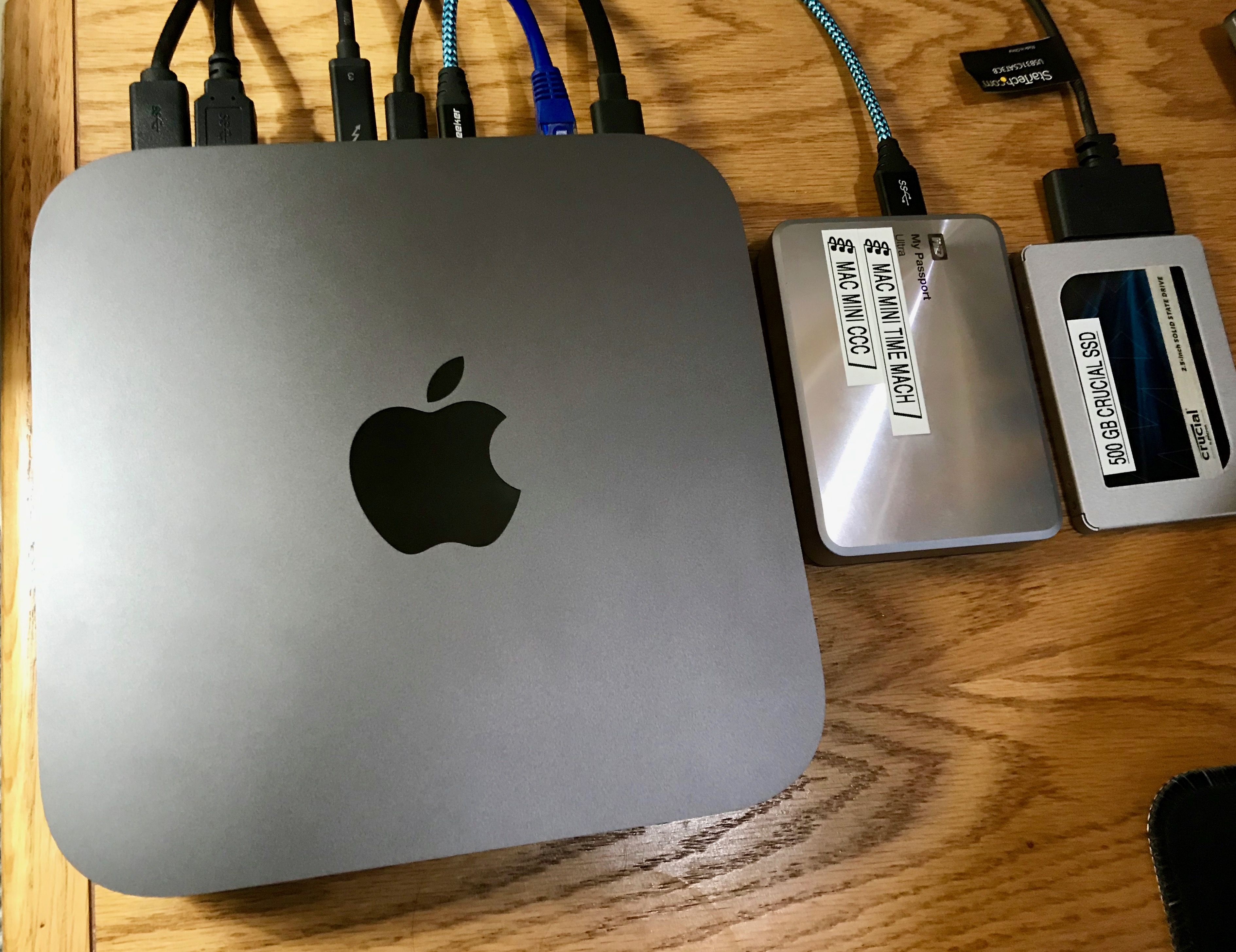

I just set mine up 24 hours ago. I am using both USB-A on the MM (Das Keyboard and one to the Dell Monitor for USB upstream) I then have 2 more USB-A downstream on the back of the monitor which are being used for webcam and printer. I have 2 on the side of the monitor for charging etc but I would not want anything permanent on the side, I rotate my monitor often for working out.
I am using 3 of the 4 TB3 ports. #1 for eGPU, #2 for 500GB SSD M500 extra storage (games, etc), #3 is an older WD 2TB spinner that I partition the drive for Time Machine and CCC and plan on leaving them permanently attached for auto updates.
Its early but I have backed up and did not have any issues. I did not even think running the spinner in the TB3 port would be an issue. If I had something else I needed to put in the TB3 port, the spinner would be coming out and moved to a new configuration.
From your picture, I can see that the 2TB HDD is USB-A (It reads Super Speed USB) connected to the USB-C port on the Mac, that's not a true TB enclosure, which seems to be the problem.
I also have been using USB-A enclosures connected to the USB-C port and they work perfectly. What didn't work for me was a trully USB-C to USB-C enclosure.
