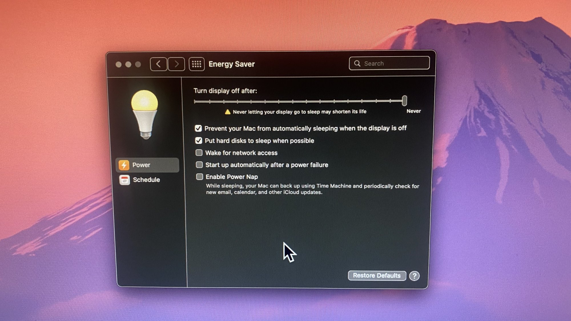

So, my recommendations are:
1. Shutdown and power on again instead of restarting
2. Set your Energy Saver prefs so the computer doesn't go to sleep. (Display sleep seems to be OK.)
3. Delete the preferences files I listed above if necessary.
4. Reset your NVRAM if necessary.

Computer won’t wake from sleep and drive displays - turned off sleep. Turning off sleep has not fixed the issue. Terrible Bluetooth. Terrible wifi. Bought new apple mouse and keyboard but it didn’t work. Now I run wired everything.

Computer still has problems waking displays up unless I use third party app. So, for now I have prevented the displays from sleeping and just turn off ASUS when not in use.
