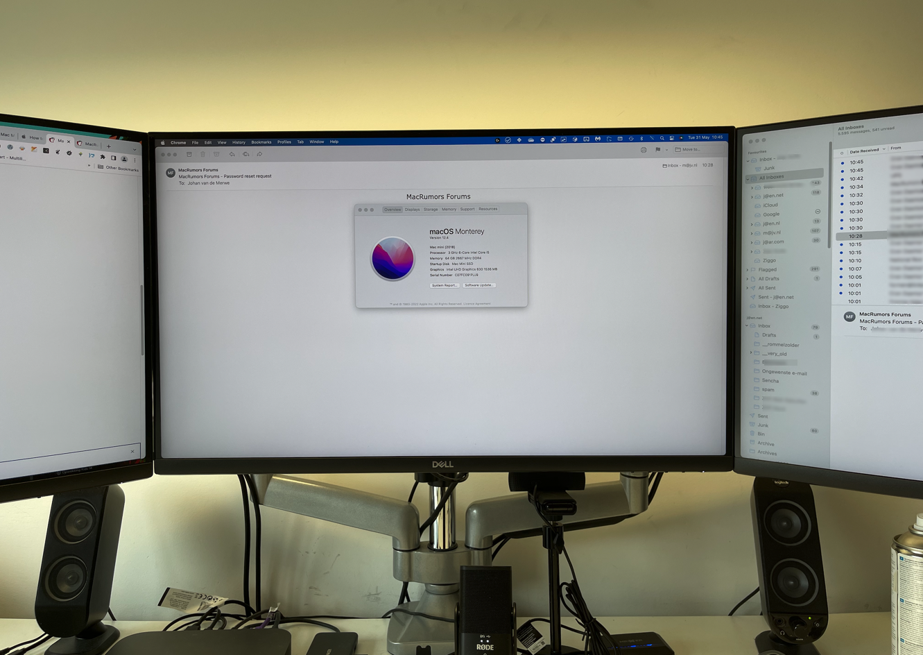

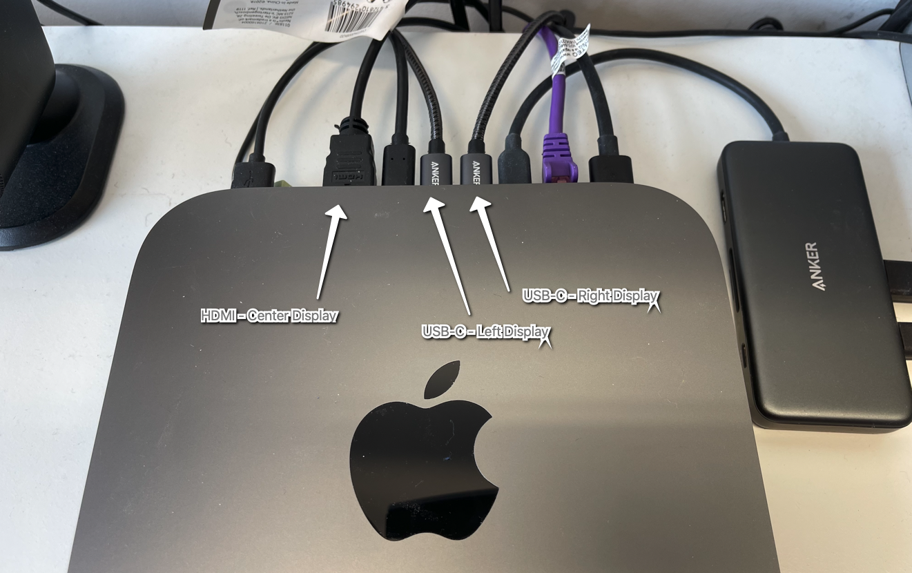

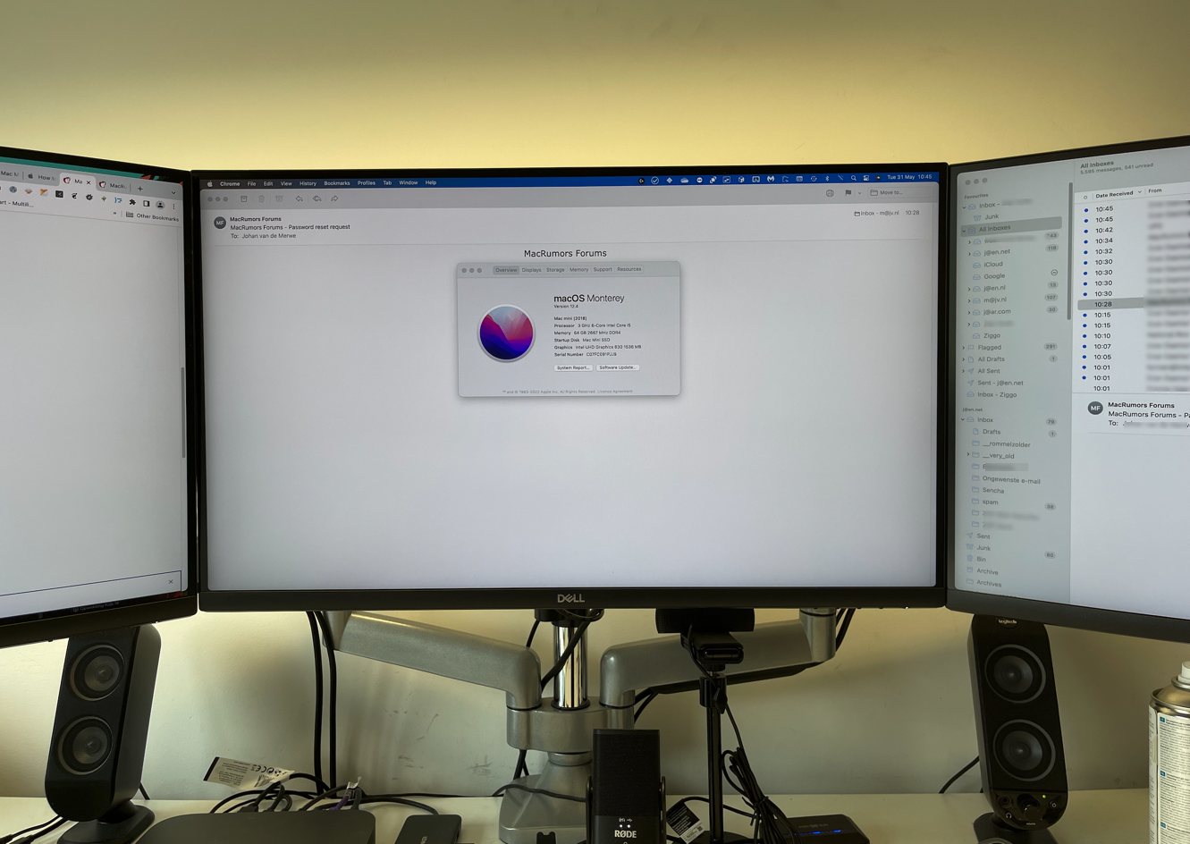

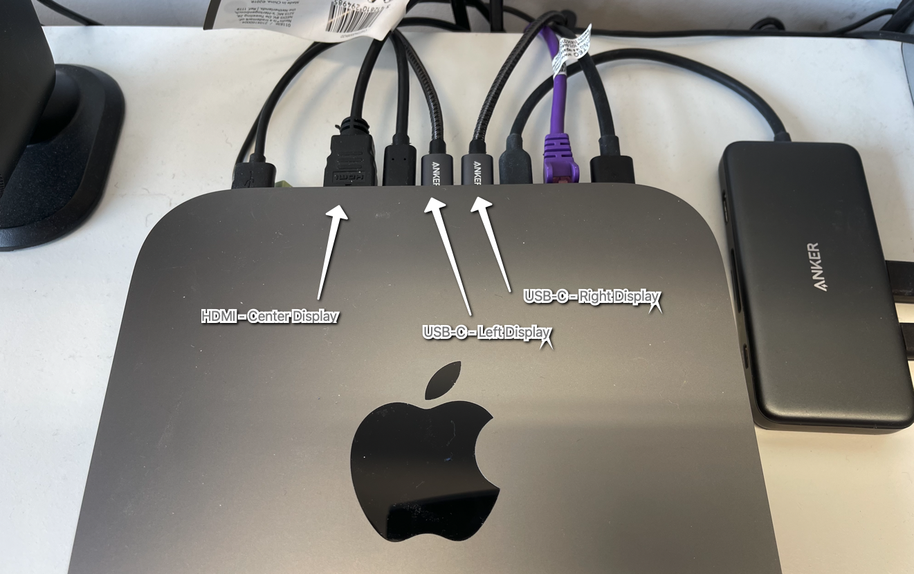

I have a Mac Mini 2018 and have 2 Anker USB-C to HDMI cables connected to Dell 27 inch 4K displays. The third display is also a Dell 27 inch 4K display, but connected to the HDMI connector of the Mac Mini. On the Mac Mini I have Monterey (12.4 at this time) installed.
All displays were working at first, but after I put the Mac Mini to sleep, once started up again, the HDMI connected display didn't turn up again. The Dell showed "no HDMI cable connected" on the HDMI connected display. After switching some cables and turning it off and on again, I only knew that all cables were OK, just the Mac Mini HDMI didn't respond.
Long story short, I shutted down the Mac Mini. I disconnected the Anker connected USB-C to HDMI devices. Just left the HDMI connected device. Turned it on again and the display showed up again. I connected, without shutting it off again, the Anker cabled devices and all 3 displays were working again.
Strange thing was though that the Dell display settings of the HDMI connected display were all back to default. I didn't reset it when trying.
Really hope this helps someone.
