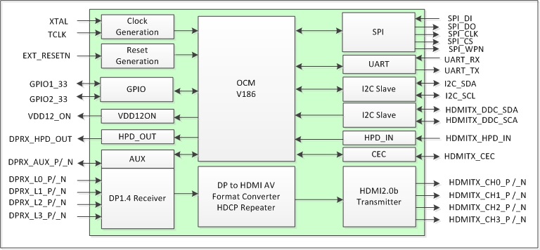

I found this teardown of an M1 mac mini:
It contains the same MegaChips MCDP2920A4 DisplayPort 1.4 to HDMI 2.0 converter as the 2018 mac mini! My concern was now that a new mac mini exists, I wouldn't expect any firmware updates... but the M1 mac mini uses the same converter chip, so maybe a firmware update will come out for both machines. This is also the same chip used on the Apple TV 4K.
I no longer see this chip mentioned on MegaChips' website, but the M1 mac mini teardown does have a MegaChips logo on the chip. I now see the MCDP2900 series listed with another vendor kinet-ic:
Data sheet has a Feb 2020 timestamp

I like the Mac mini 2018 because of the 64 GB option. But HDMI to DVI is essential for me. I contacted the Apple representive i was working on the issue to get an update when the fix will be available. Now that we know that the Mac mini M1 internally use the same MCDP2920A4 DisplayPort 1.4 to HDMI 2.0 chip there should be a solution soon.
