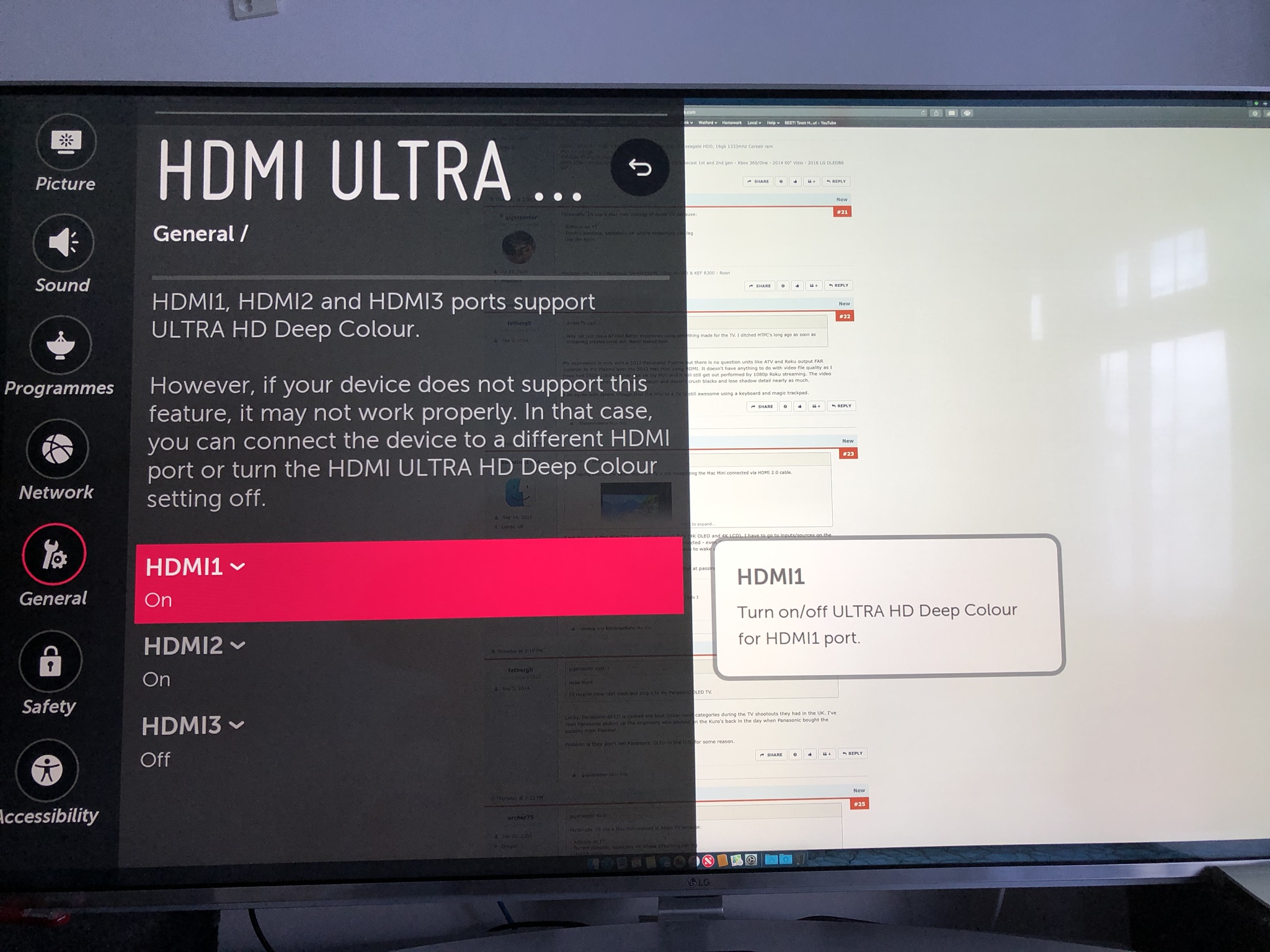

Actually you are right about setting hdr on the port. This is how I ended up getting it back on using the original port.
Thanks, Yea tried that and they are all switched off.
[doublepost=1543145049][/doublepost]Actually turning the hdr on did work! Thanks
Ugh, glad to know it’s not just me but what a ridiculous scenario, will do a full reinstall and never go near the display settings. Which is annoying as scaling would be ideal on a 4K tv, in fact it might make it unusable for a living room setup.
Might have to return it!
[doublepost=1543142091][/doublepost]
Yes turning it on helps. You can use scaling after that too so your desktop isn't so huge. Also in TV setting make sure it's set to PC too.

[doublepost=1543145049][/doublepost]Actually turning the hdr on did work! Thanks[/QUOTE]
Just to confirm turning on hdr does allow you to scale?
Just to confirm turning on hdr does allow you to scale?[/QUOTE]
Yes it does, it's just something along the colour profile which is cocking things up. Turning HDR on does cure the problem.

Just turning HDR on the HDMI channel fixes it 😀 Or resetting the HMDI channel. It's a bit weird I know that. Never come across this type of issue before and I work in media production.
Wow Can’t believe that worked. What a dumb fix.
