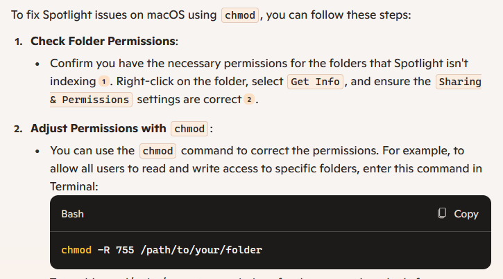

I fixed my spotlight searching problem for external drive by the following:-
It has been working for my MacMini M4 with external drive for a few weeks.
