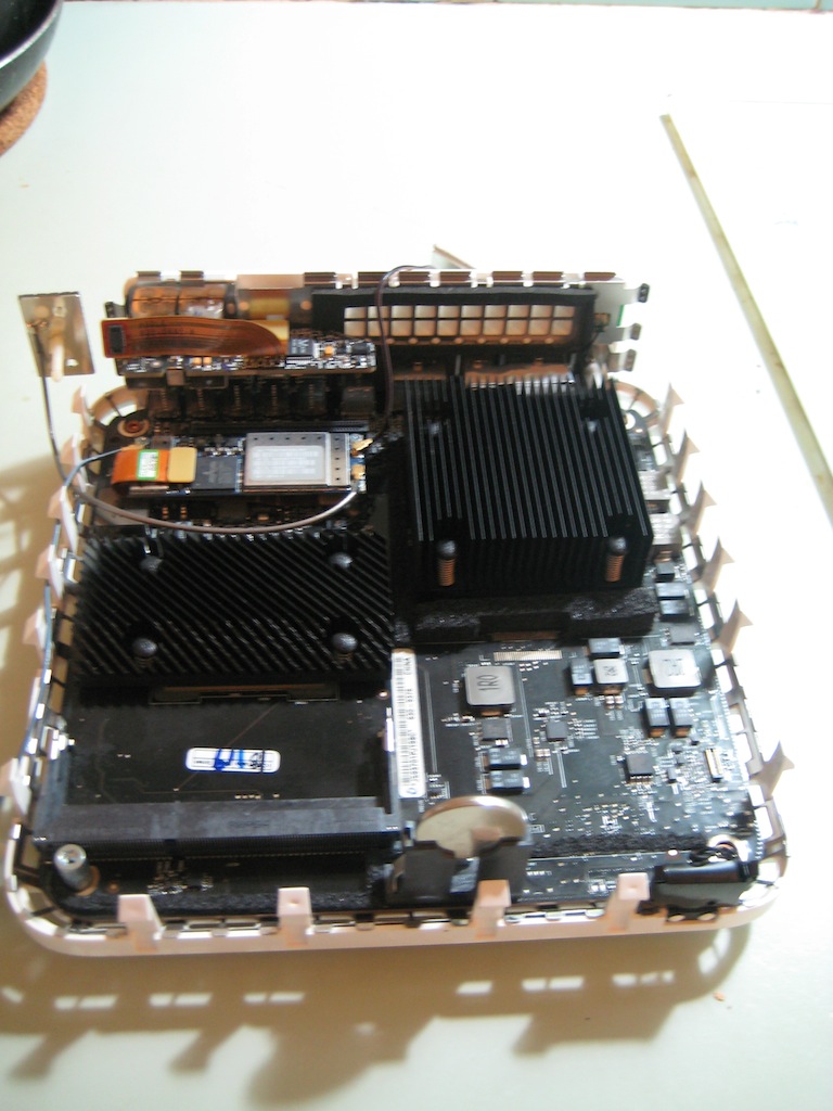

I have attached the photo and this give you abetter view of the model. I bought this mini sometimes end of 2008 or early 2009 . .(can't remember)

You can enter your serial number here where it says "Search Tech Specs" to find specs for your model.
Here are the instructions for your model.
