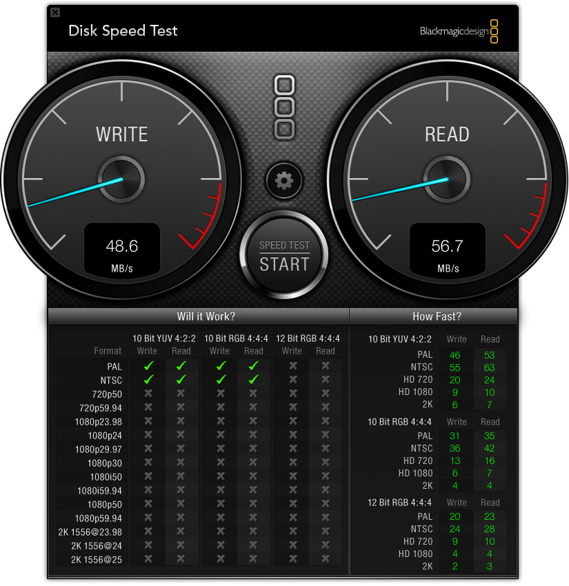

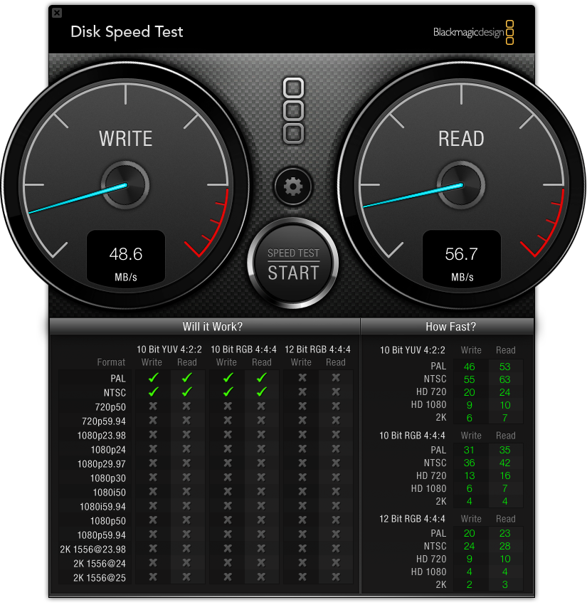

I did a speed test, to try to see what a difference an SSD would be.
but the speed test showed me a max write speed of 50MB/s.
I thought Sata and the stock HDD would be capable of faster speeds?
I tested my external lacie disk over firewire, that had speeds close to 70MB/s.
Is this normal? and what's the explanation?

not much difference, shouldn't it be faster?

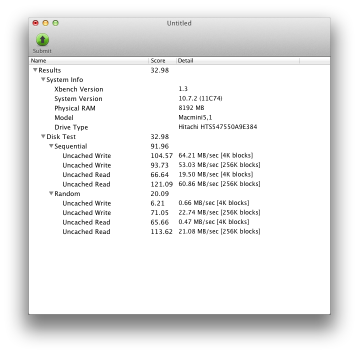

Well my 2010 mini with the 320GB 5400rpm drive has the results in the attached screenshot. So pretty much the same.
Your external is a probably a 3.5" correct? I have several 3.5" lacie externals and they are all 7200rpm drives. Even the really cheap one I bought.
3.5" HDD's are quicker than 2.5" and also your stock mac mini HDD is 5400rpm. The external drive is a lot quicker then the your MM drive, its probably maxing out the firewire speed, and would presumably be capable of around 100MB/s connected directly through a SATA port. My 2.5" lacie little disk connected though FW800 is a 5400rpm drive and averages 55MB/s.
I haven't seen a 2.5" 5400rpm go above 70MB/s in benchmarks and above 55-60MB/s in real world usage.
The speeds you are getting from your MM is normal for a 2.5" 5400rpm HDD. The 7200rpm HDD that was in my MBP achieved a max Read 110MB/s, but was averaging about 90MB/s.

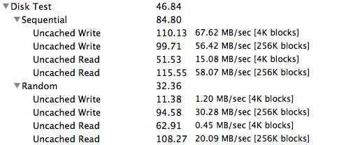

quick rule of thumb
2.5 inch
500gb 5400 rpm long read write maxes at 60 at the beginning of the drive
500gb 7200 rpm long read write maxes at 90
fastest 2.5 inch is wd scorpio black 750gb can run at 110 long read writes.
for 3.5 inch some 2tb can go to 150 on long read writes.
long read write numbers only offer value for cloning time.
that is to say a 2tb hdd like a caviar black filled with 450gb of info like movies will clone way faster then a 500gb 5400 rpm mac mini internal hdd filled with 450gb of movies. clone time may be 1 hour vs 3 hours in this example.
most hdds are slow as molasses when writing and reading small files. .5mb to 2mb is common. that is why ssds seem really quick opening and closing programs.
