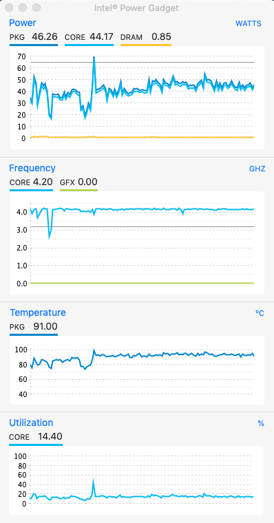

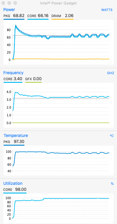

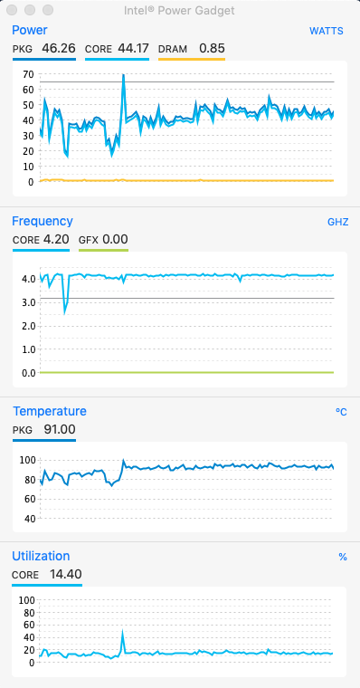

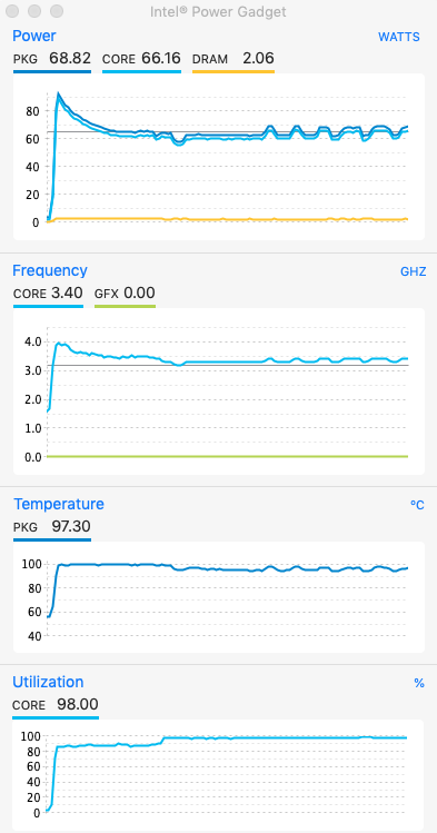

Hey OP, how is that i7 holding up? Have you pushed it a little bit harder? I’ve heard it overheats, can get to 100 and then throttle little bit, but it is mainly just under 100 when pushed to the limit.
My fortnite temps and handbrake temps, handbreak throttled @ 3.4 with the high temps, it might be an overall programming thing, it's weird that fornite was able to ramp up to 4.2ghz around 91F, but only 5 or 6 and it slammed the frequency to 3.4.
Overall my encoding is done with MediaEncoder so I can use the GPU.

View attachment 802913 View attachment 802915
Fortnite is horrible on Mac. Were you playing on Mac or Windoze?

On your second plot your core usage is pegged at 100. I would guess if you would have had Activity Monitor running it would have shown all 6 cores and 6 virtual cores (all 12 threads) would have shown near 100% utilization. The other sustained numbers in that second plot:
~65w
~<100 deg C
~ 3.3 to 3.4 GHz vs. 3.2 base clock
are not disappointing to me as an owner of same machine.
