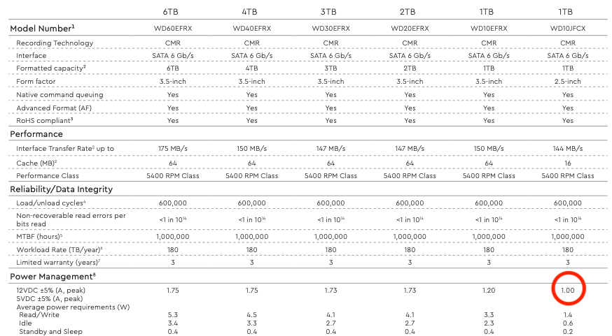

I went into the WD RED specs and saw that it is using 12v instead of 5v. So that could be the reason why it would not turn on in the mini. This is very much like the WD velociraptor in the past, which is a thicker 2.5" hdd but requires 12v to operate.
Mac Mini Sata port is only delivering 5v over to the 2.5" HDD. So it will not work if you connect a 3.5" HDD or a 2.5" HDD requiring 12v.

The 2.5 reds are 5vDC/0.55Amps.
I thought the spec sheets shows 12v at 1 amp? Or maybe I am reading it wrongly.

Yeah, I seen that but also this:
strange, eh?

That can be a typo because an older version of spec sheet (2018) shows it uses 5VDC.
I would think the old one is the typo and hence the newer updated one puts it back at 12v. But OP USB to SATA interface works without a power adapter too so that's also something to think about.

I have checked the WD RED drive and it states 5VDC: 0,55A on the sticker. So the voltage probably isn't the problem.

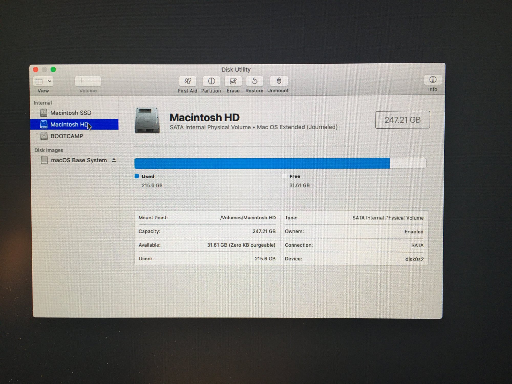

I have also tried another drives I have at hand. So when I put there my old drive from my MacBook Pro, it is registered by the system.

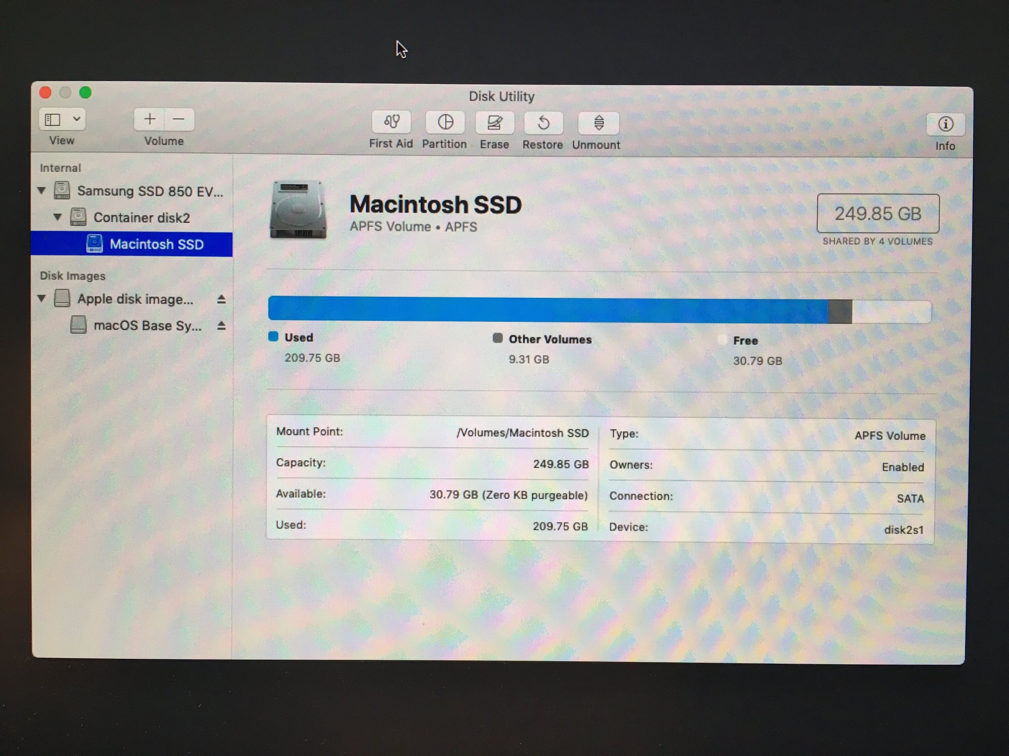

Then I put the new WD RED inside. No avail. Then I realized I have another WD RED (from year 2016) at hand, so I put it inside. Again, it was not recognized by OS.

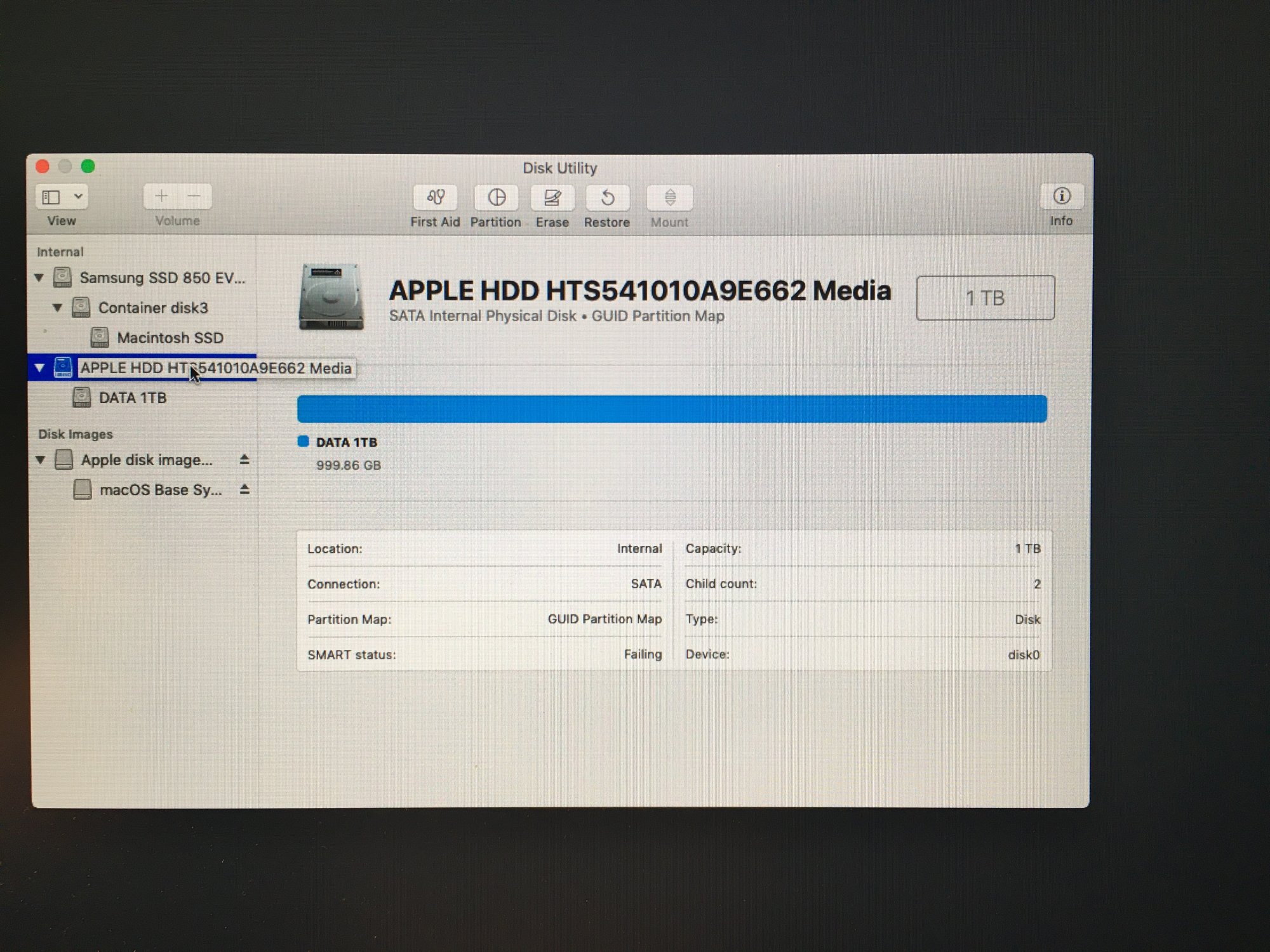

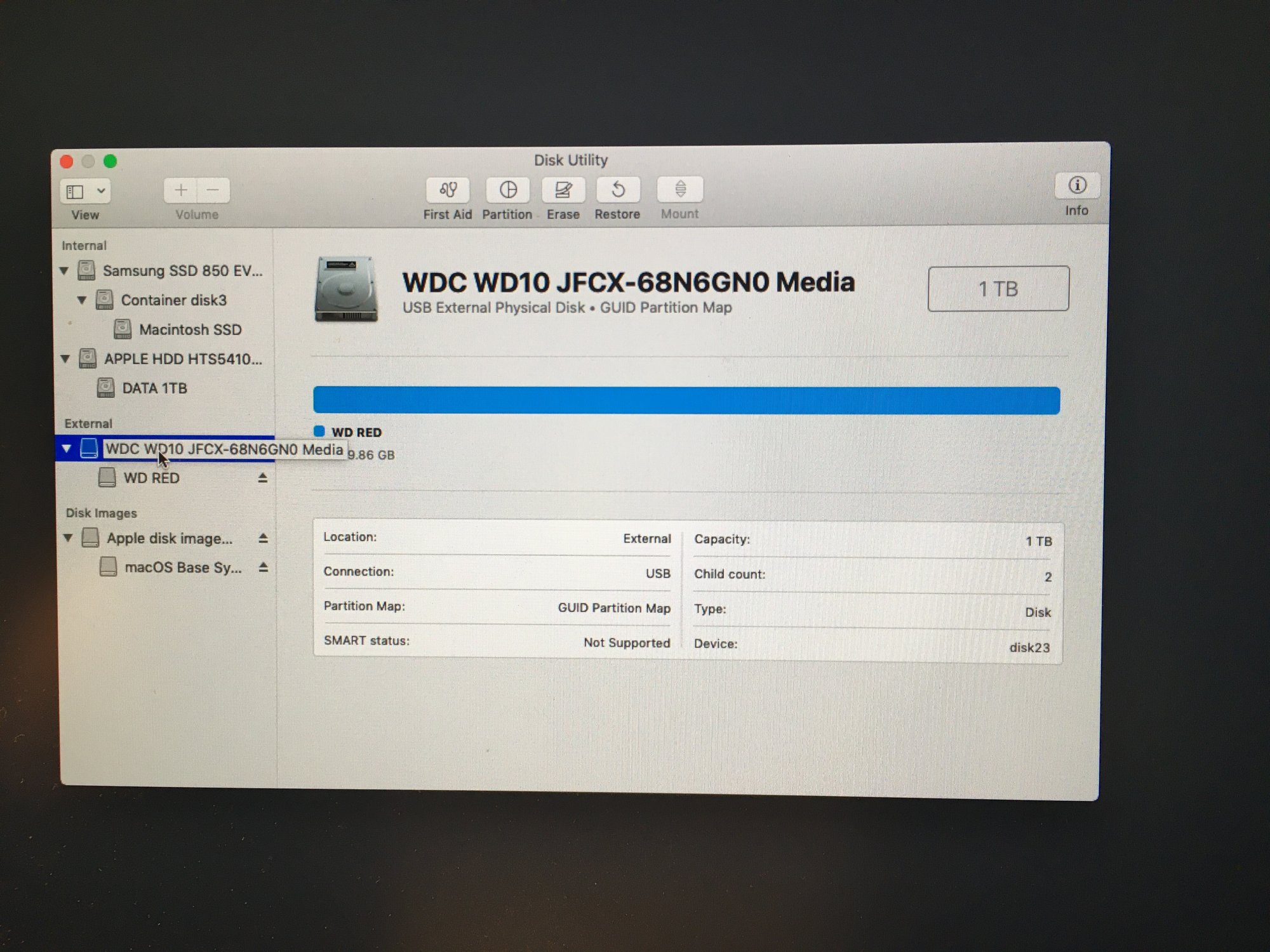

So I put my original HDD back and put my new WD RED to the USB enclosure, so you can see, what the Disk Utility says on them.

I can access the partition on USB. In fact I decided to use it as my Time Machine Disk.
