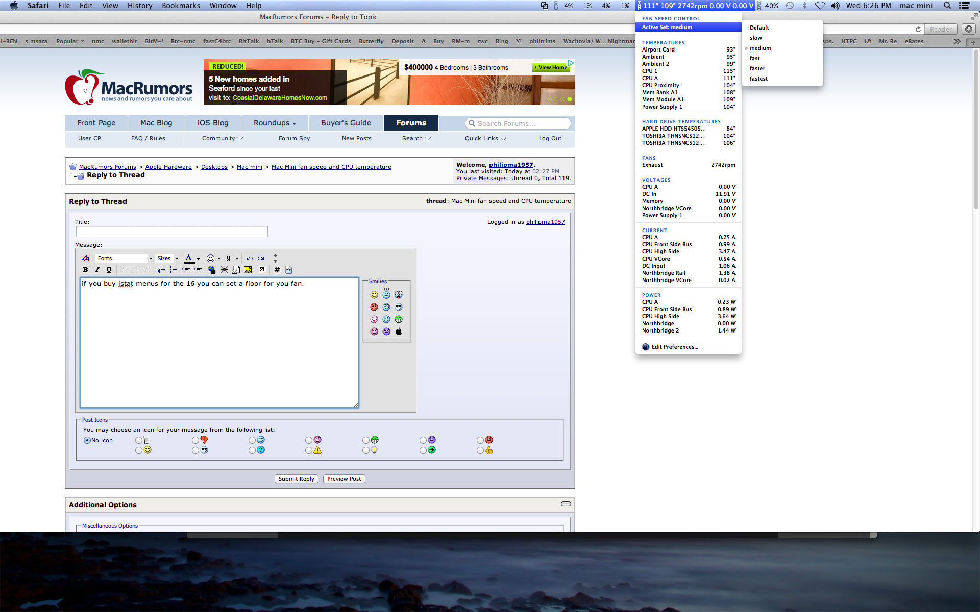

if you buy istat menus for the 16 you can set a floor for your fan.
i set a floor speed of 2700 at medium. my mini is not close to me so 2700 rpm can not be heard. if you are close to the mini you can set a floor of 2100 rpm.
