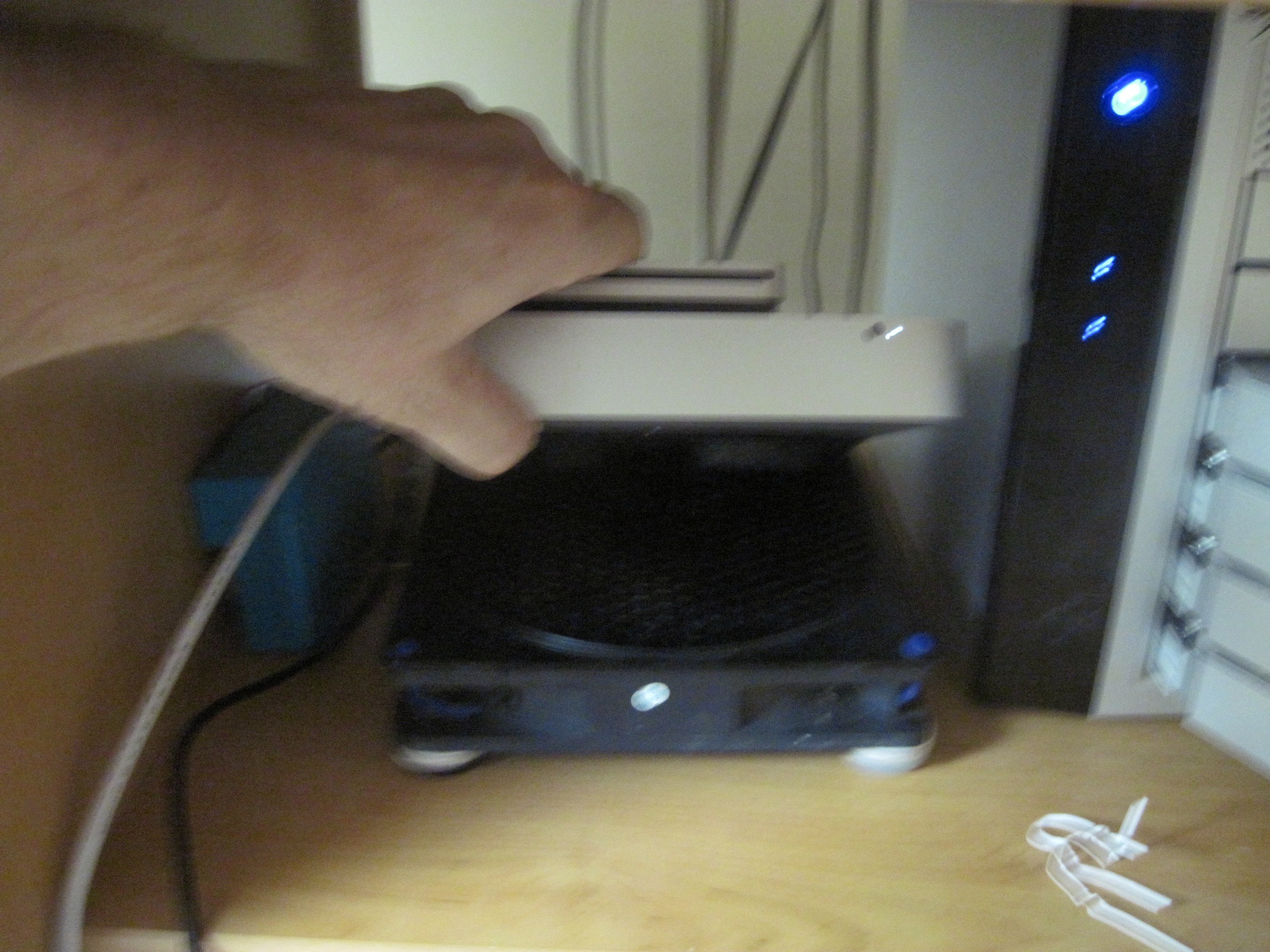

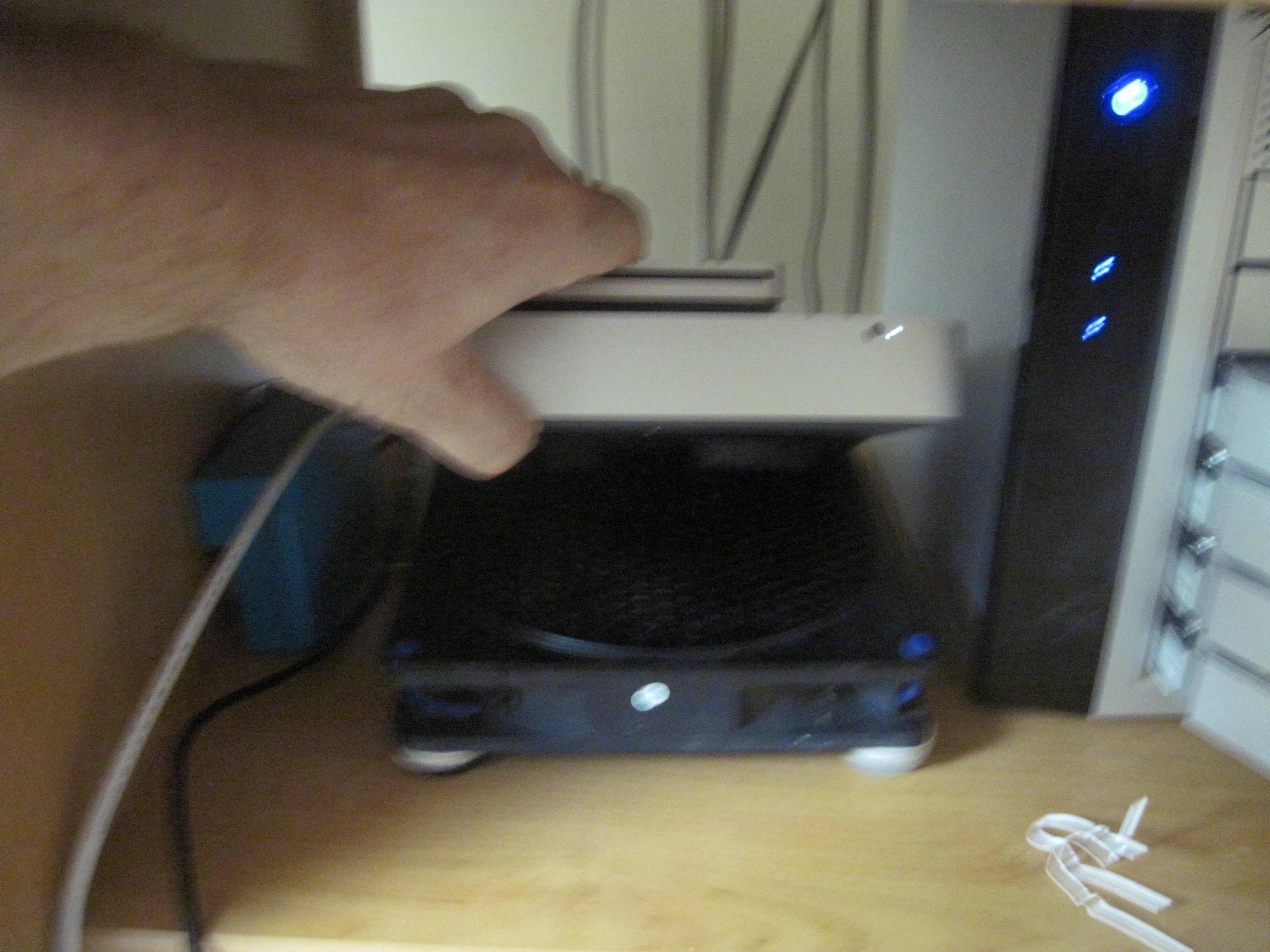

Thanks for the tip! Before at idle it was running at 60C. After elevating, it went down to 54-55C.
Finally I tried it on its side, and removed cover, it is already at 44C.
Its the new 2012 mid model, with a Vertex 4 512gb inside, which runs pretty hot! it is also in an open cabinet, with other machines. The room is at a constant 22-23 degress celsius.
It is worth trying these methods, as it looks like the factory cooling - altough it might be enough - is not very effective.....

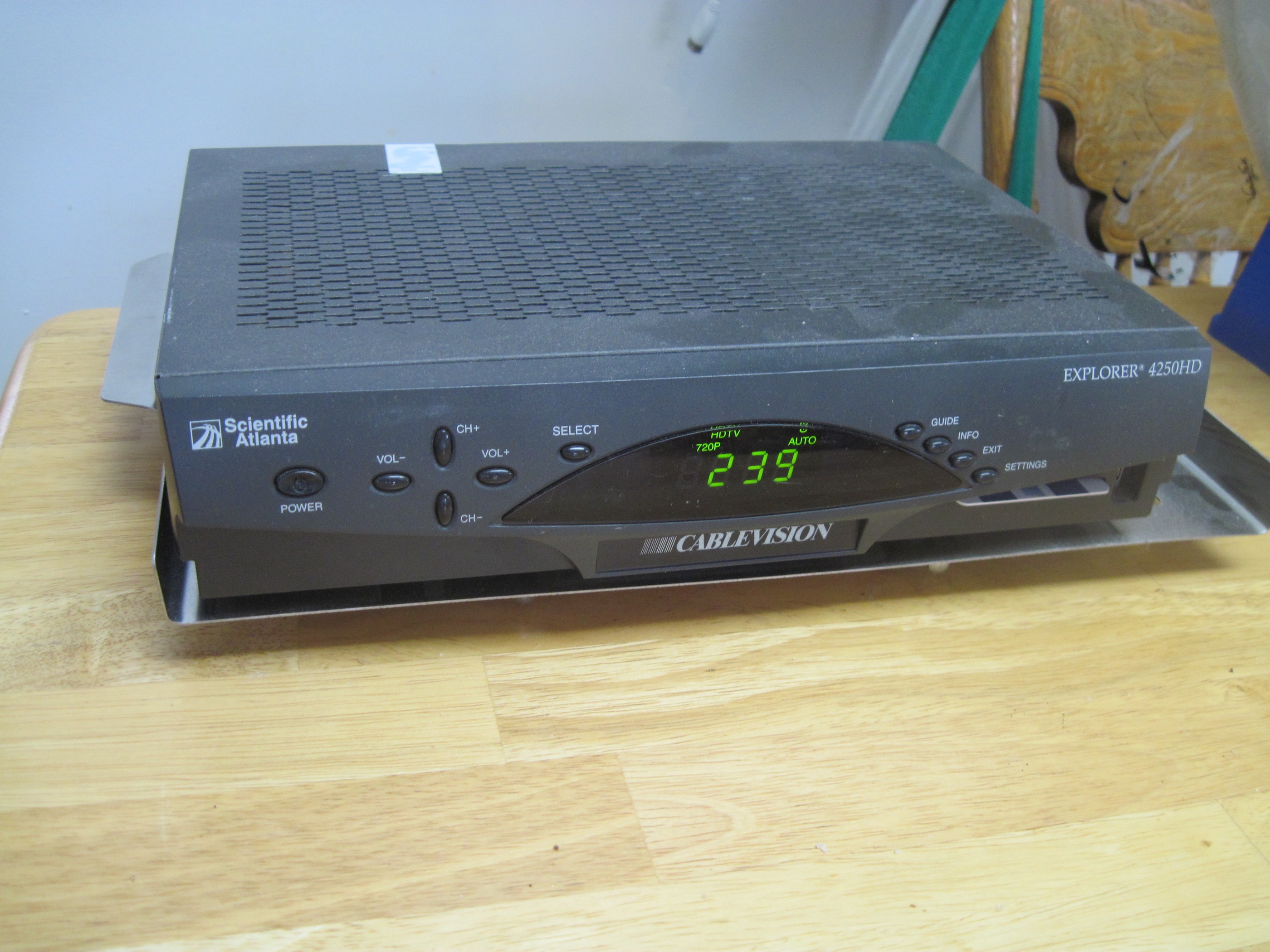

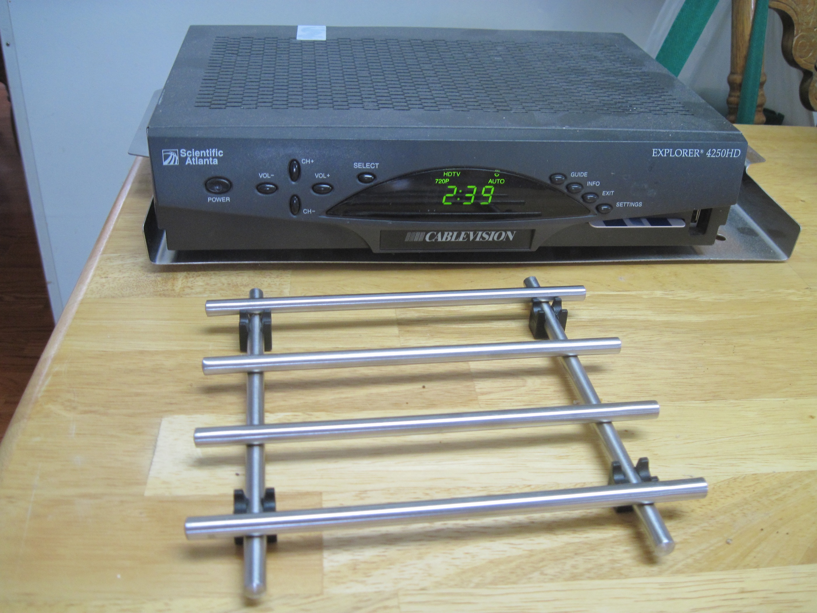

I am a little busy for really long temp tests. Here are a few temp cooling photos. will post soon.

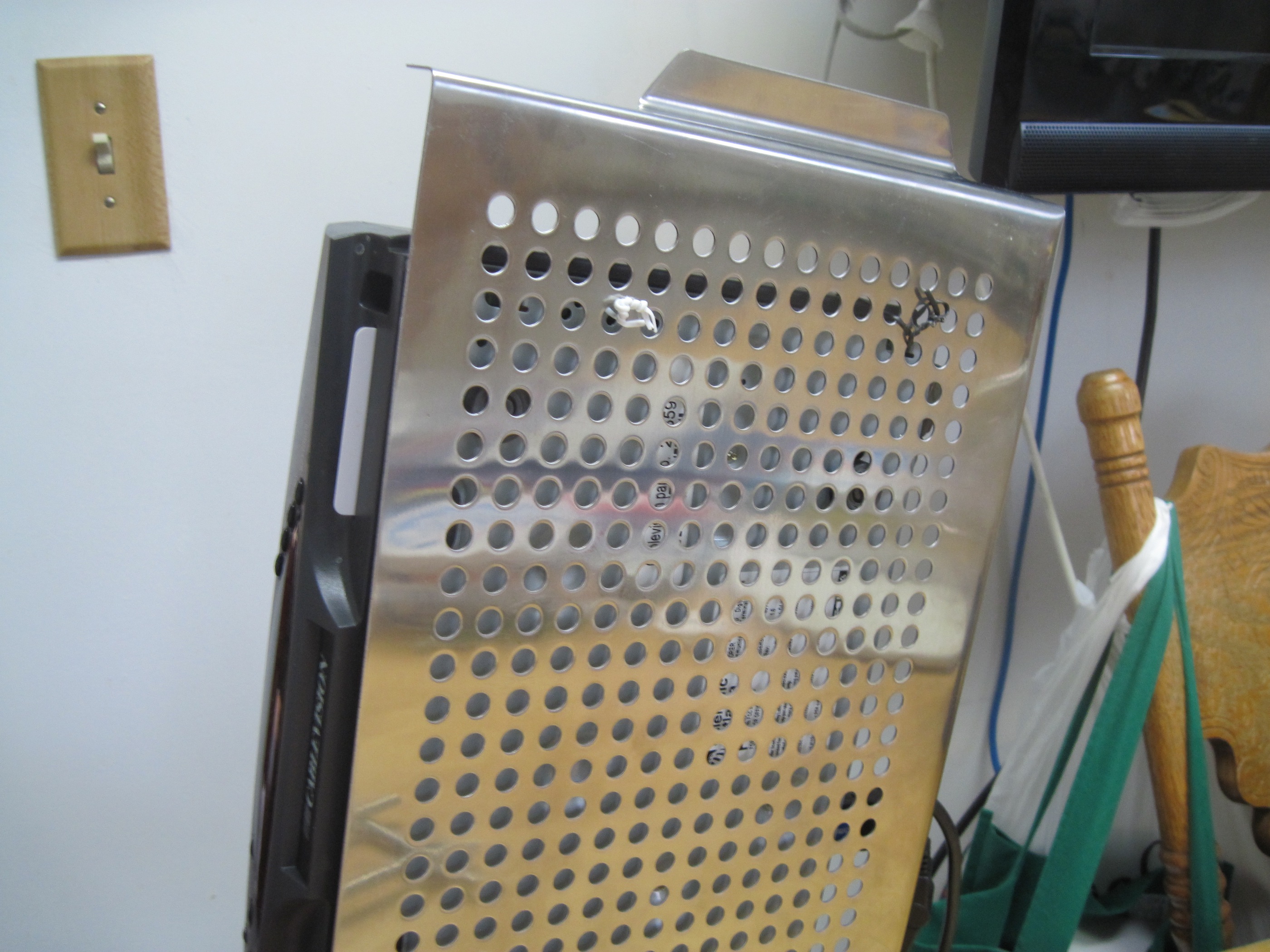

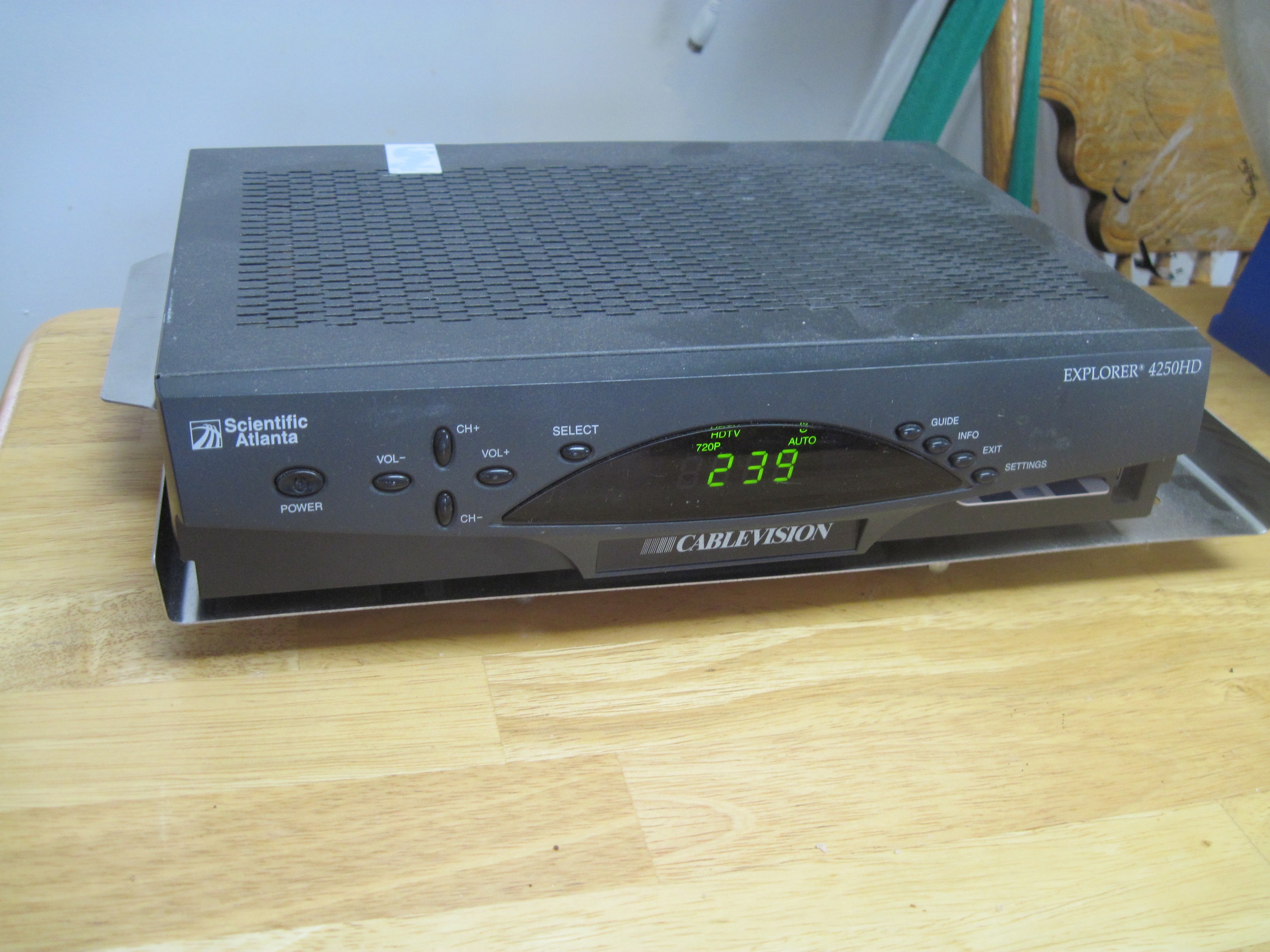

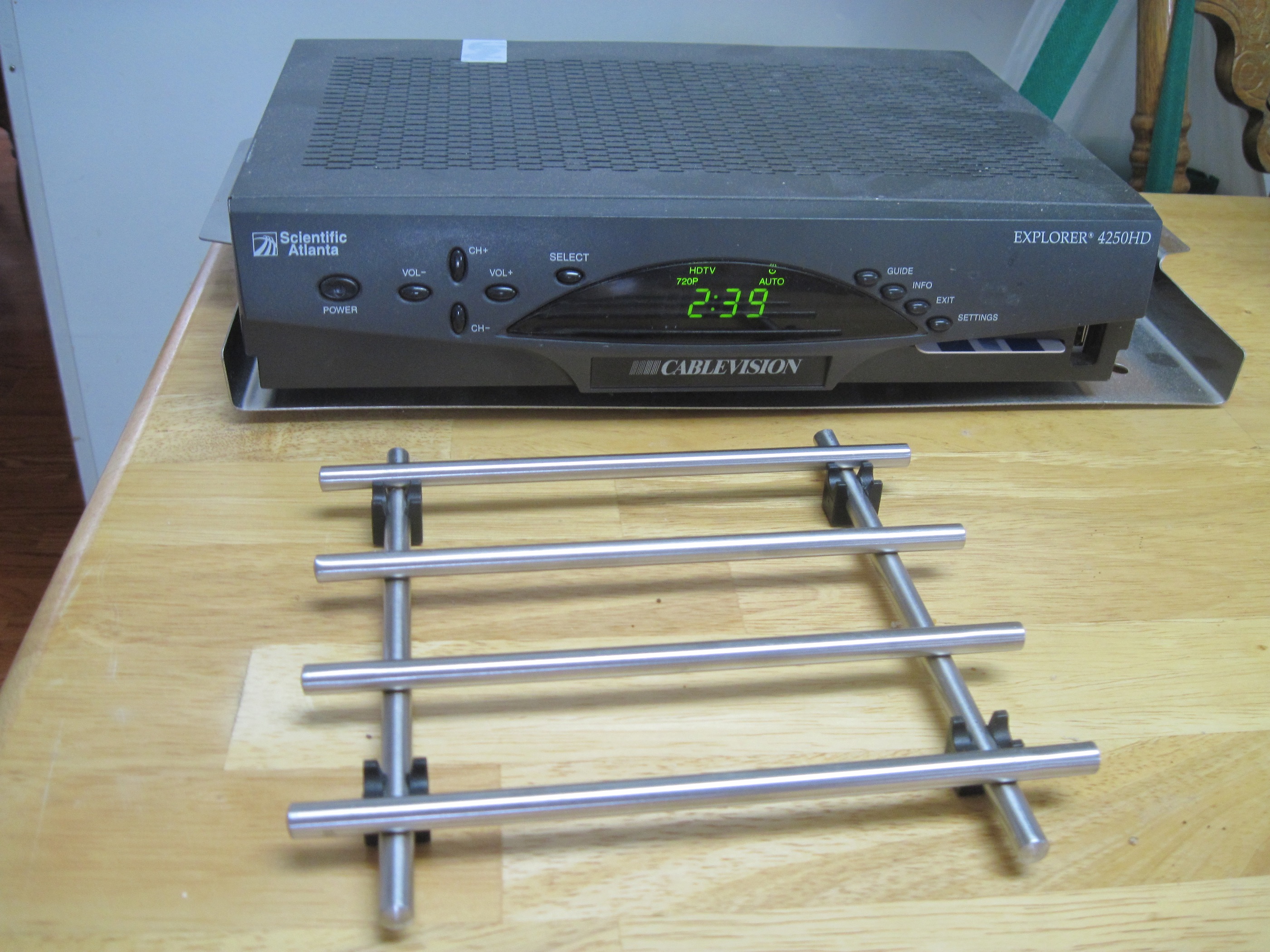

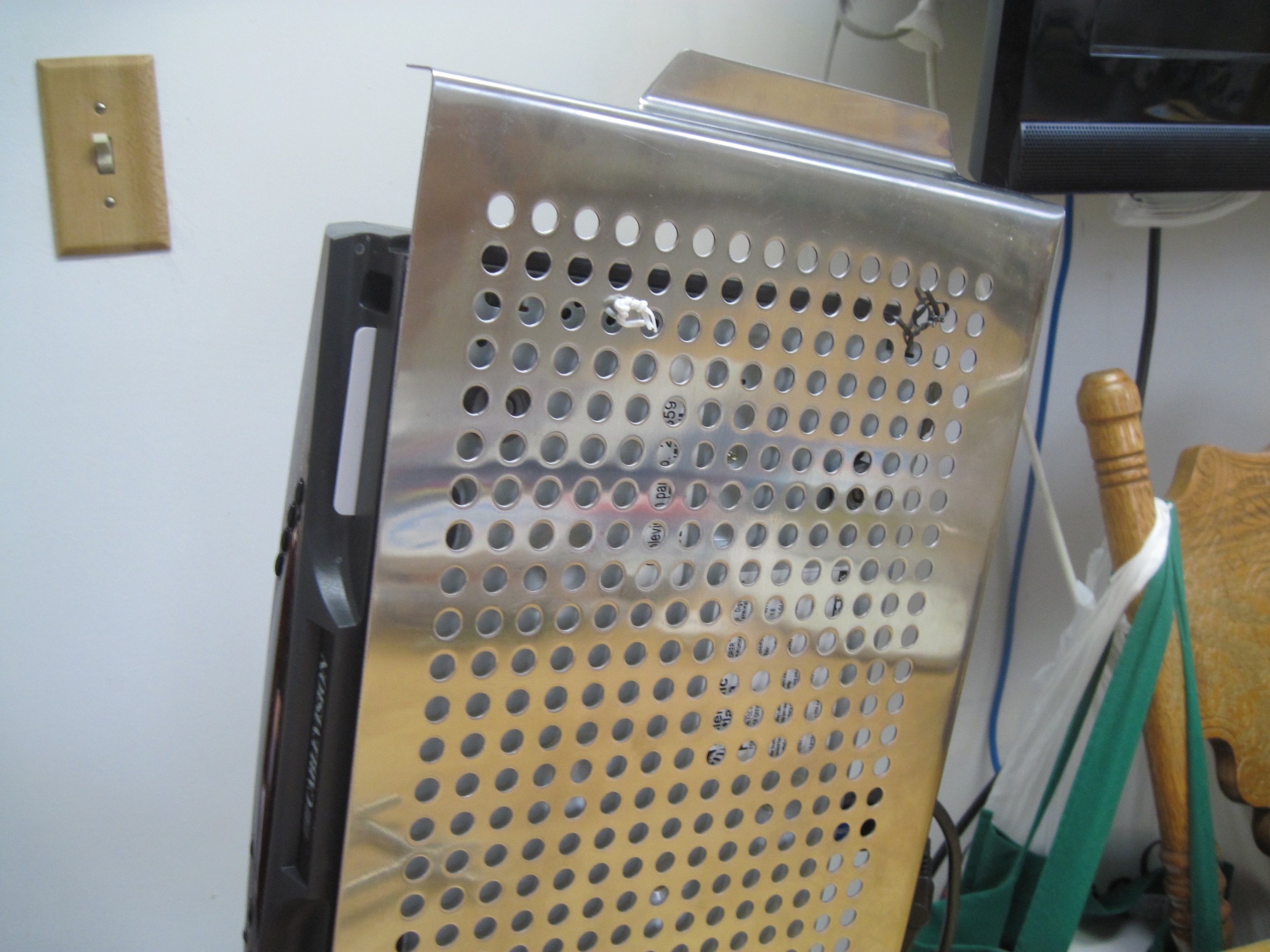

here is a passive cooling idea. I use it for my very hot cable box.
