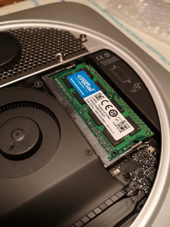

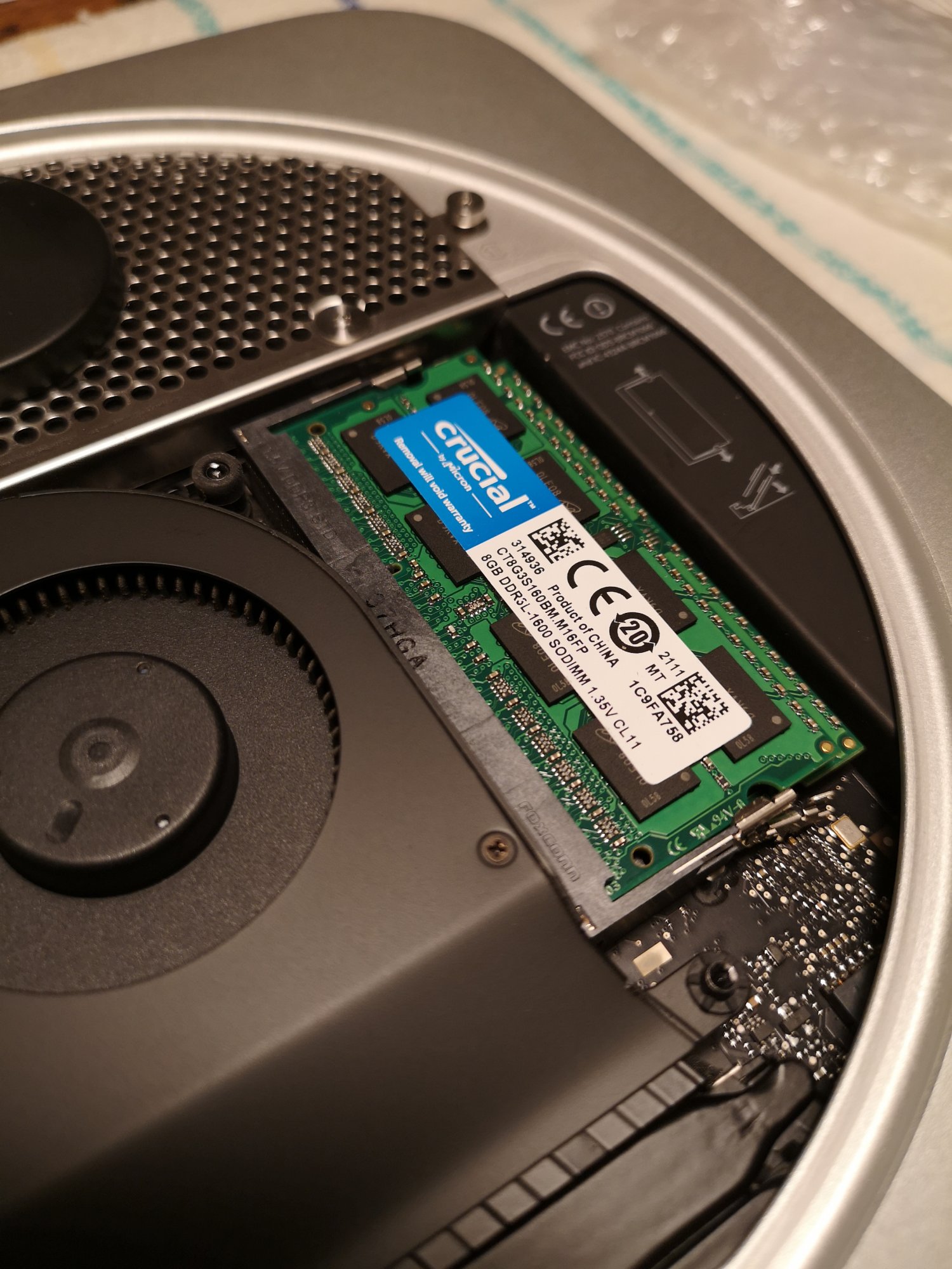

So well, I have removed the previous memory modules (2 x 2GB @1600MHz) and I have installed the new memory.

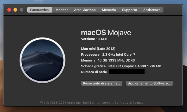

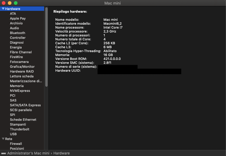

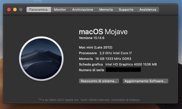

I have done the PRAM reset at the next restart and et voilà! 16 GB memory installed! But there was something wrong.

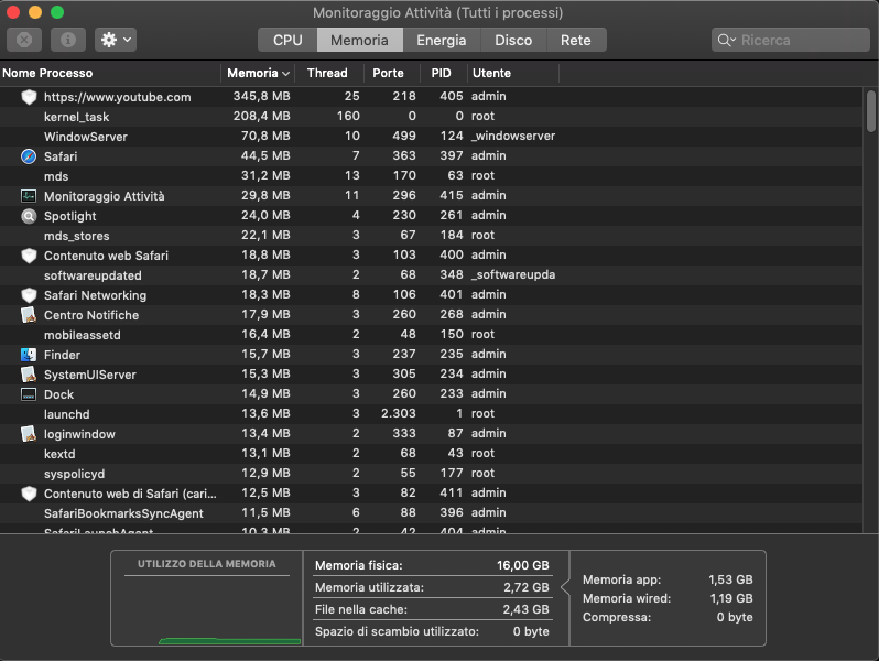

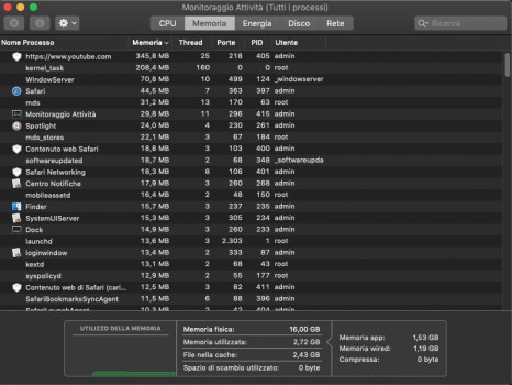

Machine runs more slowly through apps despite more memory and almost absent CPU load. So I have checked system information and here the issue. 16 GB memory loaded at 1333 MHz. How is it possible? Machine issue or Amazon has sent me a wrong item? The shipment from Amazon contains only two modules inside protection (no Crucial package).

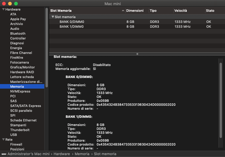

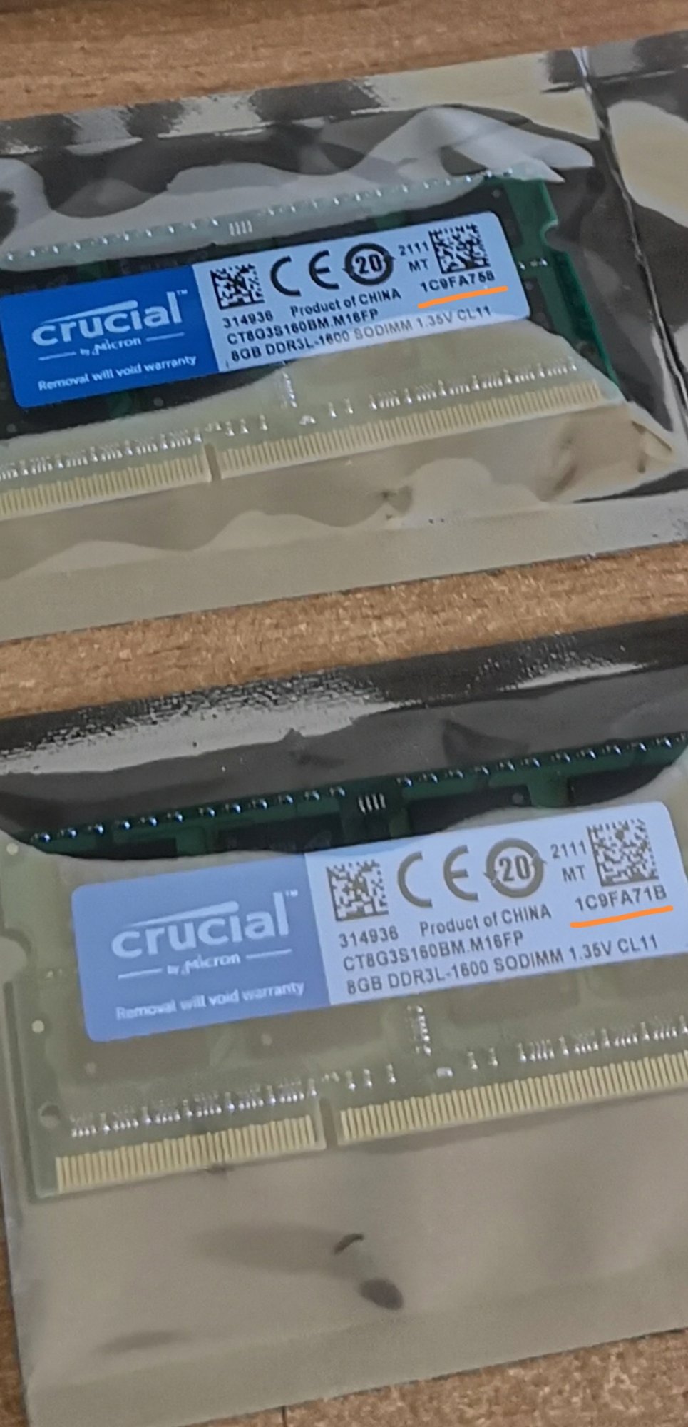

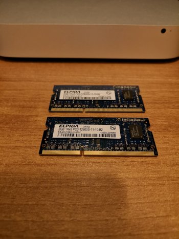

I have attached some screenshot and some photos about new Crucial Memory and previous memory.

Your computer is slow because you are using an 5400 rpm standard hard drive (HDD). Replace it with an SATA SSD and you will see and feel the difference.

Sure, I have to replace the storage with SSD but I don't know why the system recognizes 1333MHz instead 1600MHz for memory. Do you have any idea?
The XMP doesn't work normally on Mac computers and that means, that they can be very picky about RAMs.
The standard chips on RAM used in Macs are mostly from Hynix. But it doesn't really matter. What it does and I think this is the "problem" in your case is the RAM timings (not 100% sure, but it can be the case). Yes, Crucial writes it is CL11, but is seems, that your Mac is ignoring it.

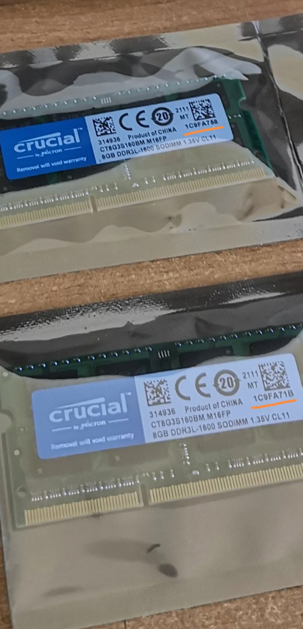

It can also happen, that whatever you do, this Crucial 16GB Kit CT2K8G3S160BM simply wont work @1600 MHz in you Mac mini.

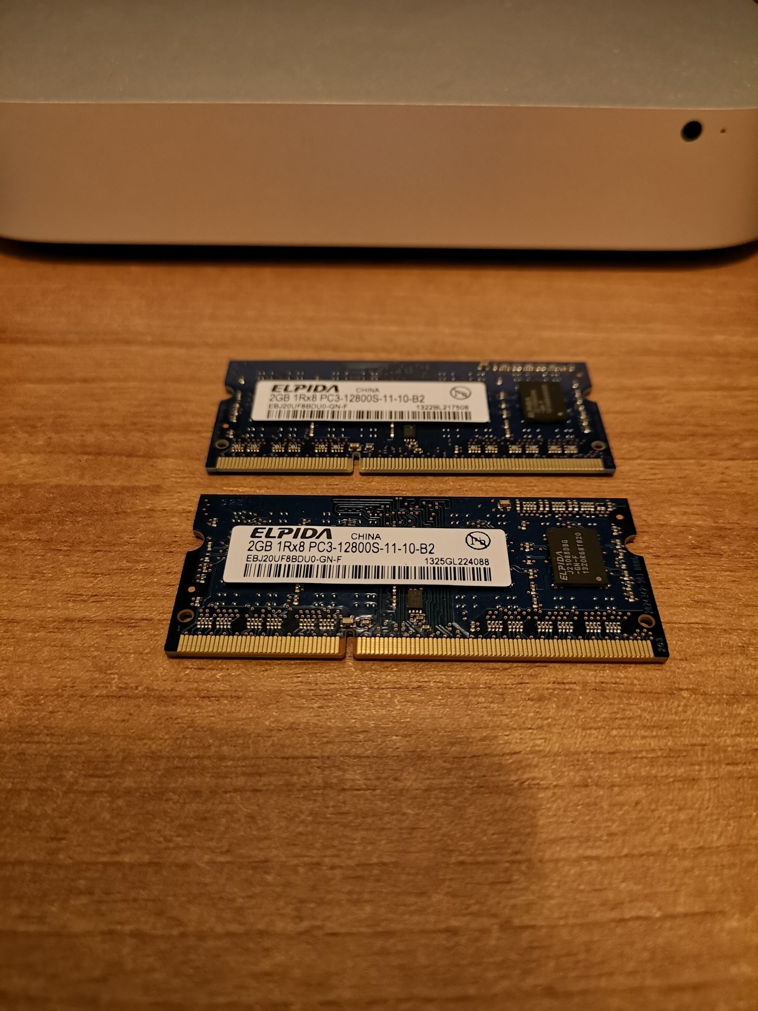

I will try to remove Crucial memory and to reinstall Elpida memory (in fact the 2x2 GB is recognized at 1600 MHz).
Maybe when I removed the memory the machine has set the frequency lower.

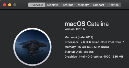

I have a late 2012 mini running 16 GB 1600 MHz RAM without issue. I suspect the RAM you purchased has sloppy timings so the mini can't run it at the full 1600 speed. Try another set of RAM.
FWIW, my 2012 Mini also shows 1600 Mhz. I bought it used from OWC about 6 years ago, don't know if it is the original RAM or an upgrade that they did. It has been a great machine, used it to edit audio/video for a number of years but now it's just a file server.

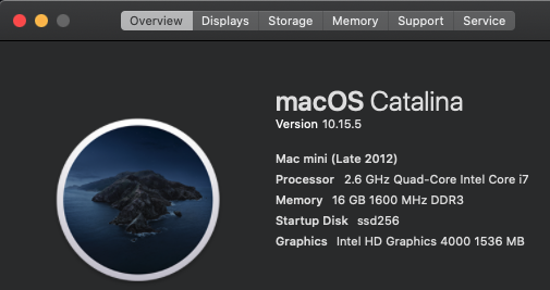

I have reinstalled the Crucial memory but even now the machine set at 1333MHz.
Before I have reinstalled the Elpida memory and the machine set at 1600MHz.

FWIW, my 2012 Mini also show 1600 Mhz. I bought it used from OWC about 6 years ago, don't know if it is the original RAM or an upgrade that they did. It has been a great machine, used it to edit audio/video for a number of years but now it's just a file server.

From the pics, your RAM modules don't show serial numbers. They should.
That said, one of my RAM sticks in my PPC Mac is counterfeit. It has been working fine for nearly twenty years now. But the bad thing is I got scammed by paying full price for it.

Can you try to boot the mini with just one module to see how it works? And then power it off and switch to the other module?
You said the modules came with no package from Crucial. Does the other module have the exact same reference numbers on the label?

Yeah I have tried to boot the mini with just one module and the frequency is always 1333MHz. Same for power off and switch, also tried PRAM reset every time. Every Crucial module has the same reference number.
Sincerely I don't know how this is possible. I have read that sometimes users who ask refund switch the label on the memory and send back their old memory instead the new. Basically a scam.

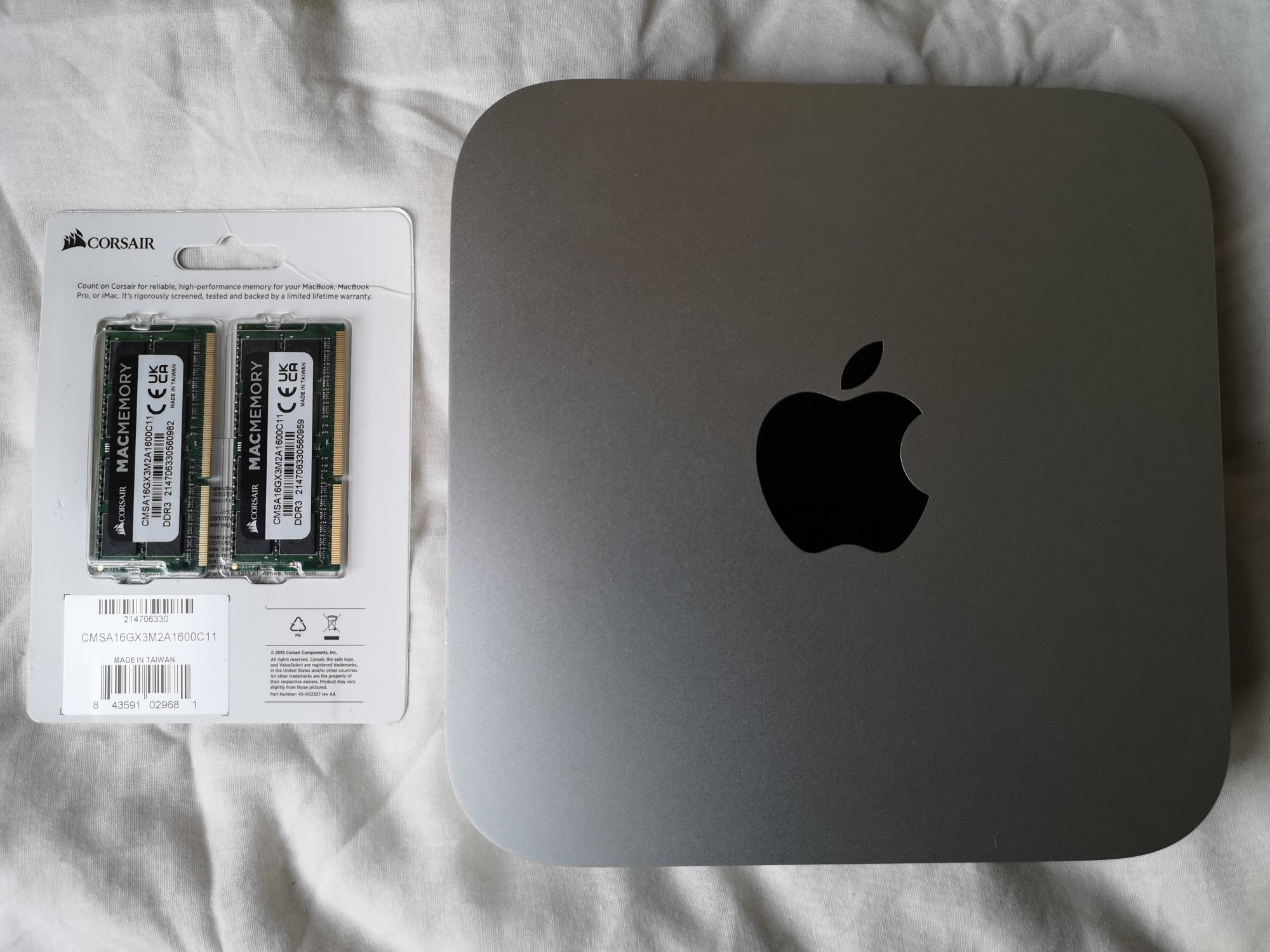

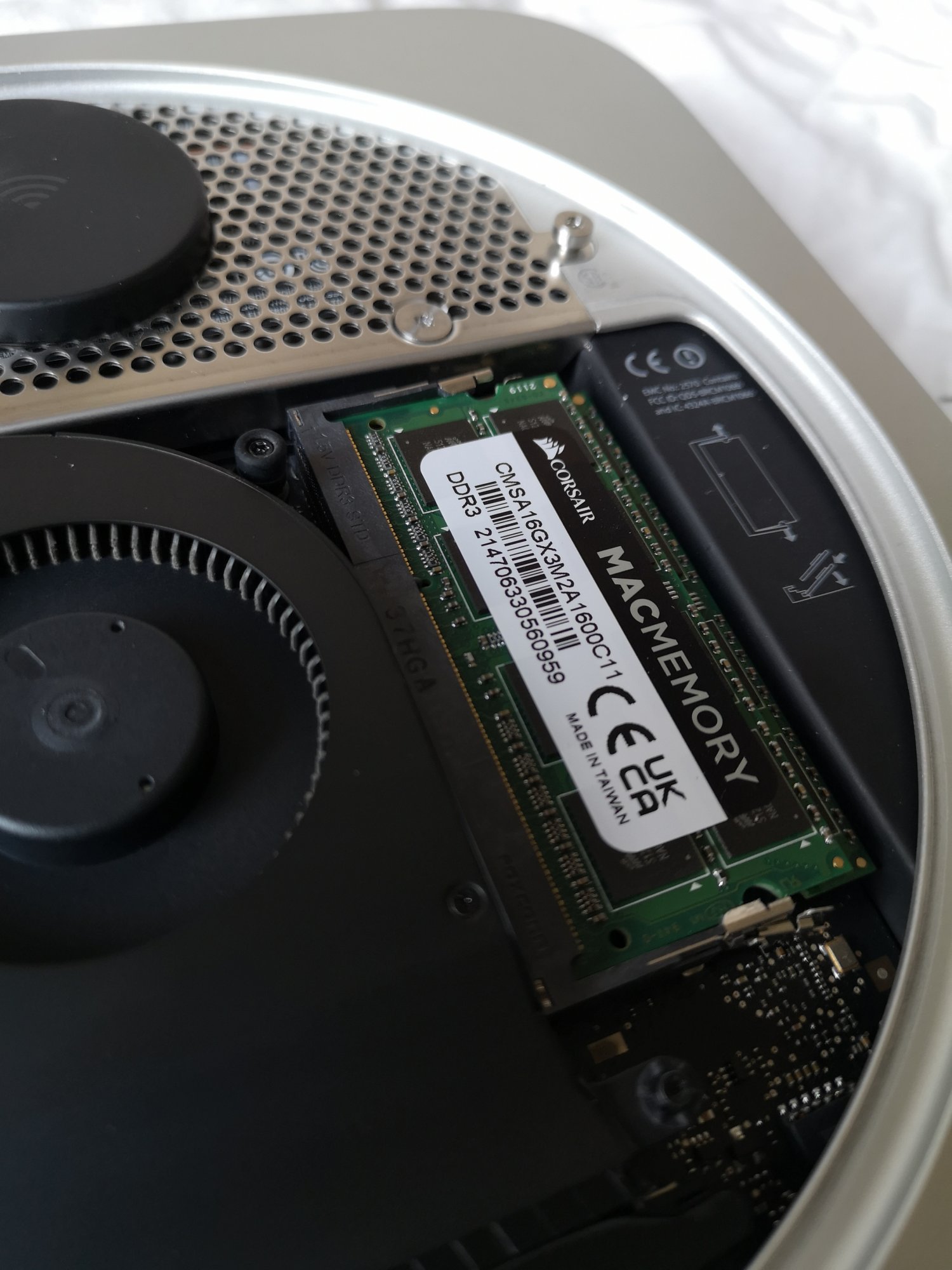

I have bought the Corsair memory for Mac.
Here the link https://www.amazon.it/Corsair-CMSA16GX3M2A1600C11-Memoria-Certified-SODIMM/dp/B009EH010E
The packaging is perfect and the specs are the same required for Mac Mini late 2012 (the same of previous Crucial memory).

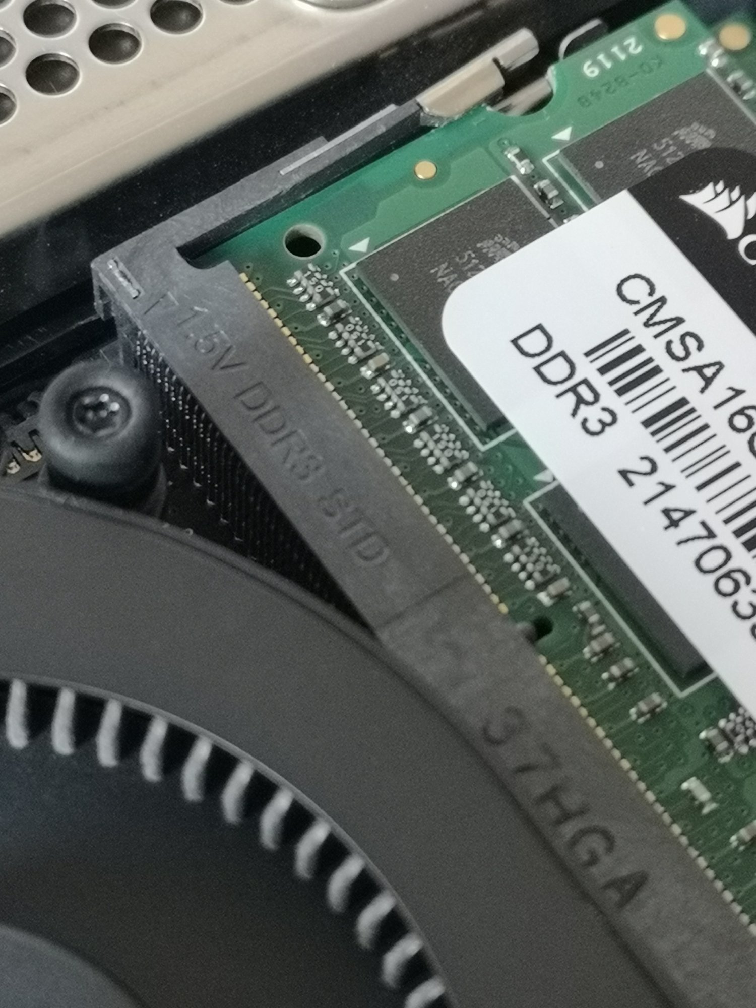

I have installed the memory but even this time Mac has started with the three beeps.
I have tried PRAM reset. Nothing. The three beeps remained.
I have tried two different brands (Crucial and Corsair) and Mac Mini doesn't recognize them. The memory specs are correct.
Is it possible that issue can be the Mac?
@opeter @uller6 @Boyd01 @for this @Kamolas

Yes, it can happen, that the problem related to your computer. Maybe the memory slot is dusty or in the worst case: damaged?
Do you still have the original RAM (2x2 GB)? Does it work with that?
Try to remove the new memory and install the old modules. Check if these work at 1600 MHz.
Also you can try to use a single module, just for testing purpose. Insert one single original 2 GB module or one (new) 8 GB module in the lower slot and try to turn on your computer to check, what it says. If it will start, of course.

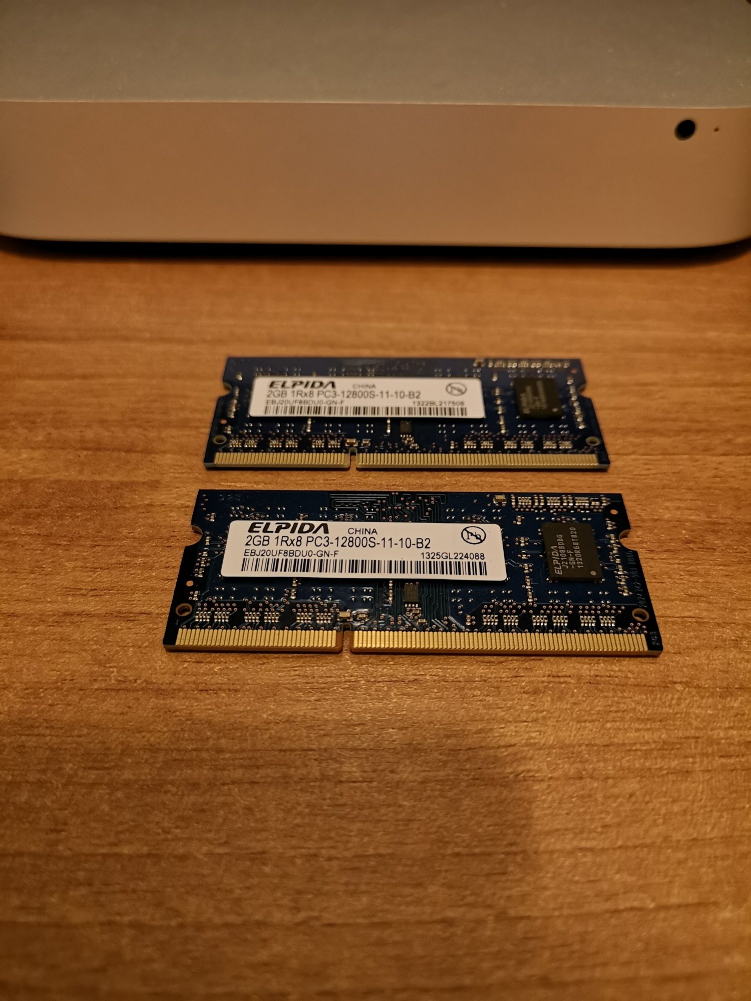

I have reinstalled the original 2x2 GB memory and it works.
Corsair single module doesn't work (three beeps).
I have noticed a particular, maybe irrelevant: memory schedules (Crucial, Corsair) work at 1.35 V, Mac Mini slots work at 1.5 V (see the attachment).
Can be this the issue?
