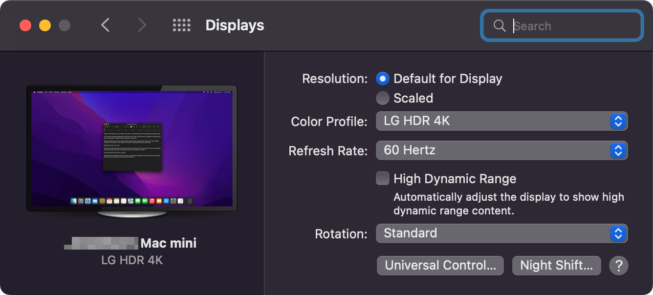

Very interesting. I also have a 27" LG monitor (UHD) but it's 60Hz. But I'll check out the display settings tomorrow and see what it's actually set to.
Reactions: polaris20
Just checked and mine is indeed set to 60Hz, so at least for me I don't think the refresh rate is the issue. The only other settings are lower rates. Perhaps it's something else about the LG displays that's causing the issue.
