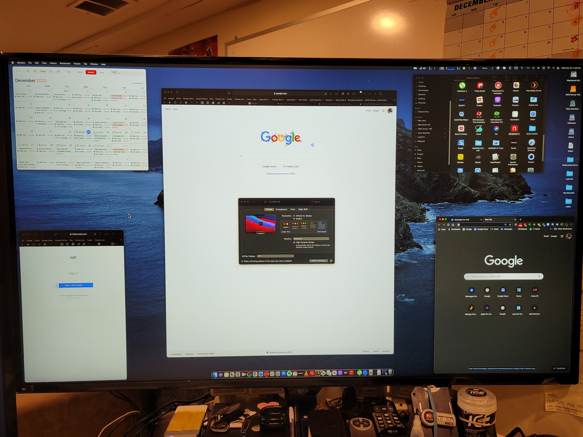

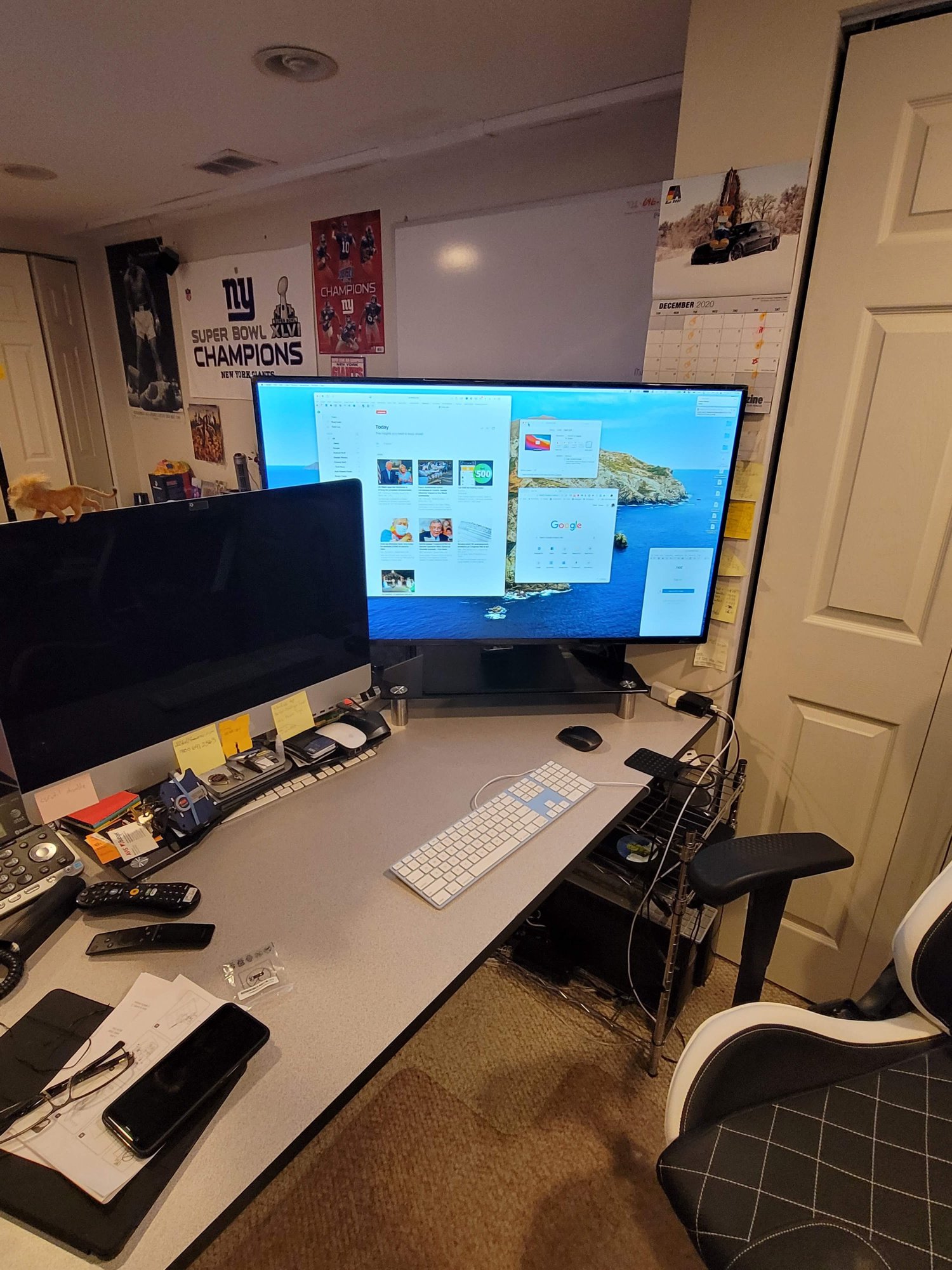

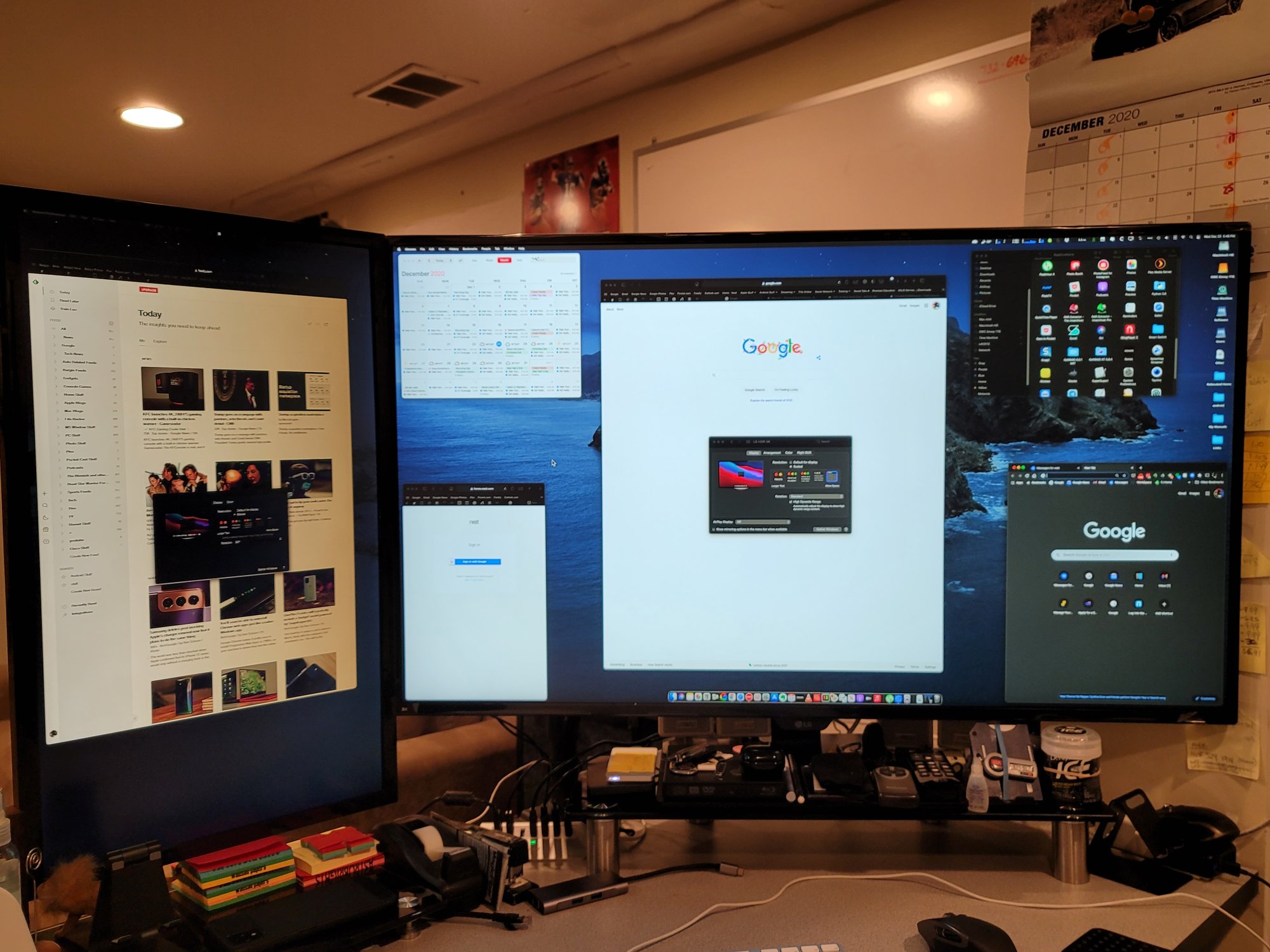

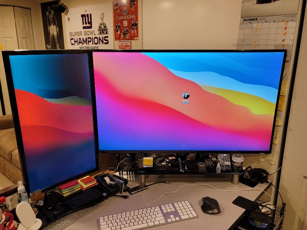

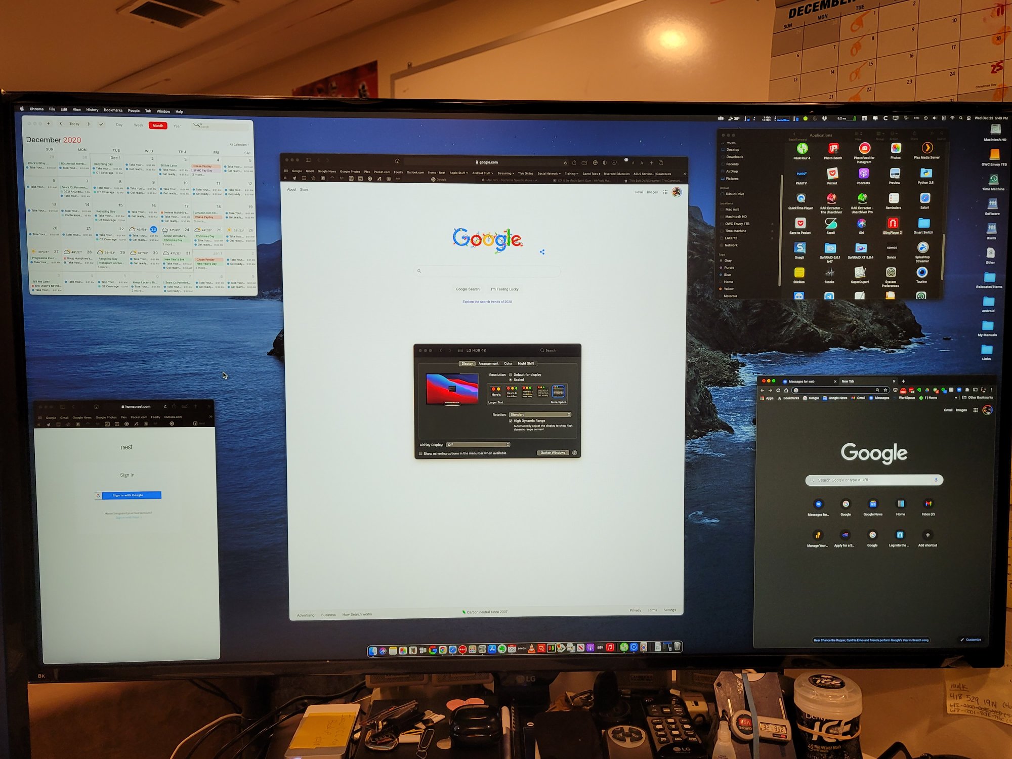

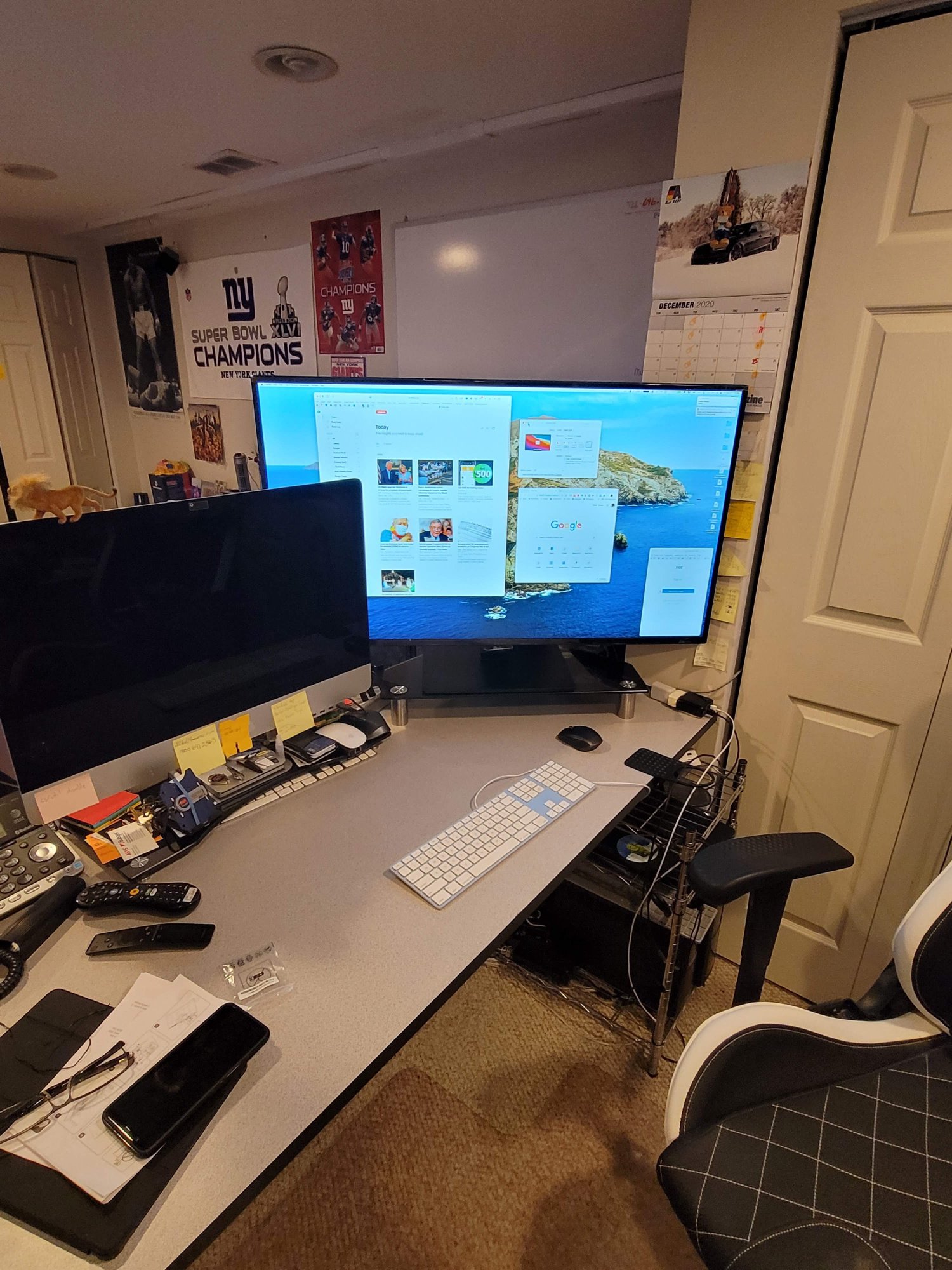

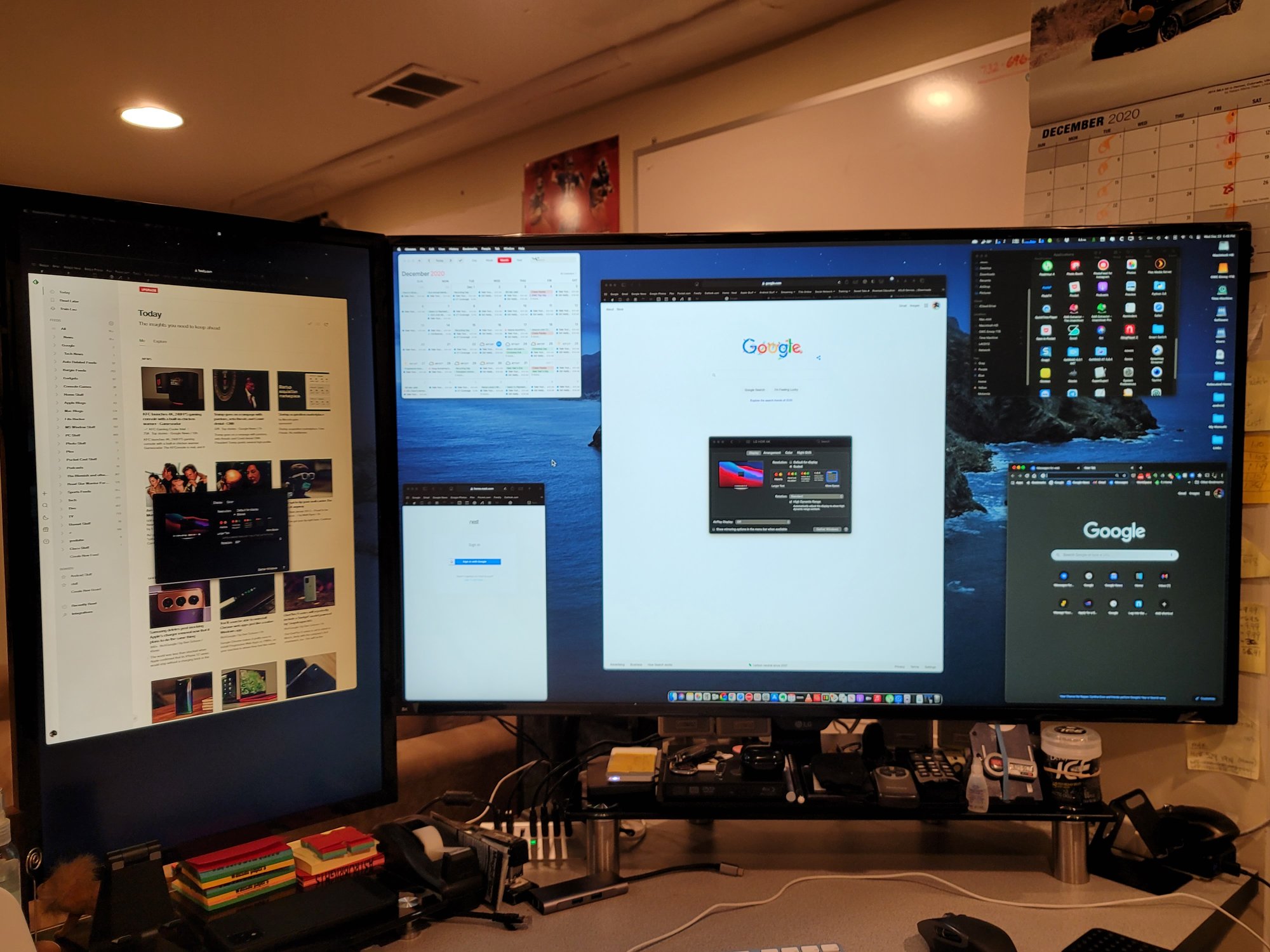

Just finished setting up my m1 Mac mini with the LG 43UN700.
it is a very big monitor but works. 0C243116-5BFB-4918-A06A-8A3978E48D0E.jpeg
