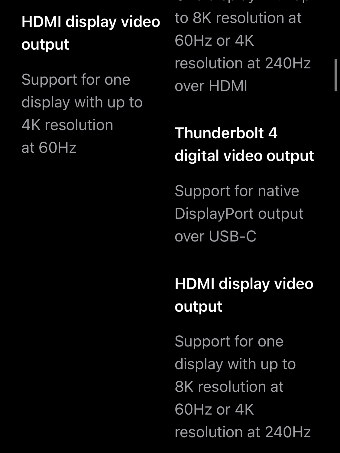

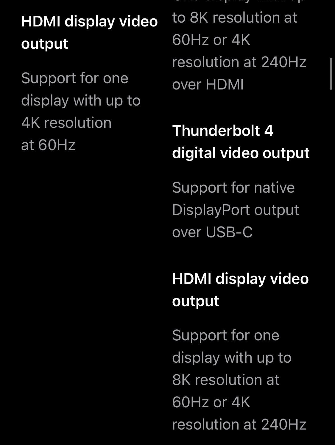

I mean it's spelled out on the tech specs page left is M2 and right is M2 Pro
