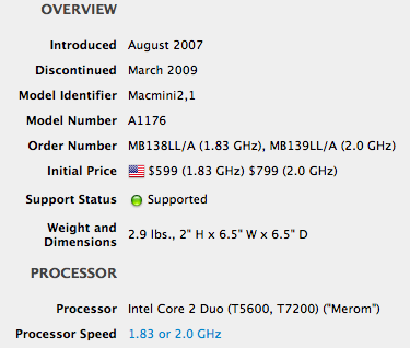

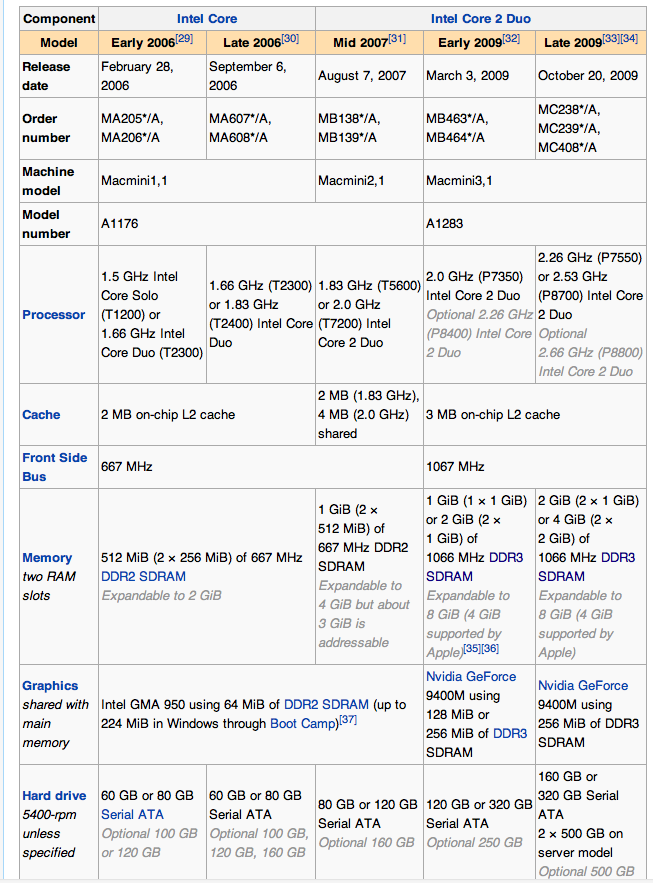

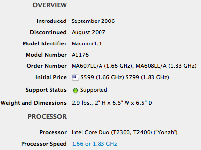

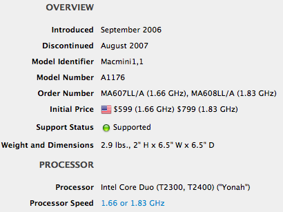

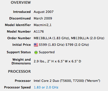

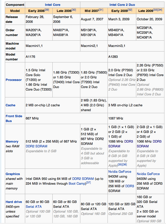

Two sources indicating Core 2 Duo in Mid 2007. Mactracker and Wikipedia

Once again - not true......my 2007 Mini is a CORE DUO 1.83 GHz
No. Your late 2006 is a Core Duo. You may have bought it in 2007, but as of August 6, 2007 (mid-2007) all were converted to Core 2 Duo's. Seriously.... You have an MA608LL/A which ran from September 2006 until August 2007 if you have a 1.83ghz Core Duo. As of August 6, 2007, they released an updated version MB138LL/A which has a 1.83ghz Core2duo.
Seriously direct from apple:
Late-2006 http://support.apple.com/kb/SP29
Mid-2007 http://support.apple.com/kb/SP7
Can we please put this to bed now that we have proven what you have? My statement that 2007 Mac Mini's holds true as the above model (Mid-2007) is the "only" 2007 Mac Mini models.
