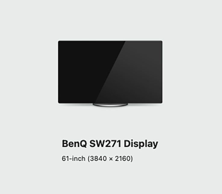

RobArtLyn
macrumors 6502
Sep 17, 2020
252
281
I have a 2014 Mac Mini running 11.2.3 connected to a 27" 4K BenQ SW 271 by HDMI. The Mac registers the BenQ as a 61" monitor instead of 27" at the correct resolution of 3840x2160, which causes the text to be too small. I have temporarily worked around this by scaling the output to 2560x1440. The problem also happens when connected by DisplayPort. So far, both Apple and BenQ technical support have been useless.
Has anyone else experienced this sort of problem? Found a solution?
My guess is that the Mini is "seeing" the display, NOT as "a display", but rather "as a tv".
Having said that, it's not the "size" of the display that matters, but the resolution.
3840x2160 is the correct (native) resolution for a 4k display in actual 4k mode. And yes, if you run it this way, the onscreen display will likely be "too small" to actually be useful.
For a 27" 4k display, the "proper" (most common) Mac setting is to run it in "HiDPI" mode -- i.e., "retina" mode ("pixel doubling").
That will yield a "perceived" image that is 1920x1080, or "looks like 1080p".

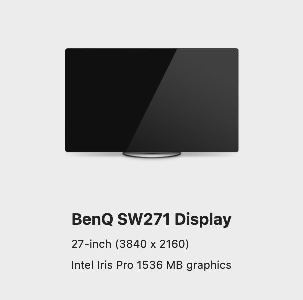

Actually, the recognized physical size does matter. I am also using this display with a Mid 2015 MacBook Pro. It correctly reads the display as a 27" monitor at 3840x2160 and everything is appropriately sized when the preference is set to "Default for display". Scaling not needed.
There is no need to hold down the option key when selecting "Scaled". There are seven different options including both 1920x1080 and 1080p. I have no idea why I would want to pay $1K for a color managed 4K display to only run it at that resolution. Running at as a 2K display is barely acceptable.
I am aware of the "TV" problem, but everything that I have read associates it only with HDMI. The problem persists when I use DisplayPort.
It's either a Mac Mini problem or a Big Sur problem.

I know how to count pixels. I am also not delusional enough to think that a software setting changes the physical size of anything.
Same monitor. Two computers. One has it right. One has it wrong. Guess which computer exhibits expected UI element size and behavior.

If the difference were that the display was, say a 24", and was being reported as 27", then yes, you would be correct. In this case, however, the system does not handle the 2 sizes the same way.
I want to see pics that prove what the OP is saying.

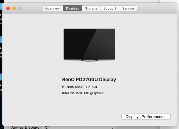

Everything works fine, but I do see what he is talking about.
I'm using a 2014 Mac Mini version 10.14.6 (Mojave) on a BenQ PD2700U monitor.

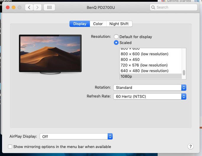

I have to use 1080P to get the screen to look normal.
If I pick 3840 x 2160 it will make everything small and hard to read.
I also see the same thing he is seeing, the Mac Mini shows that this is a 61" TV.
