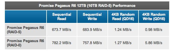

The Pegasus sequential write performance in RAID 5 is not a slouch though.
Source: Anandtech
http://www.anandtech.com/show/4489/promise-pegasus-r6-mac-thunderbolt-review/6

Thanks for the detailed explanation.
Those figures look spectacularly fast.
My references are my old G5 (late 2005) which I use as a photo workstation, and my new Macbook Air (Toshiba SSD).
The Air saves a large Photoshop file 3x faster than the G5.
Looking at those figures, it seems that the Promise Pegasus will save the same file 3x faster than the Air.
That would be fantastic! I sometimes work with very large files (multi layered 16bit PSDs, from 4"x5" film scans, or stitched from multiple digital frames). These files can take 3 minutes to save on my G5. 1 minute on the Air. And maybe just 20 seconds with the Pegasus (?)
One thing I don't understand in those Anandtech figures - '4kb random write' - what does that mean, and how does it manifest itself? That seems to be the area where RAID 0 significantly outperforms RAID 5.
