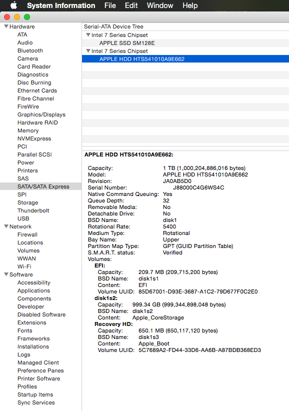

I have a 2012 Mac Mini server. I have OSX on the boot drive, and Windows 8 on the second drive via Bootcamp. I want to replace the second drive with an SSD. How can I tell which drive is the Windows drive when I open up the case?
Use System Information to determine which drive is which before you open the case. In this example, "Bay Name" describes the location of the HDD component of my Fusion Drive. :apple:
