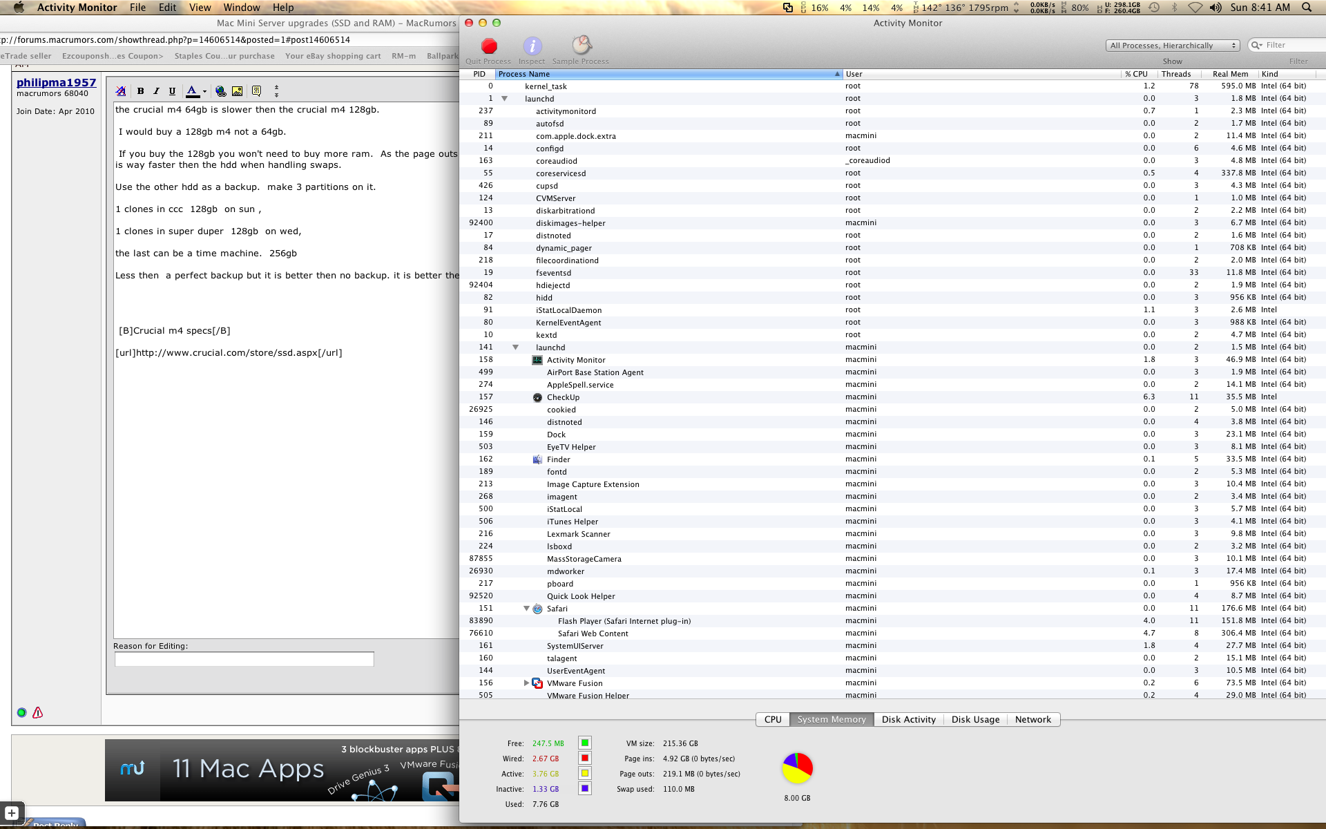

the crucial m4 64gb is slower then the crucial m4 128gb.
I would buy a 128gb m4 not a 64gb.
If you buy the 128gb you won't need to buy more ram. As the page outs and swaps (due to to little ram) will go to the ssd the ssd is way faster then the hdd when handling swaps.
Use the other hdd as a backup. make 3 partitions on it.
1 clones in ccc 128gb on sun ,
1 clones in super duper 128gb on wed,
the last can be a time machine. 256gb
Less then a perfect backup but it is better then no backup. it is better then a mirror raid.
Crucial m4 specs
http://www.crucial.com/store/ssd.aspx
note my ram use below. When I run out my swaps go to an ssd. i don't go to an hdd so time loss is small to none.
Also I don't run out much 4 gb in and 100mb out
