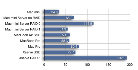

What's the point of RAID 0 if it's only a software RAID because the Mini has no hardware based RAID controller?
here is a link I found, note: these are numbers from the 2009 model, but you get the idea, also, considering the regular mac mini is 5400rpm and the server is dual 7200s with a 300 dolllar difference, and other upgraded specs it was a no brainer for me.
full link here:
http://mac-fusion.com/401/mac_mini_server_raid_0_vs_raid_1_vs_other_macs/
