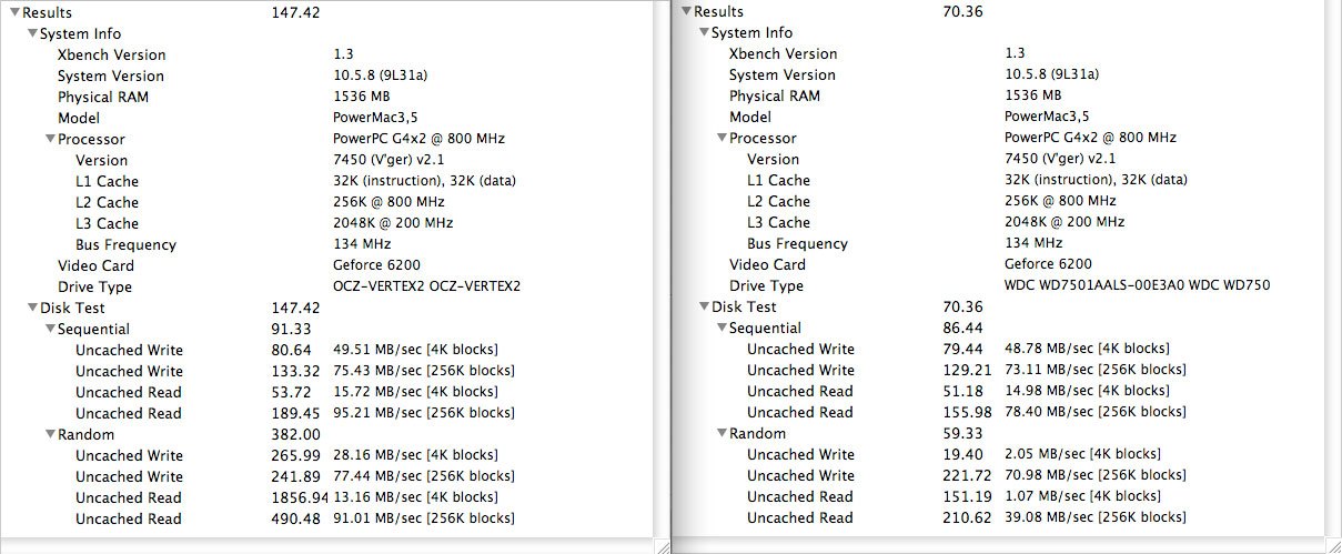

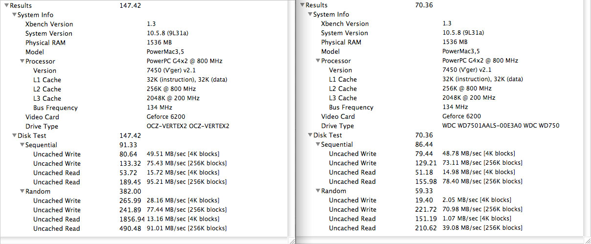

I ran some benchmark with Xbench when I got the SSD last year for comparison. They speak for themselves.
[EDIT] several sources online, this...
https://forums.macrumors.com/threads/1186048/
...particularly show that Firewire 800 is limited to 70Mb/s so I see your point with those numbers but at the same time, sustained throughput is irrelevant.

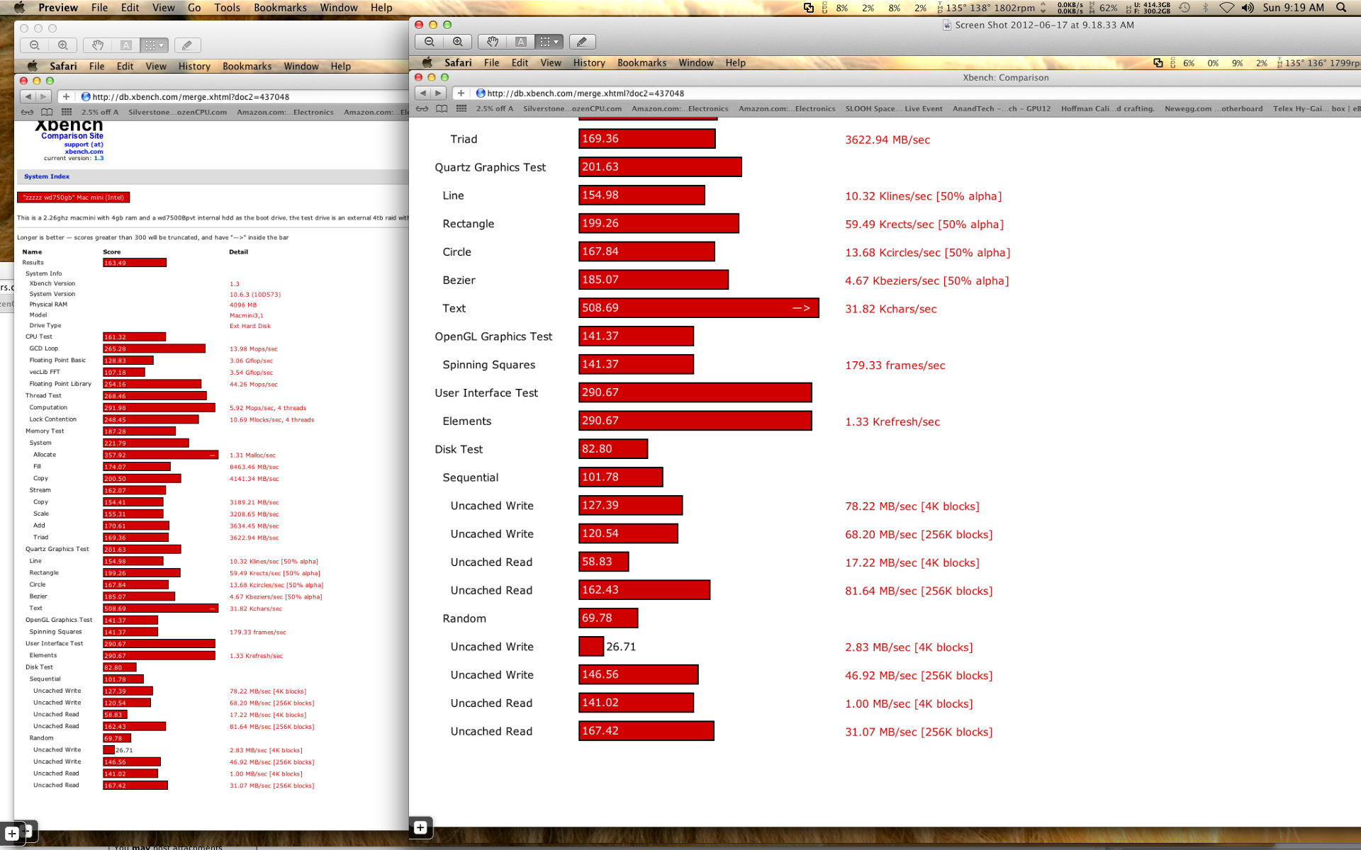

Statement indicates you don't have any understanding of sata vs fw800 and how it relates to ssd's and hdds for speed of operation. A oem mac mini hdd is 40MBs to 65MBs in a long copy. An oem mac mini hdd is under 2MBs in random read write.
An ssd in in a fw800 case is 80MBs in a long copy and 10 to 20 MBs in random read writes. It will destroy the oem 5400rpm drive.
It will also beat a 7200rpm hdd in all but long clones. If you want I will post a few tests.
below are scores for an internal western digital. scorpio black 750 gb just about the fastest internal hdd you can put in a mac mini.
the random read write numbers at 4k are 2.83MB/s and 1.0MB/s .
that is slow compared to any ssd in a fw800 drive.
