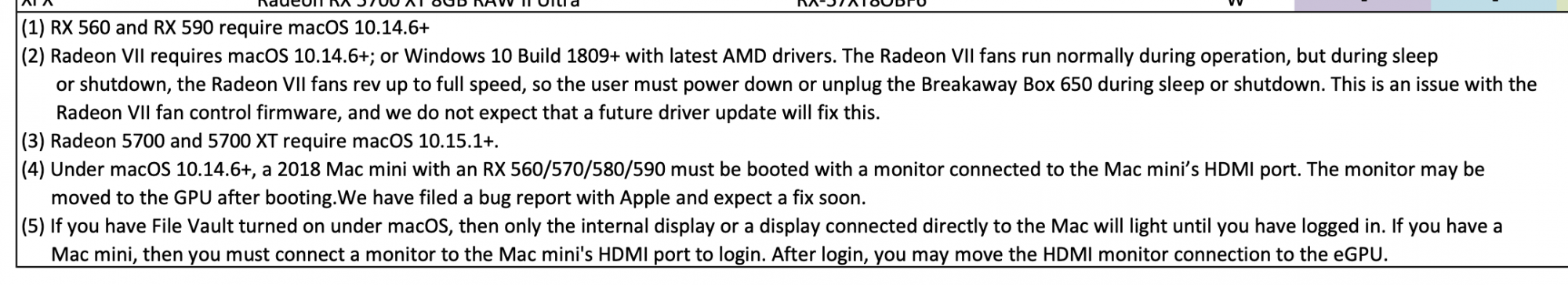

The black screen thing is an annoyance. I connect the HDMI from the mini to one of the monitors and unplug the eGPU before a reboot. Most of the time it just sleeps, I very rarely shut it down but I’d still like apple to fix this. Does it happen on newer cards too?
You can use a Headless HDMI plug in the mini and have the other monitors attached to the eGPU. The monitors will stay off right up to the point of entering the password but it does mean you no longer have to use the GPU on the Mac mini's CPU.
When first setting up, turn on the computer without the Headless plug installed. Once booted up, unplug any HDMI cable that is plugged directly into the mini. Plug both your monitors into the eGPU and then plug in the Headless Plug.
Then go into System Preferences - Displays - Arranging Screens. Press the Alt/Option key then select the Headless HDMI monitor (1080 res) and drag and release it on top of the one of the actual monitors. This will make the headless plug mirror that monitor... This stops your cursor disappearing off onto a screen that doesn't exist.
When you boot up, the screens will appear like they are dead but just wait, once it reaches the point of entering the password both monitors will start up.

I thought I should lob back in with the latest about my mini to keep sigmadog (original poster) in the loop.
I’ve tried multiple display cable combinations attempting to stop the fan going nuts on my OWC Mercury Helios FX650 eGPU. Some days it works fine – no fan going berserk. On one occasion I actually enjoyed two days in a row of perfect, silent bliss. Then, the next day the fan randomly started up and soon ramped to escape-velocity speed. On a few occasions the fan has slowed itself down and resumed normal duties(!), but most of the time I put the mini to sleep and hope a wake-up will solve it. A wake-up works…sometimes.
I decided to try a HDMI (from the mini) to DVI cable direct to my main monitor, with only my second monitor powered by the eGPU via a Thunderbolt 3 to DVI cable. As a nice bonus I now get a boot screen and progress bar.
But… wait for it... in FOUR days the FX650 fan has not ONCE ramped up! Silence. Bliss.
So, I’m happy enough to tolerate this until Apple/OWC come up with a solution to the mini/eGPU issue/s.

I ordered one from Amazon and it arrived today.
And it solved my problem.
My set up, a 2018 Mac mini i7, 500 GB, 32 GB RAM. I have a Razor Core X eGPU with a Sapphire Pulse RX 580 GPU that I took out of my 2010 MacPro when I transitioned to the Mini. I have two ancient Apple monitors, a Cinema Display and a Cinema Display HD (I said they were ancient) connected to the RX 580.
When I first hooked everything up I had the black screen issue. I solved it by using a Luna Display with my old iPad Air. Sort of. I did not have to connect a monitor directly to the Mini, but I had to boot up with the eGPU turned off. And once the Mac desktop appeared on the iPad I could turn the eGPU on. Better than plugging-unplugging cables, but still non-optimal.
With the display emulator plug I can leave the eGPU plugged in and turned on. And the monitors come on when the Mini boots up. Yes I agree I shouldn't have to do this. But as another member says, use what works. And for $7 US I'll take it.
There was a bit of configuration I needed to do to make things work. When I first booted up the plug was seen as the main monitor. And I had no menu bar or dock. I fixed that by hot removing the plug, setting each "Displays have separate Spaces" to checked in the Mission Control system preference panel, which gives a menu bar and dock on each monitor. I plugged the plug back in and rebooted (the preference change requires a log out). Once rebooted I set the monitor arrangement in the Displays system preference panel such that the plug 'monitor' was monitor # 3. I then turned off "Displays have separate space" setting and rebooted. And so far it 'just works'.
