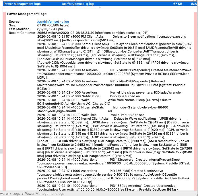

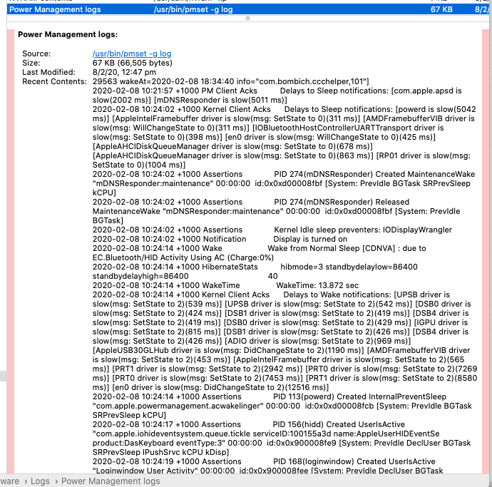

  5. Catalina’s ‘Energy Saver’ doesn’t have a have a separate Computer Sleep setting. If I use the manual “Sleep” command the mini + eGPU and HDD enclosure ALL go to sleep. I have ‘Turn Display off after’ set to 5 minutes but then (of course) the eGPU and HDD enclosure keep running. Sigh. I’m accustomed to walking away from my computer and ‘knowing’ it will go to sleep if I stay away from it longer than expected.
    Any utilities out there to restore the ability to set a Computer Sleep time setting?
  6. System Report/Logs/Power Management logs is showing a red bar down both sides of the report so there’s obviously something amiss. I’ll see if reading through all of it reveals anything. Anyone else seeing red bars?
