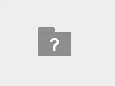

I bought a Current Gen Mac Mini from a classifieds. Well the guy didn't reformat it and it has a password so I couldn't change any settings. Long story short I think i reformated the start up disk and now when I start it, it shows this.
It just keeps flashing. I tried using a timemachine backup from my Imac but didn't work because its was from a different kind of machine. My wife is super pissed and I don't feel like sleeping on the couch all week. Any ideas?
