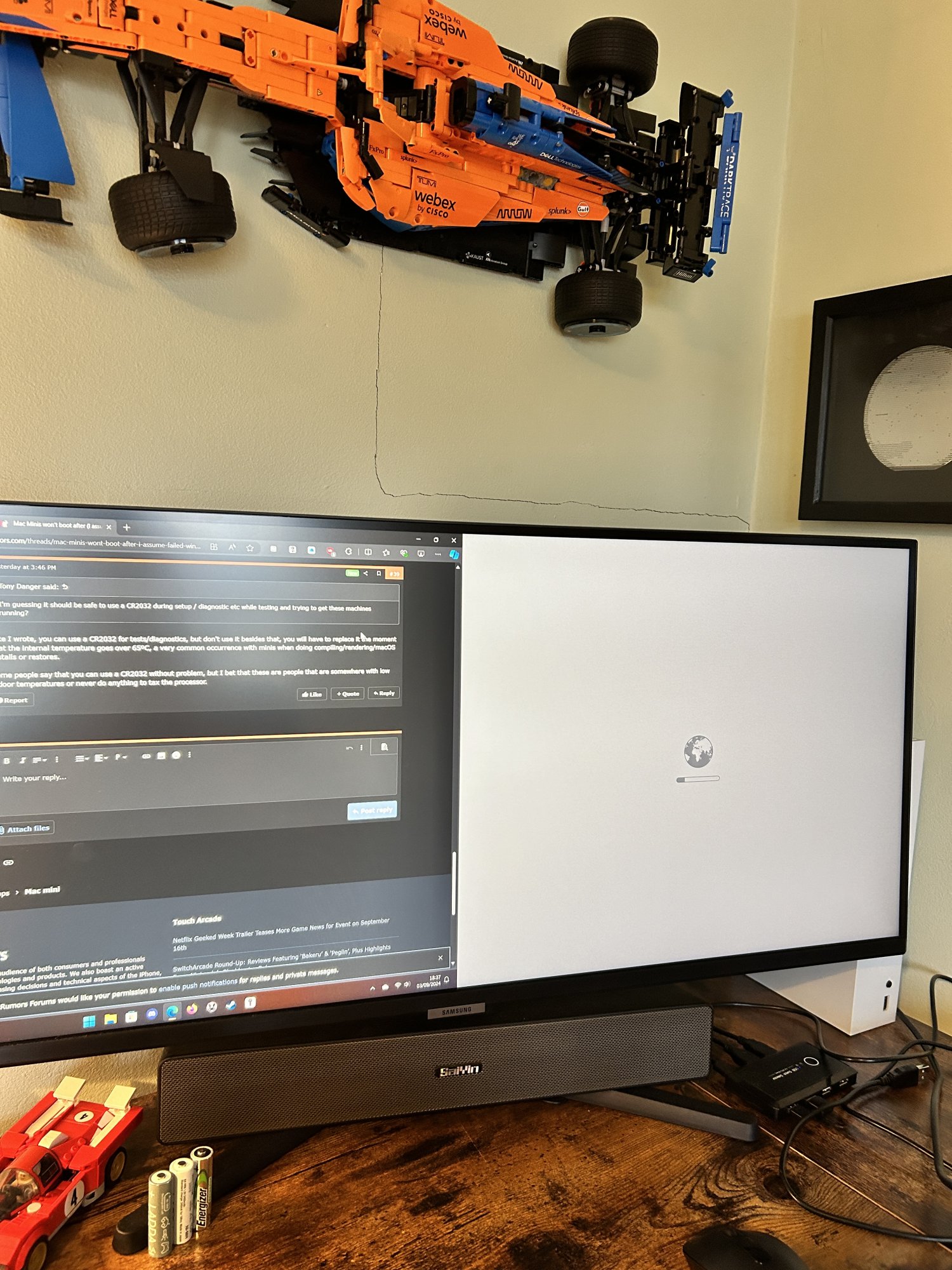

Well good news. The new ones arrived and can be booted into recovery! So time to get one running then clone the drive.

Put the drive in from one of the working ones and it booted. So I cloned the drive and all seems well. I can now get into boot selector and internet recovery etc on all 4.
