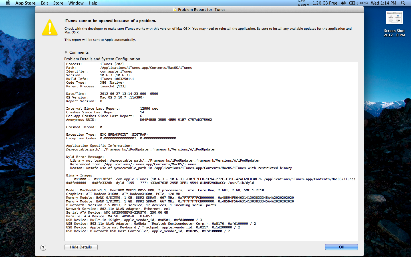

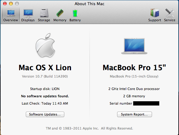

iTunes
Is there any way to install iTunes 10.6.3 without the error message? I'm running IOS 6 Dev Preview 😀, and i would like to actually use this install primarily. iTunes is a necessity.
