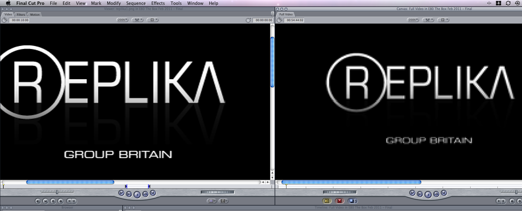

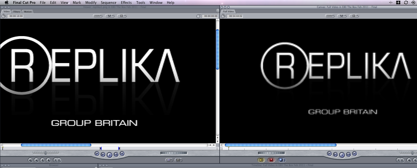

While the computer and software in the editing process was working perfectly (I'm sorry for being a complete pain here!) I'm having some trouble with my carefully crafted titles (which was the whole point of me getting the DVD in the first place).
The titles match the settings in the sequence and I've saved them from photoshop in most common formats (PNG, JPEG, PSD and TIFF) and they are pixelated and heavily anti-aliased (if that makes sense?) when imported into FCp. I have tried lots of different preview options in FCP and also doubling the image size of the titles in Photoshop, in the hope that the larger size would reduce the poor quality, but that doesn't seem to work either.
As you know, I'm using the ProRes codec for the video (which has square pixels) and I have tried to match that with the size of the Photoshop CS 4 images. I thought at first that it was just some preview setting in the canvas so it hasn't bothered me throughout the process, but now, after exporting, the quality is the same and I'm rather concerned!!
Not jumping to conclusions about software faults, poor computers etc. I realise this (again) is probably my fault... Just wondering if anyone can explain why? - and obviously what I can do about it! As you can see in the attachment the Viewer shows the imported PNG file on the left, the Canvas shows the same file after it's inserted into the timeline (and rendered).
Photoshop for Video by the inimitable Rich Harrington is a great place to start.
Firstly, make sure your PSD project is NTSC (or PAL if required) size.
Thanks Martin. I've double checked the size and I'm working to Pal settings. Had a look at some of the videos above too. Just not sure what to do here. Keep searching for now I guess.
If its pixelated maybe you need to save PSD as PAL 720x576 in Photoshop.
You can check the Film & Video settings for that res.

I did that to show the pixelation in more detail. It's still (very) rough looking at 100% I just wanted to make sure it was clear on the image.

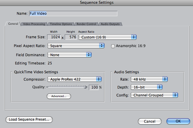

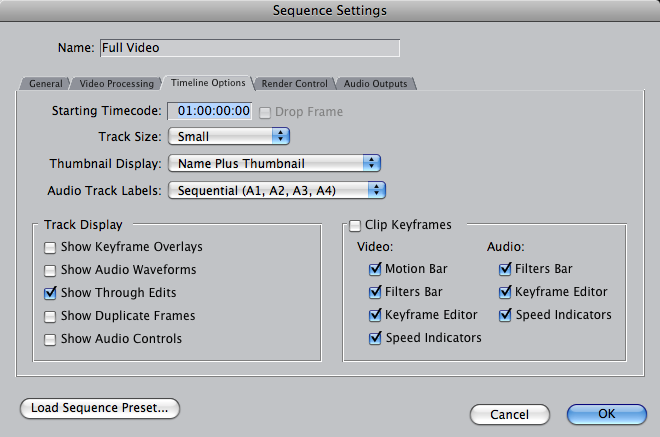

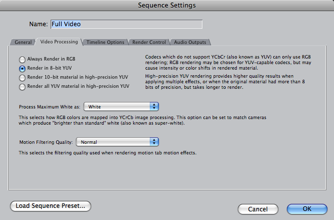

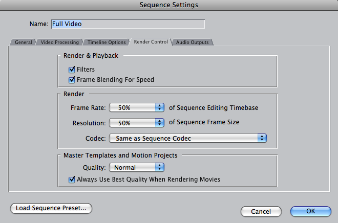

I think I can help. What settings are you using for your timeline?
I hope so!! This is driving me mad. Even the vector based artwork that's included comes out jaggy on export! I've got a new project with everything identically matched in FCP and Photoshop and it's still doing it. I've exported to AppleTV using the compressor settings and it's still doing it.

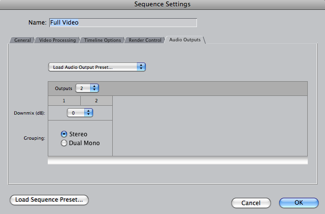

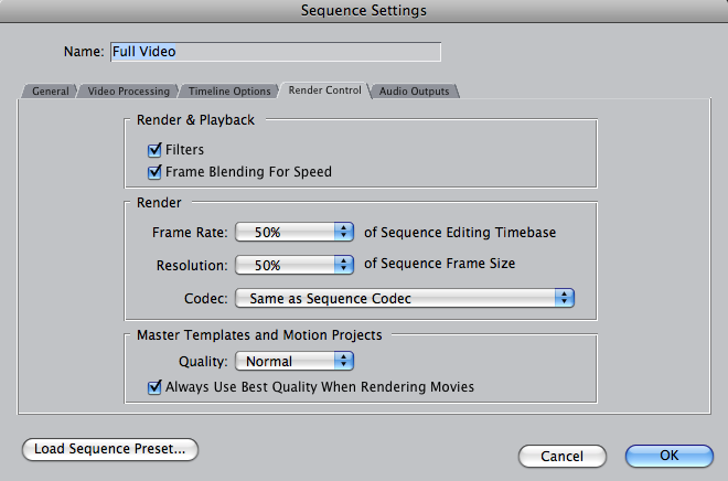

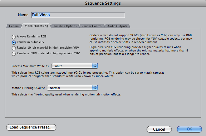

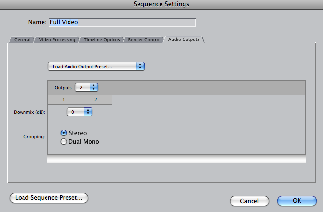

Here's the settings for my original project - these came from MPEG-StreamClip when I ripped the DVD.

...Here's the settings for my original project - these came from MPEG-StreamClip when I ripped the DVD...
Your original DVD footage (as Ive stated at the start) should be 720x480. Maybe Im missing something but you should be using that as your target resolution. Unless of course your not working with DVD footage?
