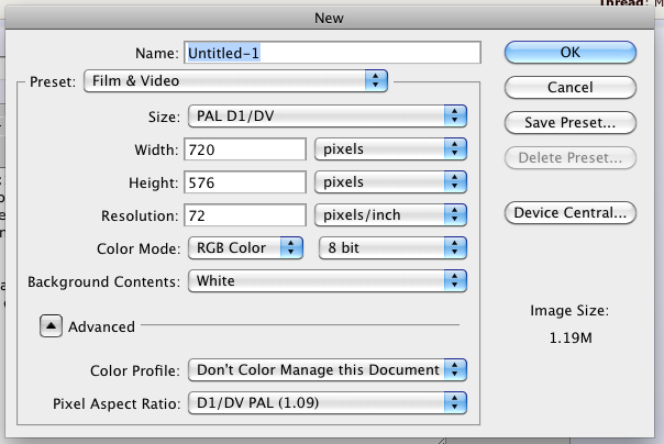

sorry to sound harsh with last post. If your original DVD is PAL then res is 720x576 Non-Square Pixels. If you ingest footage into FCP you have to stay the course and not change the size unless you were planning on mixing it with 720/1080/? footage.

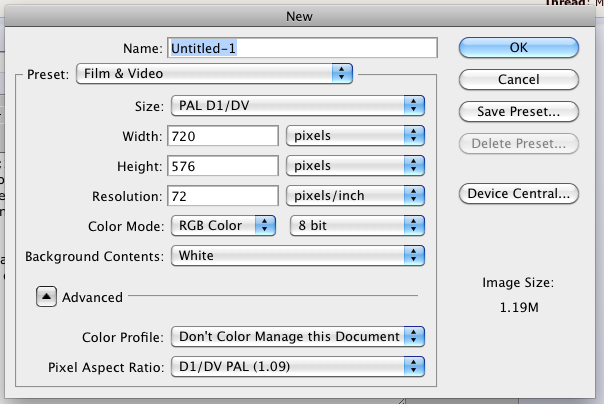

Your Photoshop doc settings should start like the attached image.
Since you acquired your footage 1024x576 Square Pixels (which I have no experience with), before applying any PSD layers maybe take the final sequence and subnest it into a PAL DV/DVCPRO 720x576 sequence (forgive me if Im off with the settings, Im at home no FCP here) and then apply your PSD layers and render at the new sequence, see what you come up with.
At the start of your posts I suggested you stay the course thus why I kept throwing the 720x576 numbers. I didn't realize you changed the pixel res using ProRes. To be honest I dont use ProRes, I've had to fix some ProRes files but never had the pleasure of working with it.
Now Im pretty sure the reason your original footage and rendered footage looks pixelated at text specially vector is that its been rescaled from Non-Square to Square pixels and size.
Video has tons of anomalies allready that it hides this problem.
Graphics with sharp edges cant get away from this and you should always work with graphics from a 1:1 pixel res if possible.
I teach FCP/After Effects/Maya at local college, this is the first thing I have to drill in my students head.
Dont start at wrong res unless your experienced with it.

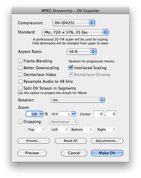

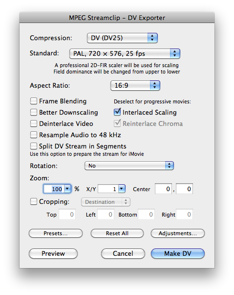

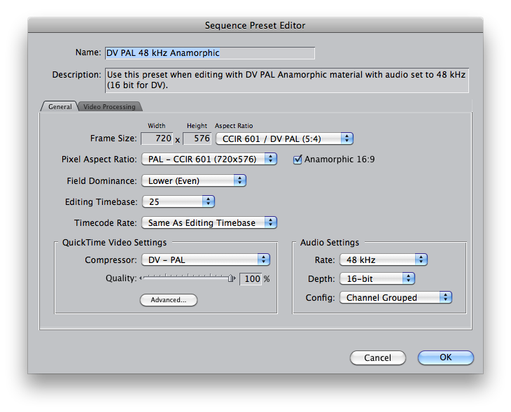

If you do decide to start from scratch, here are some tips.

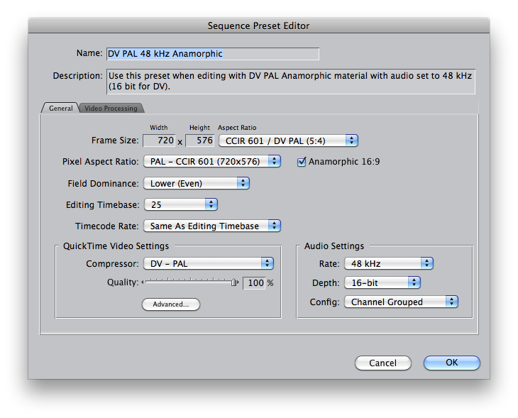

Now if your DVD is PAL and set to 16:9 then you want to start with:

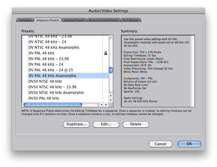

MENU>Final Cut Pro>Audio/Video Settings...(see first attached image)
The second attached image is the actual breakdown.
Now of course I didnt explain the part about MPEG StreamClip.
See attached for settings. Im not sure how your ripping it (sorry I havent read the original post in days) so good luck with that part.

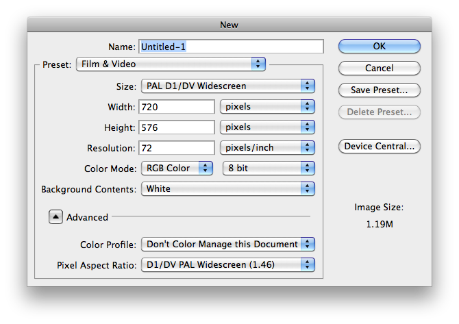

Now as far as working with graphics, as long as your staying within the legal size of your original, then your intended format (which is the same as original) and from what Im reading, then you should be close to fine.
Please understand that re-burning of DVD media is a gamble with final results.

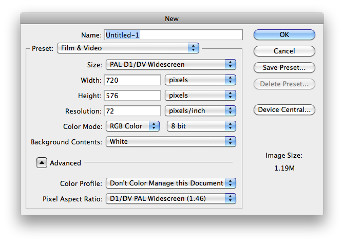

See attached for Photoshop doc.
