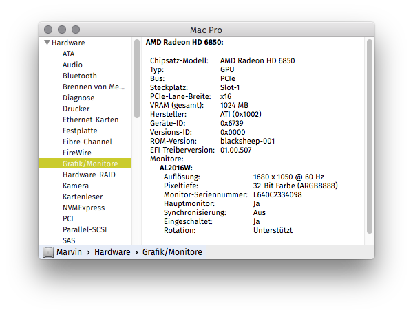

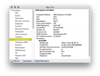

@666Sheep @Fl0r!an I wasn't aware that there is a 32bit EFI! Sounds promising. I'll work through the linked thread, thank you.
Edit: Found the 6850_EBC and flashed right away. System Information now shows the card properly in the PCI section. Thanks again!

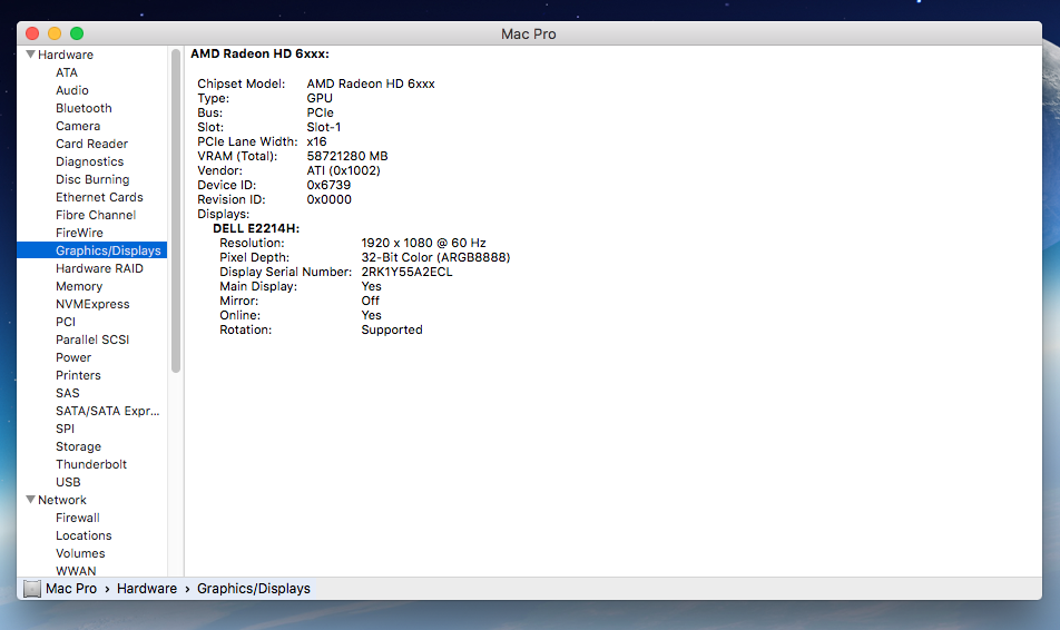

...I just need to confirm that either i really don't know how to follow online instructions or this particular card is the problem. :)
I guess something went wrong when adding the efi part to the rom.
I remember when merging the roms the block count was shown incorrectly and the resulting file did not show two roms. I tried with block count 128 and all went well. This is just from memory, the number could be different. I suppose I just picked the greatest.

That's what I'm trying to figure out too.
ROMs are identical after flashing. Ill try with blocknum 128 this time.
Did you use 6850.fi.rom from "Make your own Radeon..." or "Radeon port mapping" topics?

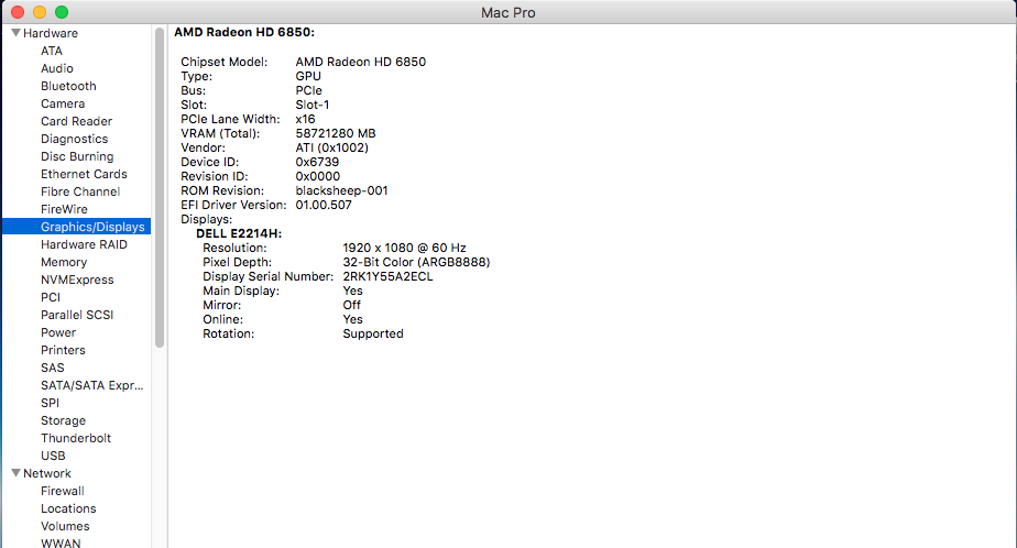

I have to do something before i get a new card, because after yesterdays adventure of 58TB of vRAM, FCPX started rebooting OS on background rendering and i have to finish that project soon.
Edit: I've bricked it, this will be long night... :)
One more thing.
Since I already have soldered pins on bios chip, could you upload yours working EFI bios, just to try it before I put everything back as it was?
Thank you so much for your help.
It did work but there is still 58TB of vram. So i'll probably go back to stock bios. Also, Mac freezes in FCPX with this rom. With stock bios it was "just" restarting OS every now and then while rendering.

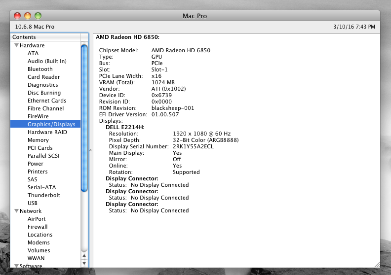

EDIT: But in 10.6.8 everything reports OK? Any idea?
Yes, few times...

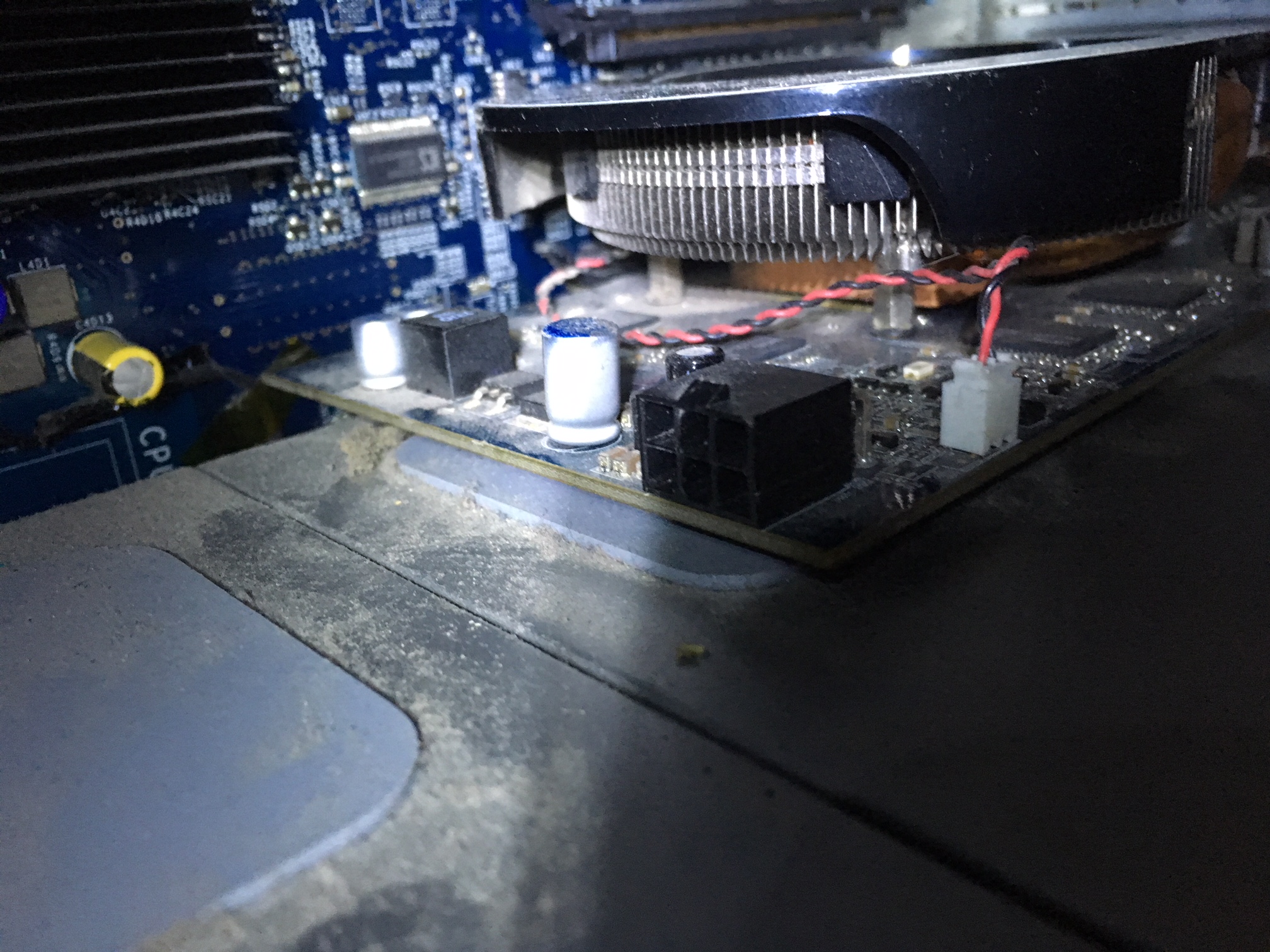

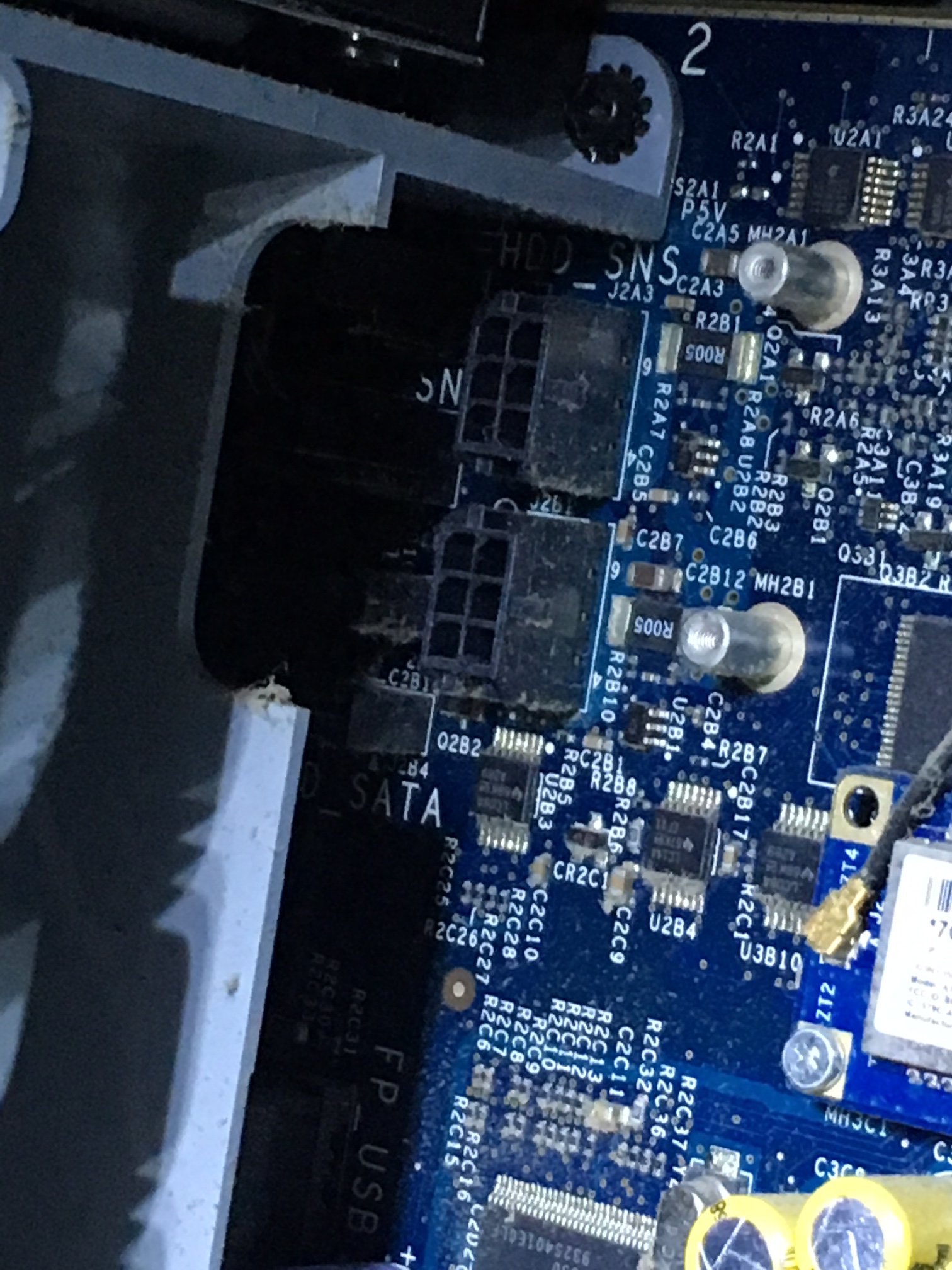

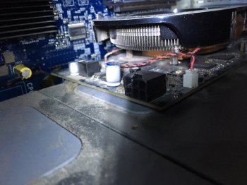

I have a major question regarding upgrading graphics cards on a Mac Pro 1,1.
I've been working on this all day, with no help from anyone.
I need the power cable for a Radeon 5770 from VisionTek which I guess is just a more generic manufacturer than ATI. Everything I've read said a generic knock off will still work all the same and I acquired this PCIe card for only 20 bucks on eBay.
The power cable is (I suppose) supposed to come in the Mac Pro but I guess whoever owned this computer before me took it out purposely.
I have pictures of the connections which I will post as well, even though I'm sure you guys don't need that and will be able to just tell me.
I've seen many versions of this power cable online and am left stumped as to which one to buy. Every third party business/cable retailer I've called today either doesn't know what they're doing or has said this cable needs to be special made by Apple because every single graphics card will require a slightly different power supply on the Mac Pro end of the connector.
Is this so?
How has anyone been able to achieve this Mac Pro 1,1 upgrade, if so?
I'm hoping someone will reply and help me out on this.
Extremely desperate to solve this problem.

Those connectors are mini 6-pin connectors (that are on the mac pro) and on the 5770 that is a regular 6-pin connector. You need a mini 6pin to 6 pin connector found here
Thank you!! Finally someone who has given me a specific answer.
And just to be clear, you're sure I only require ONE of the power ports that are in line with each other on the Mac Pro? The only reason I’m asking to clarify is because the guys I called at Micro Center seemed to think it would require both ports on the Mac Pro to power the one port on th
Nice. Thanks for the info. I do have a question though. Obviously, the 8 pin larger connection, goes in the graphics card end, but and obviously two of the pins will stick out of one side because the connection on the graphics card is 6 pins. Does it matter which side they stick out?
