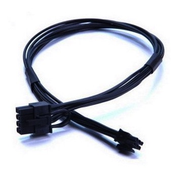

I do have a question though. Obviously, the 8 pin larger connection, goes in the graphics card end, but and obviously two of the pins will stick out of one side because the connection on the graphics card is 6 pins. Does it matter which side they stick out?

Those connectors are mini 6-pin connectors (that are on the mac pro) and on the 5770 that is a regular 6-pin connector. You need a mini 6pin to 6 pin connector found here

That makes much more sense. Every other one I’d seen so far had 8 pins. I was beginning to think that they were only made in eight pin and that it was standard that two pins stick out of the connection which is obviously absurd. I was going crazy over this. And you’re definitely sure this is the cable that will work?

I am pretty sure the cable should work. And yes, only one connector is needed

Yes, it might work. It probably does, if the two pins fit outside the connector.
It's only that the product behind your link does not correspond to what you wrote. Please check again Amazon link, it is a mini 6-pin to 8-pin cable. Why not get the mini 6-pin to 6-pin cable, which is exactly the right cable for the job?
From the Amazon description:
NEW Mini 6-pin to 8-pin Pci-e Video Card Power Cable for Apple Mac Pro/g5
Ooops, but the wrong product on accident. The mini 6 pin to 6 pin is surely the best option.
The six pin to six pin OBVIOUSLY was far more correct, so that's the one I ordered and did the job fine. The graphics card is updated. Lost boot screens as everything on the internet tells you to expect. Now I just need to make sure I download the right boot.efi. Is the boot loader that Tiamo uploaded for Mavericks the same one as Mountain Lion? I decided to do the Mountain Lion upgrade instead of Mavericks or Yosemite and I just want to make sure I do this 100% correctly.
