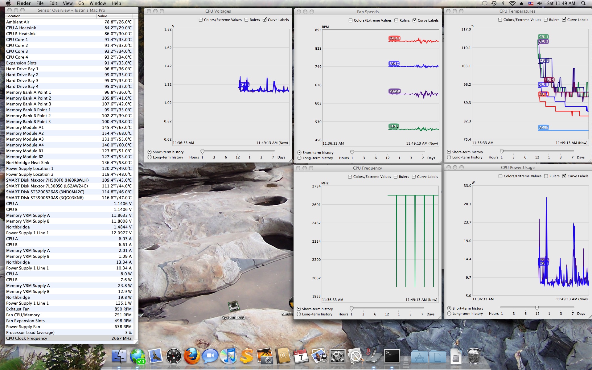

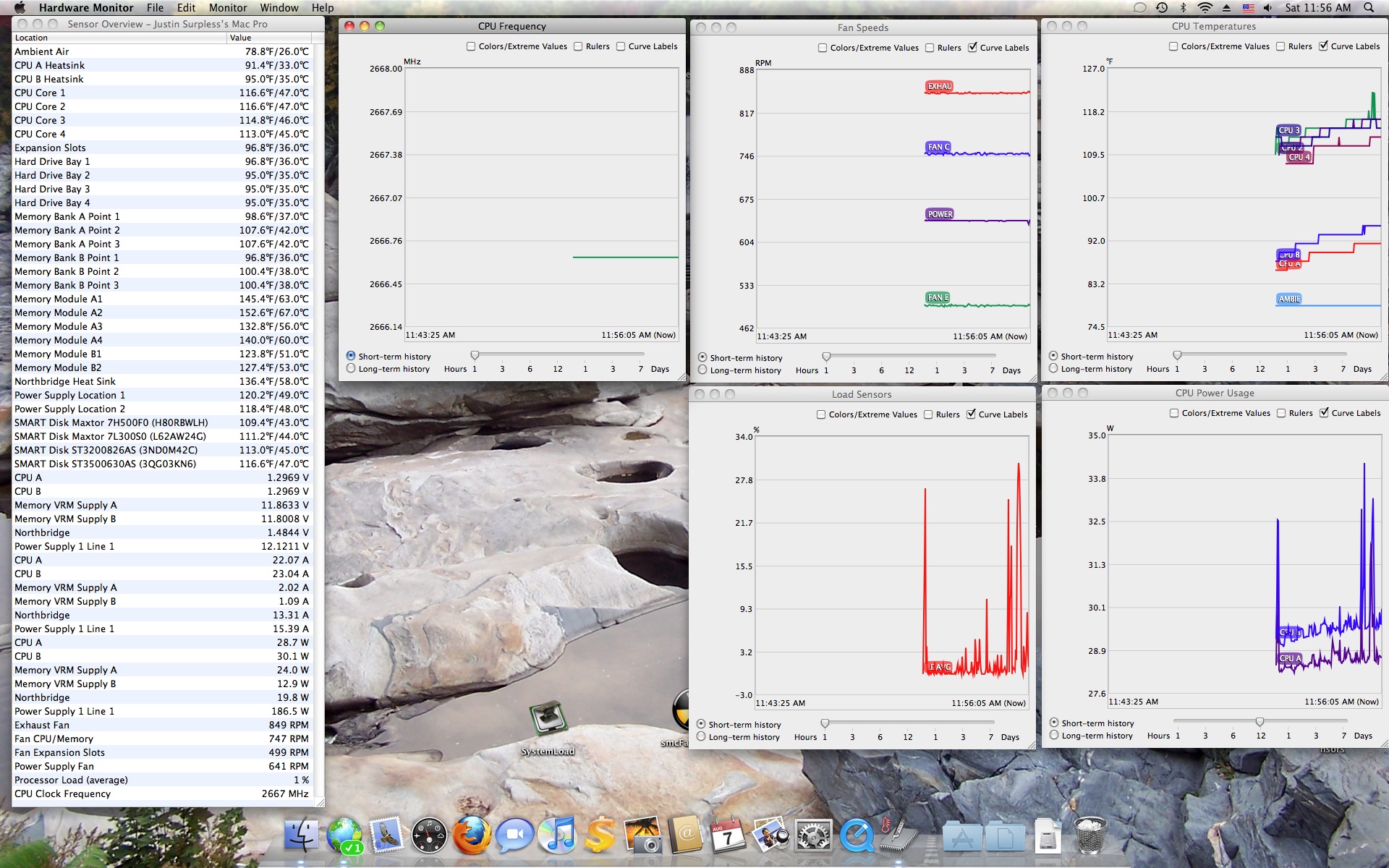

Take a look at these two screenshots... one is under 10.5.2 and you can clearly see how much LOWER the power draw and consequently the temps are... the other is 10.6.4...
One thing I just noticed is that under 10.5.2, the CPU frequency periodically drops to 2000 (is this SpeedStep?)... whereas under 10.6.4, it's constant at 2667... I can't imagine this doesn't have an impact, although it's so short...

Definitely something to keep in mind, but that would only affect the power drawn by the memory banks... Hardware Monitor differentiates, as you can see in the images I uploaded - only CPU power varies between them...

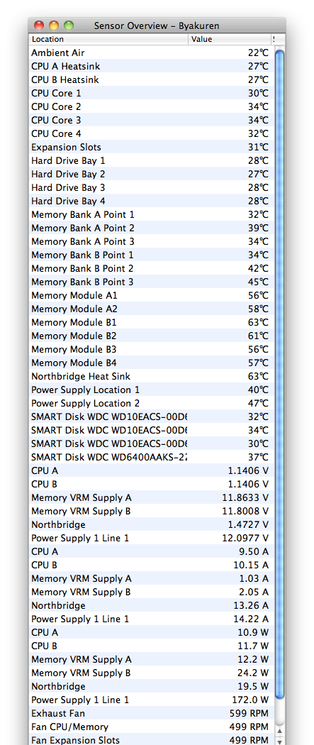

I have a Mac Pro 1,1 purchased in August 2006.
It's currently running 10.6.4 and is fully updated.
Hardware wise mine currently has 2 x 2.66GHz Xeon 5150's, 4 hard drives, an XFX ATi 4870 1GB graphics card, 6GB RAM (2x2GB + 4x512MB, as my other 2x2GB has just gone bad), dual SATA optical drives and Bluetooth + WiFi.
I haven't noticed any difference in temperatures or the power draw over the life of my machine, except when I upgraded the hardware such as the graphics card.
I've run Hardware Monitor (version 4.9), and here are my results. I haven't modified the fan speed or changed any settings regarding the hardware. The only reading which you can't see on that which go off the bottom are: Power Supply Fan = 599 RPM, Graphics Processor = ~5%, CPU Clock Frequency = 2667 MHz.
Oh also the state of the machine when those reading were taken was practically idle, though with lots of programs open.
Alfihar - thanks for posting this... much appreciated... your CPU power readings are right where mine are supposed to be under 10.6.4 (and are under 10.5.2)... so it's definitely indicating to me that something is amiss with mine...
