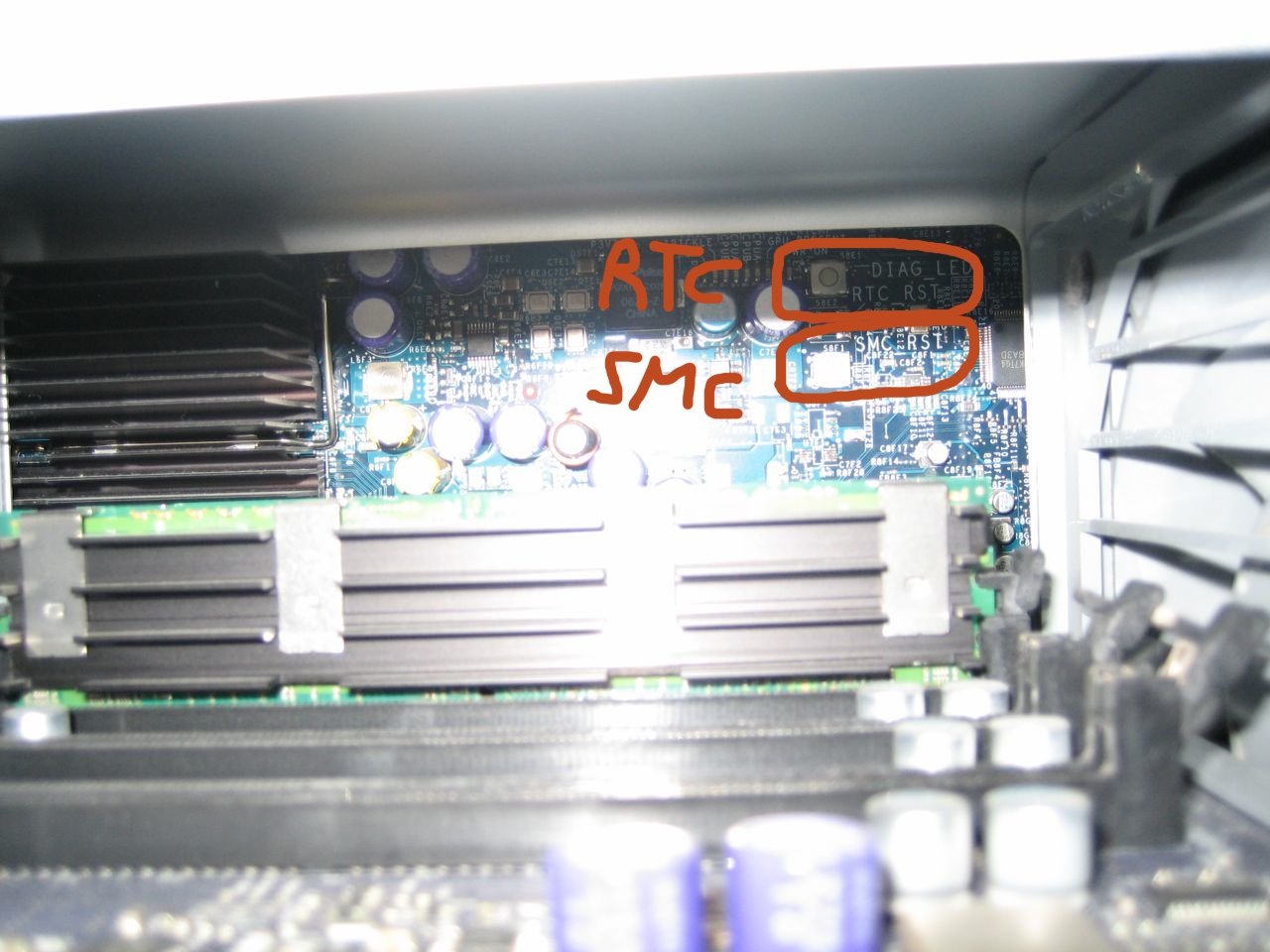

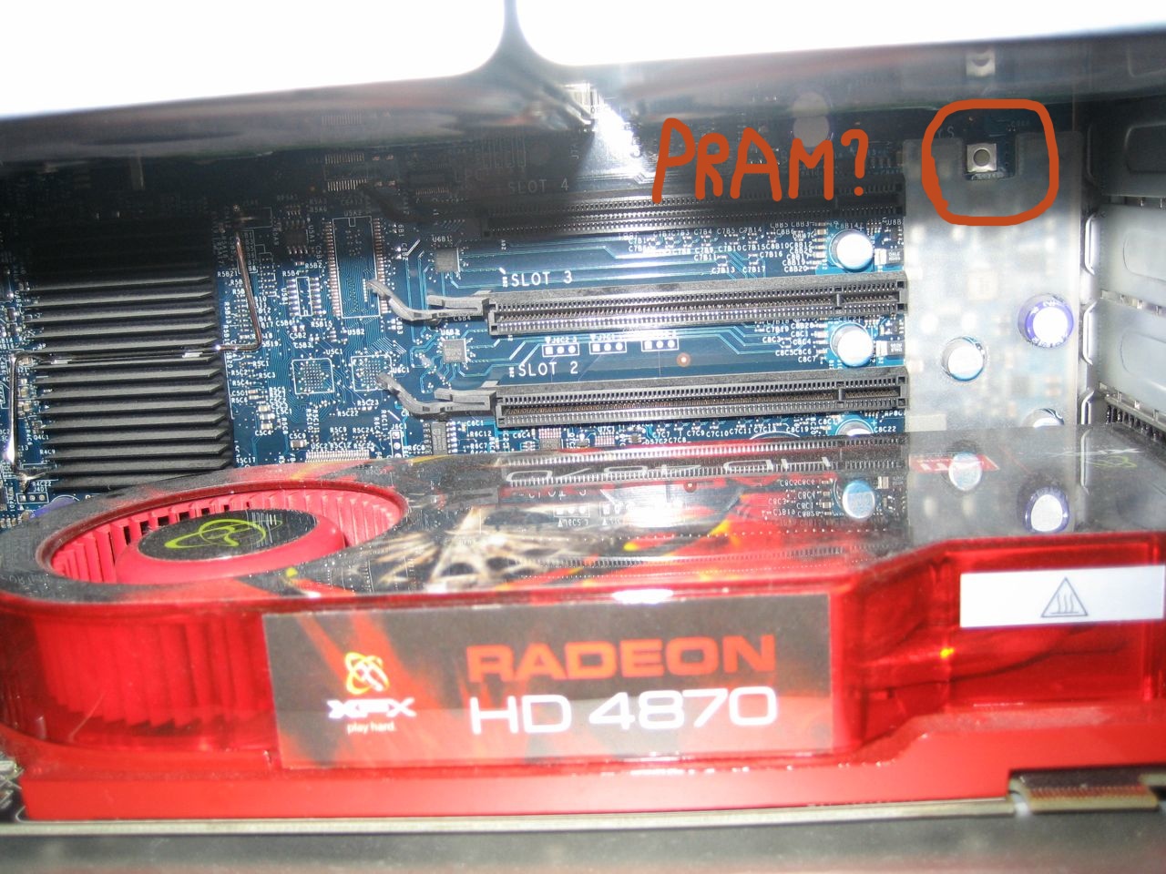

Also there are three little buttons on the motherboard, one in the area with the PCIe slots and two in the memory cage area.

What are those 3 little buttons you mention?

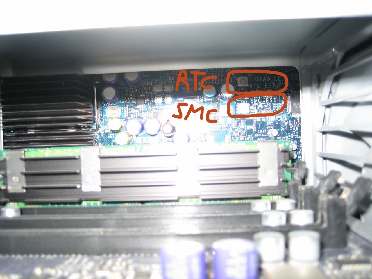

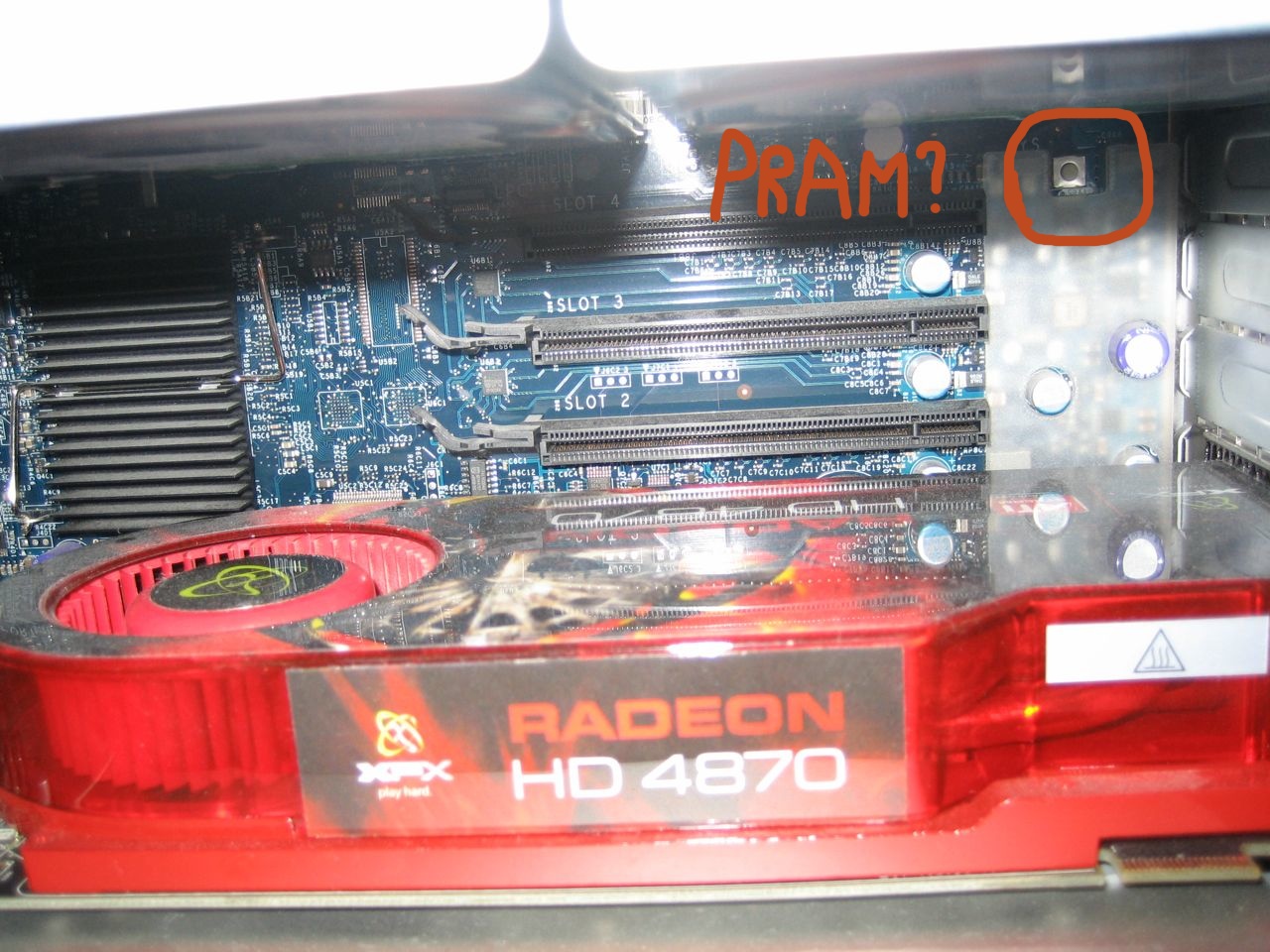

Here's a couple of pictures showing where the reset buttons are,
could try pressing them as it shouldn't cause any problems.
At-least it hasn't for me.
An article I read said that the one you labeled 'PRAM' is the SMC...
I'll have to try pushing the others...
Zoom in on the picture, you can see where the RTC and SMC buttons are labelled on the motherboard.
Though the one I labelled PRAM is a guess as I couldn't make out the writing on the motherboard. It might be a system reset switch though rather than PRAM.
