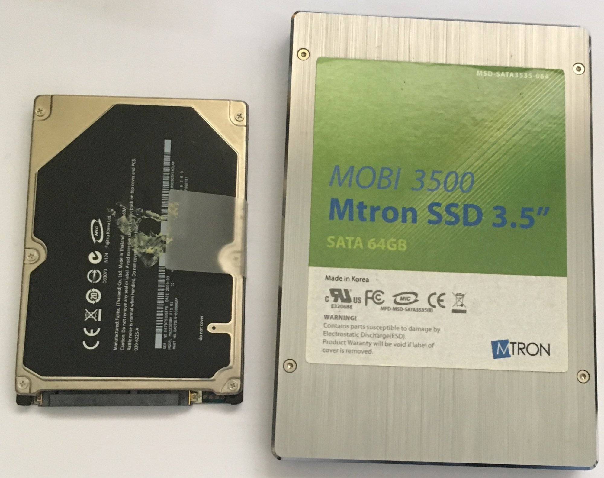

Remember that SSD's are actually smaller than 3.5".
Nope. ;)

I really would like two 3GHz in there but I will keep looking. I need to replace this rather slow HDD
Just looking on Amazon and found this
That's not the correct one. You will need to use a more precise keyword for searching. "5.25 to 3.5 bay converter" is the correct one.
The best result (to me) is in the link below.
Reactions: simie
