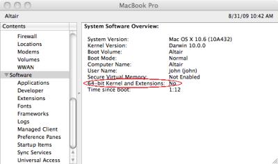

You can try boot 64bit kernel by holding 6 and 4 keys on keyboard while booting. Then check here to confirm:

Can't boot 64bit kernel. (not true, see below) Right, but according to TUAW:

WTF. I did "ioreg -l -p IODeviceTree | grep firmware-abi" in terminal and all of a sudden it's EFI64.
I swear that a year ago I was pissing mad for the same reason as my MP for not being EFI64. They must've updated it.
See this for details: http://netkas.org/?p=189
