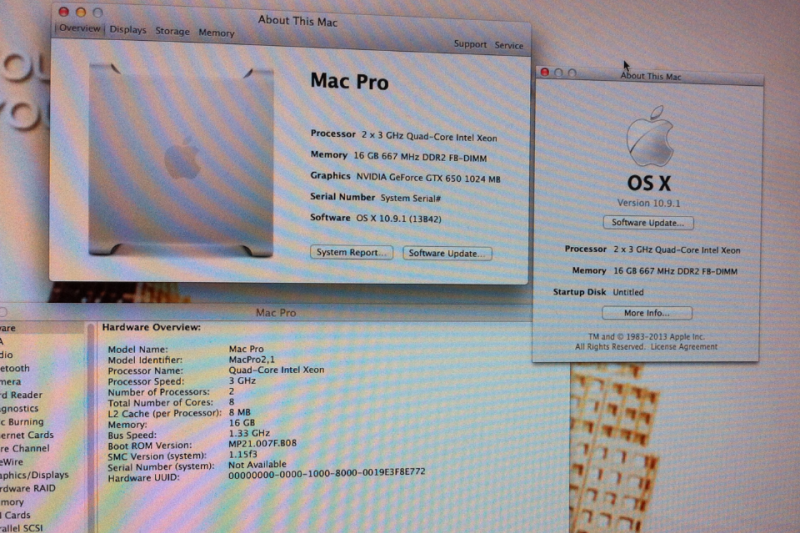

Here is the picture of my set up 🙂 Tiamo you are one smart guy that is crazy how you came up with that :O

Hi I figured that out on my own 🙂 Wow I still can't believe that it worked.
I had that problem too, and the terminal commands in reply #12 on this page in another thread did it for me. And reply #13 has a simpler method which I haven't tried.
Hi thank you so much for helping me out 🙂 It worked wow 🙂
I honestly can't believe it worked with "System Serial #" instead of a real one, LOL 🙂 Congrats!
