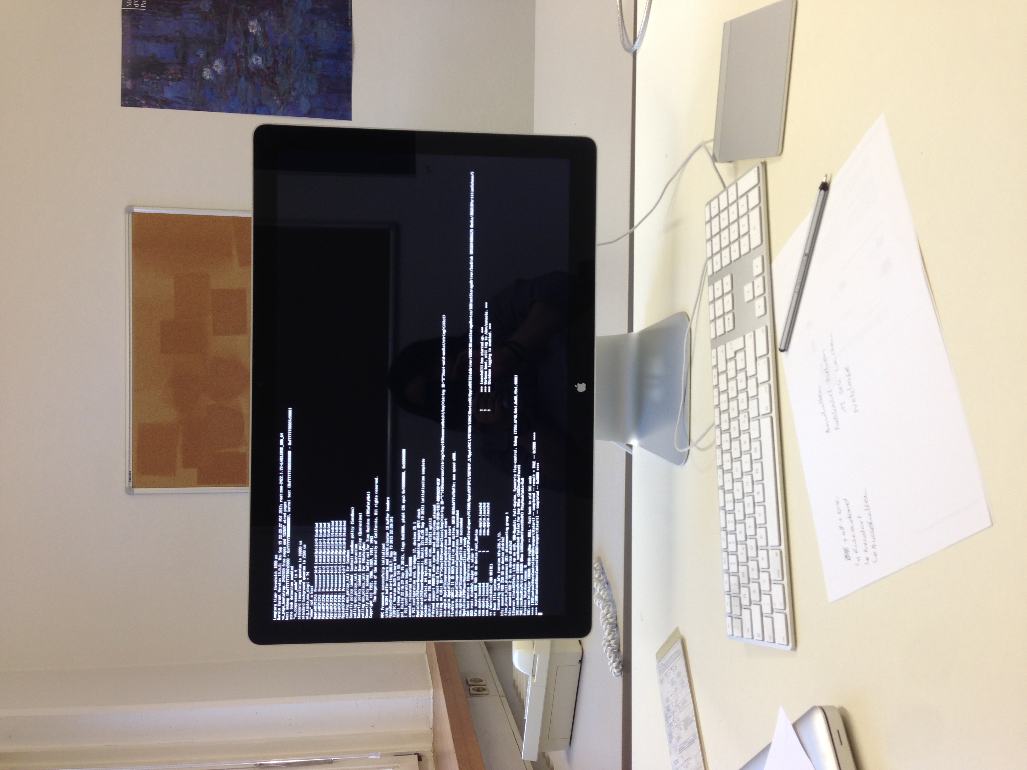

Everything works after updating my mac pro 1,1 to mac os x mavericks but i have a black screen with white letters while booting and also after clicking on "shut down". is is normal after updating with tiamo's tutorial? You can see the black screen on the attachment.
Thanks for your help!
Yes, it is completely normal, because you have the original, verbose version. If you want the non-verbose version, go to the second page of this thread, or thereabouts, and download the "silent" version.

You may have misunderstood. It's not the Mac in verbose/graphic mode. It's Tiamo's boot.efi. You have the verbose version. If you don't like that, use the non-verbose version. But, hey, suit yourself.
EDIT: I may have misread you. If you meant "noW the mac starts normally in graph mode!", I'm glad it worked.
