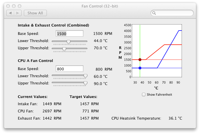

This is what it looks like:
As you can see, the CPU Fan and Intake and Exhaust fans are completely independent!

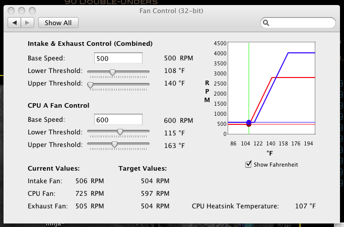

I think a better setting for me is 500, 108-140F and 600, 115-163F. It's keeping the fans close to their minimums and the CPU at 107F.

I like this version even better. Based on the settings above, when I render video files, my temps are 20F lower than with the other version! Normally, my CPU A temp goes to about 149F or so, and the fans blow very loud. With THIS version and settings, the CPU A only gets to about 129F, and the fans are at about half the speed as they used to... nowhere near max.

With the current settings in place for a few days now, I'm really happy. The fans are almost always at the minimums, and when I render, they only go half as fast as they did before. It seems to be a sweet spot for airflow now.

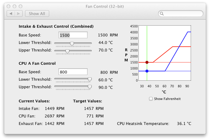

Installed this yesterday and was wondering why my CPU fan is running at 1700 ?
2009 Mac Pro?
Given the target fan speed is correct, that means the SMC is forcing the fan speed to be 1700 RPM.
Download Bresink Temperature Monitor and post a screenshot.
I wonder if the north bridge temp is too high...

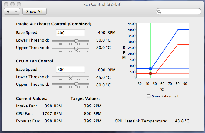

I run mine at 400/1000. (397/999/397) actual and I idle at 42.4(c). I'm running xcode, compiling, running iPad simulators, etc. That setting keeps my system cool and quiet. Running the CPU fan at 1000RPM still keeps it almost quiet whilst keeping the system cool all the time.
2009 Mac Pro?

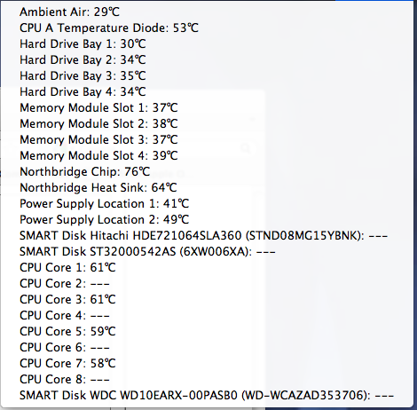

That seems to be a normal temp for an air cooled north bridge. I would start worrying unless it's hitting the high 80´s:

Do you have ANY other fan control software left over from a prior installation that may still be messing with things?

CPU fan speed

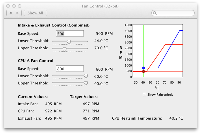

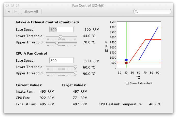

So when I raise my Intake & Exhaust speed just for kicks my CPU speed goes way up. Any ideas why it doing this?
The SMC itself controls the CPU fan at 142.5% of whatever the intake/exhaust fans are at.
It's not something we can change.
Besides, from my testing the CPU fan does a lot more 'work' for given noise than the intake/exhaust do, so the condition where you have your I/E fans high enough for the SMC to control the CPU fan too shouldn't occur.
In the next beta I will put a note saying what happens.
Also, you have a 8 core correct? That means only your CPU 'A' is getting controlled by the CPU Fan Speed setting, I need someone with a 8-core to confirm the CPU 'B' sensor code so I can make a version for the dual socket machines!
