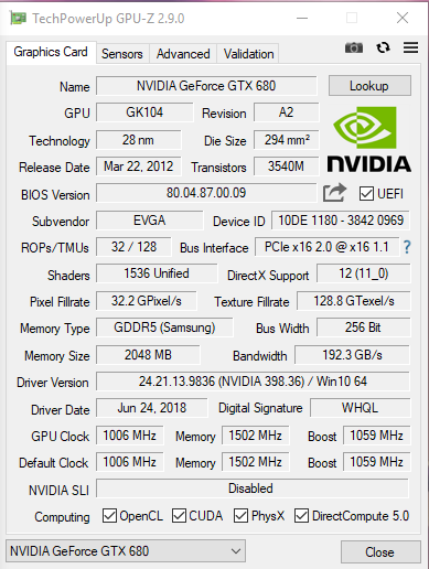

Tested my two cards in Furmark
Card 1:
- 115% TDP
- Temp 81C
- Fan 60%
Card 2:
- 106% TDP
- Temp 79C
- Fan 57%
Idle temp 37C, fan 30%
Idle temp 31C, fan 30%
They have very similar results otherwise though. The one that is highest is the one I found paste on. Specs doesn't reveal overclocking though.
Will re-paste them, and consider card 2 as the "best" one.

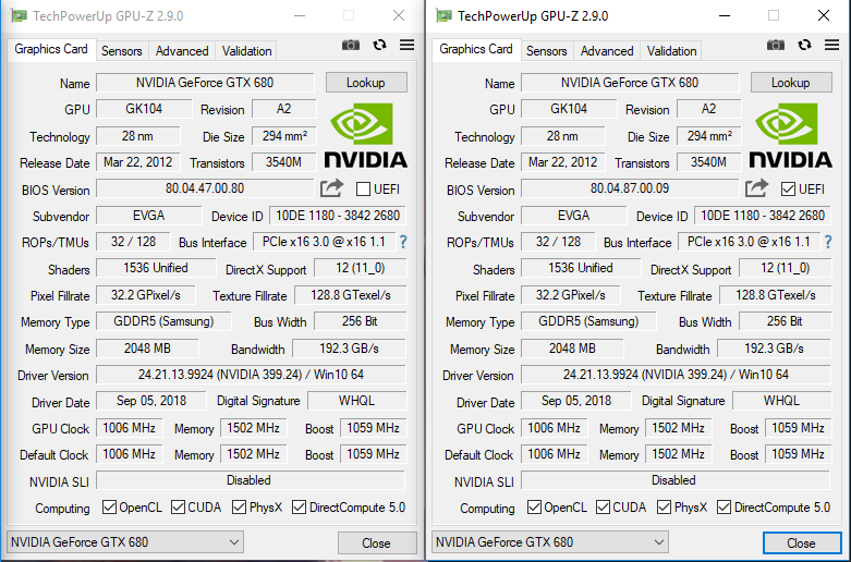

I found out that the difference is actually normal between two identical cards (according to EVGA forums).
Temp did however match at idle after re-pasting.

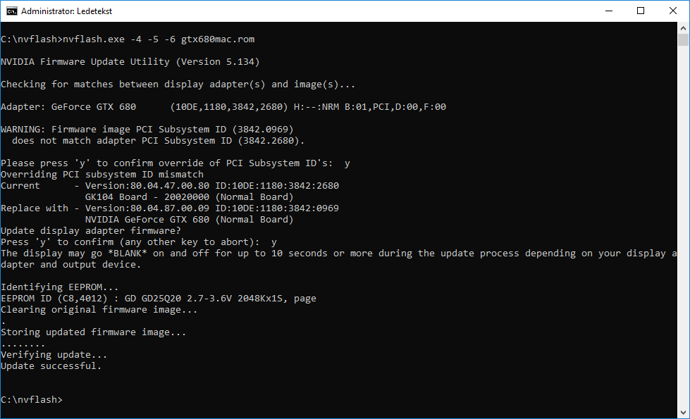

Well that was easy...
While the first card literally took seconds, and after rebooting and reinstalling driver (I guess a bit different Windows driver for the versions?) it worked perfectly, but had 110% TDP and 81C instead of 105% and 79C.
Anyways, card number two was REALLY difficult. Still not sure it's OK...
I couldn't get all info in GPU-Z (even though I did before). Maybe the now currently installed "Mac" driver messed something up.
The flash went through, but couldn't be verified. This messed up the card.
After a few attempts I was successfull in flashing a "0000FFFF" named card, and do now see the GPU again. Very strange.
Will try to reflash to make sure.
[doublepost=1536950079][/doublepost]Nevermind, I think it is OK...
Very strange though.
