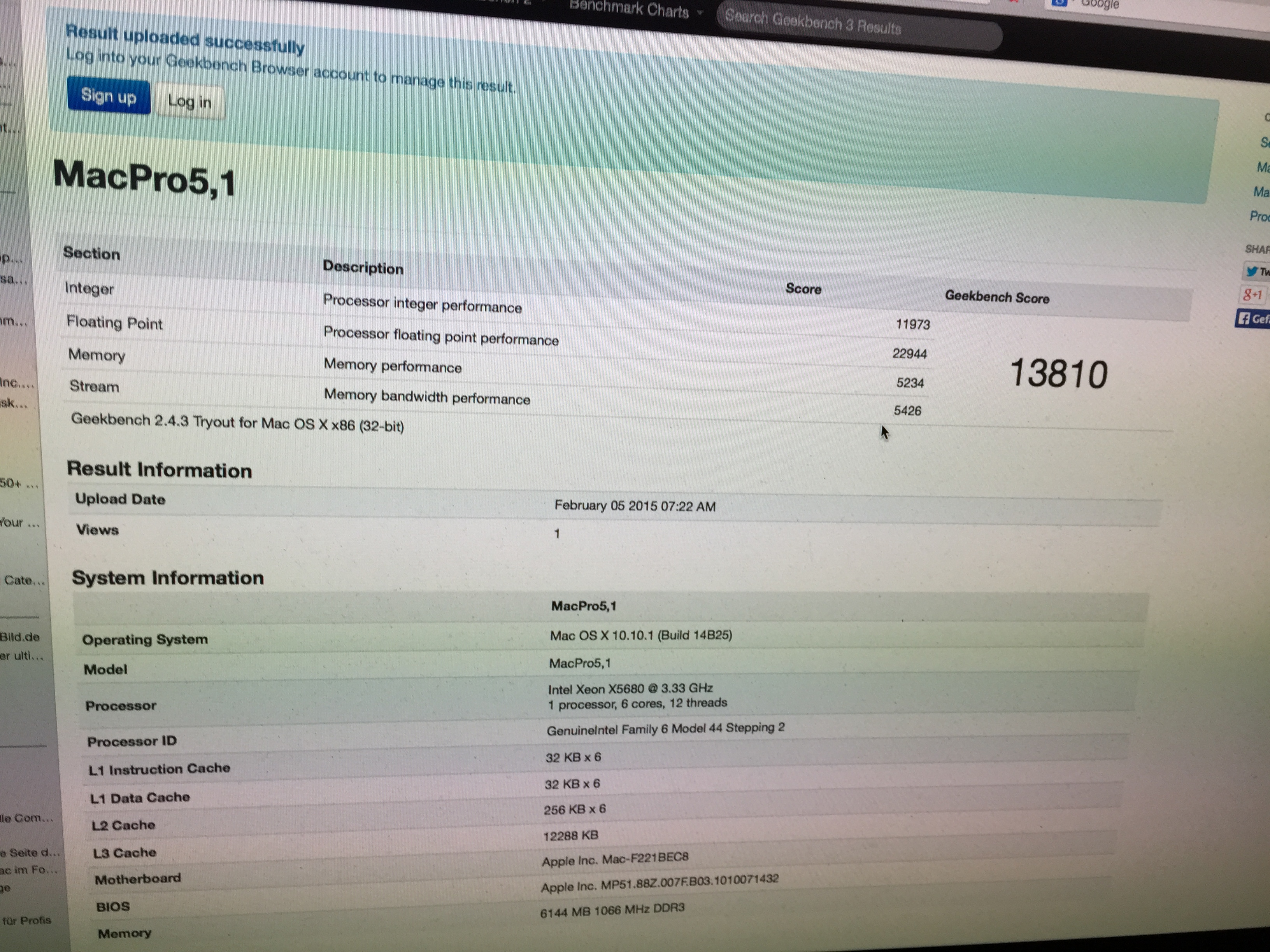

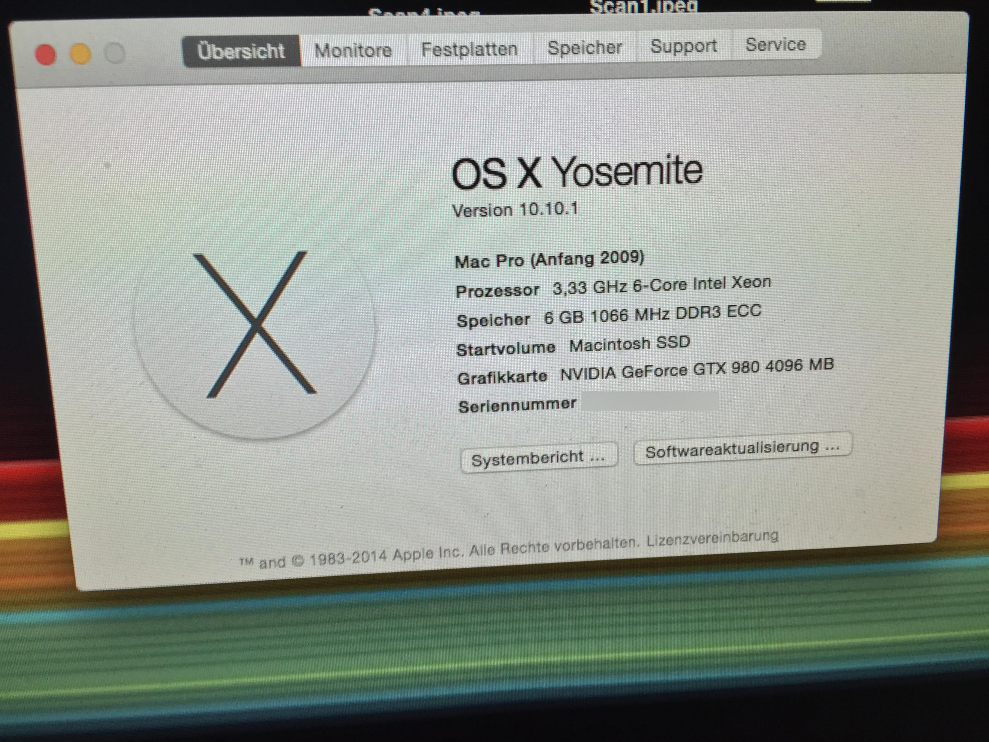

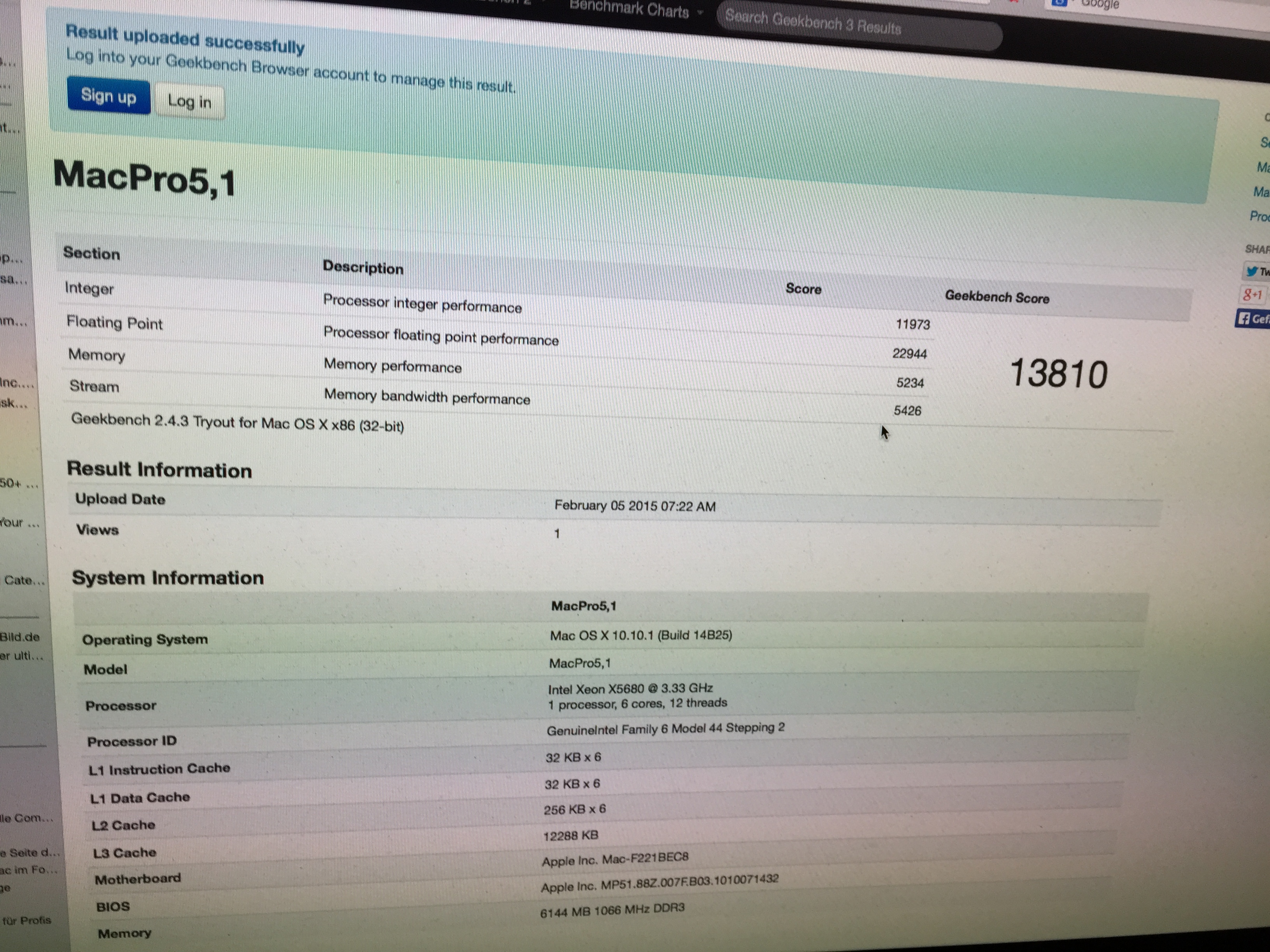

today in the morning something happends. i powered the mac pro on and boot sound! it worked with one 6 Core. I don't know why after a 10 hours sleep it worked but it did.
But then i put the CPU B inside. It boots and at Login Screen it freeze again.
And no boot sound again. looks like there is something with the cpu. When i look at the cpu it looks good maybe my dealer gave me a bad one.
