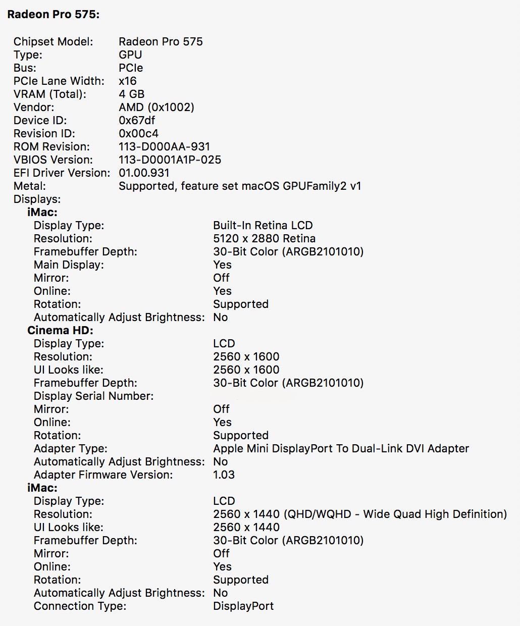

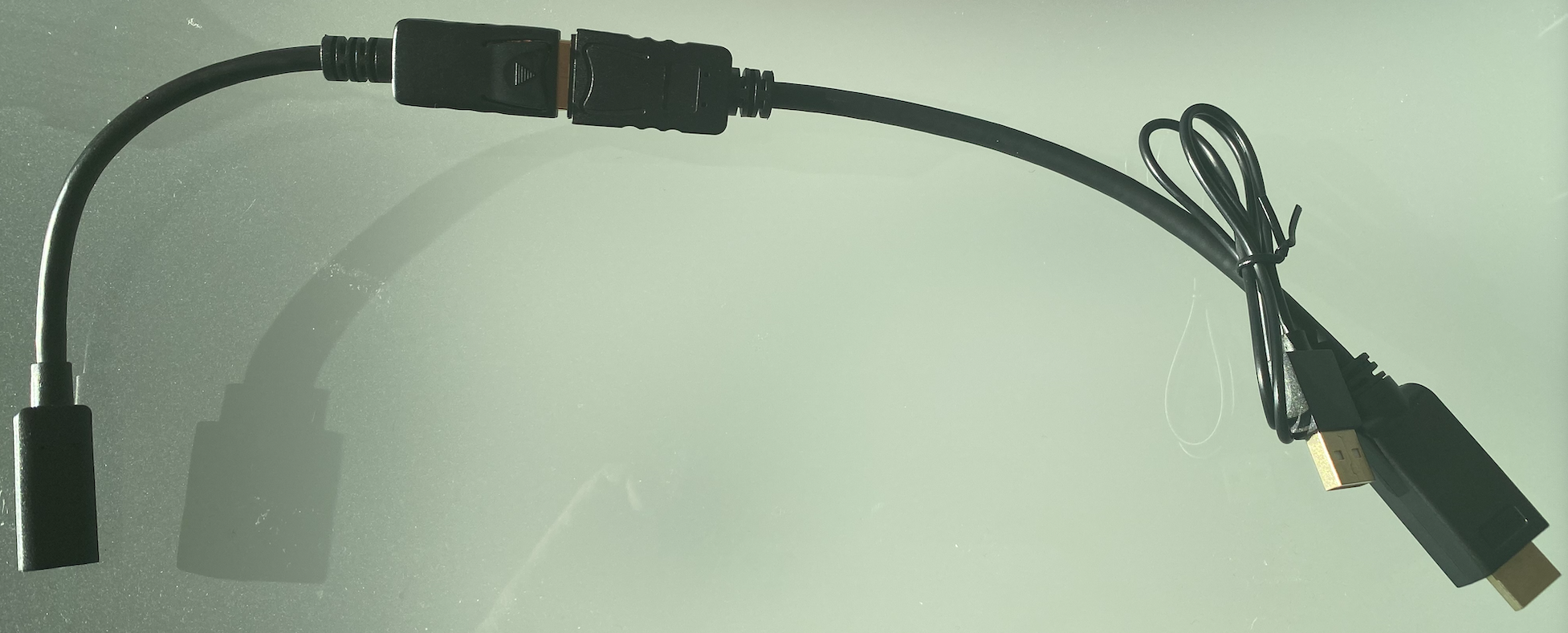

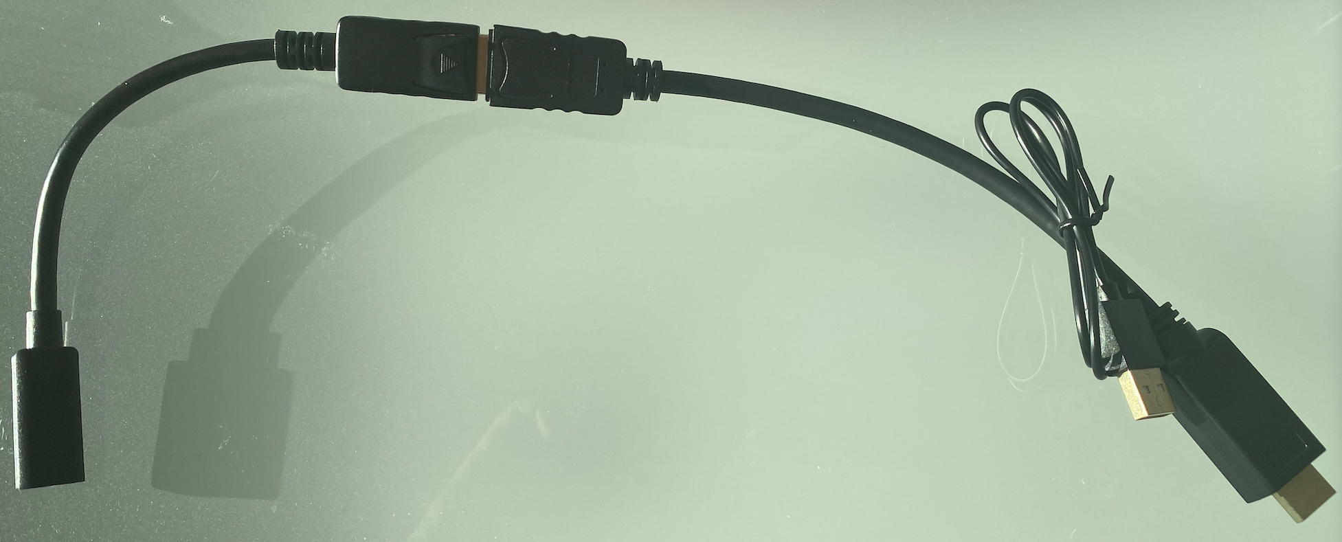

Having barley justified the cost of my lovely new 7,1 Apple's new 6K display is out of the question. I've used my ageing but capable 30" Apple Cinema Display for a while now and it still suits me very well. For audio production I really appreciate all that 16:10 visual real estate and it's one of the few displays out there that really compliments the 7,1 aesthetically. Retina will be a nice upgrade later down the line, but I'm not a graphics or video editor who really needs it.
But to get an explicitly DL-DVI display to work required a bit of a dongle train. My 7,1 only includes x2 HDMI ports on the Radeon 580 and x4 DisplayPort outs via the TB3 ports. To get around this I got this neat little USB-C to MiniDisplayPort adapter on Amazon. Next in the chain had to be a MiniDisplayPort to Dual-Link DVI adapter. Thankfully I already owned the official Apple one for use with my 2011 13" MBP. So together it basically upgraded the Apple adapter to USB-C on one end. I was able to test this configuration successfully with a 2019 13" MBA before my Mac Pro arrived.
View attachment 884519View attachment 884521
Thankfully all went to to plan and the day my 7,1 arrived I was able to boot up with eerie silence using my big beautiful 30" ACD. It might be old but it still manages to look better than most displays on the market today if you ask me. A small touch, but I was pleasantly surprised to find the display is still fully recognised in Catalina as an authentic Apple Display with a link to the manual and all. Brilliant.
View attachment 884524View attachment 884523

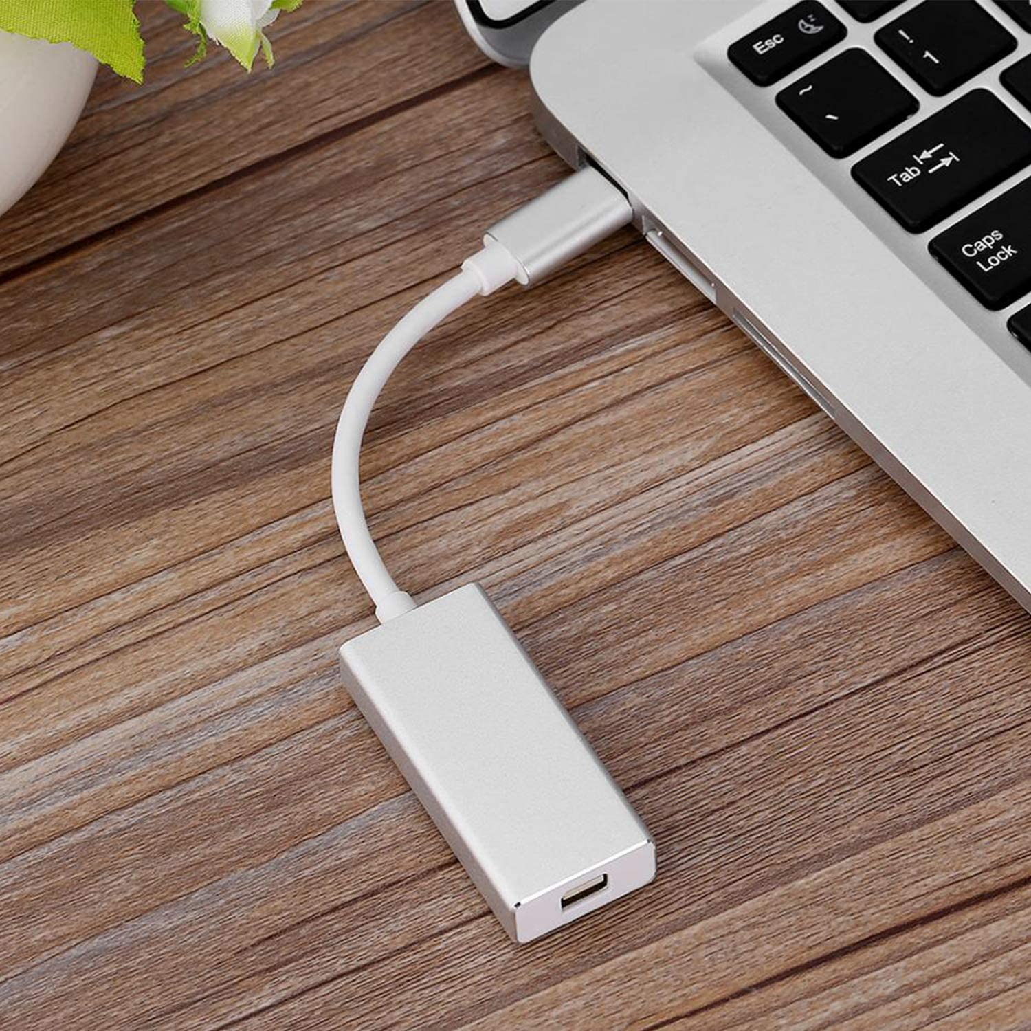

I have a pair of Viewsonic Dual-Link DVI monitors. I tried to connect them to my new Mac Pro 2019 using Dual-Link DVI to HDMI adapter. It didn't work! Can I connect them to my Mac Pro 7.1 using your scheme? I already have the DL DVI to mini DisplayPort adapters and the following was the only mini DisplayPort to Thunderbolt adapter I could find on Amazon:
All help is appreciated.
I have no experience using DL-DVI with HDMI. I would stick to the setup I have used as the only singles involved are DisplayPort and DL-DVI.
So USB-C to MiniDisplayPort adapter for the 7,1 (which is still just a DisplayPort signal all the way) combined with the Apple MiniDisplayPort to DL-DVI adapter (or similar kind) which converts the DisplayPort signal to DL-DVI.
Works for me! Shouldn't be any need to involve HDMI in that chain to keep things simpler.

Thanks for the confirmation tevion5! I already ordered the adapter in post #24. I assume the monitors are plugged into the USB-C jacks on the back of the Mac.

I'm currently using the below setup with my 7,1 and a Vega 64:
30" ACD23" ACD27" MSI 144Hz Display
DisplayPort - MiniDisplayPort - DL-DVI
(Requires Apple MiniDP - DL-DVI Adapter)
DisplayPort - DVIDisplayPort (directly)
As you can see the 30" requires a bit of a chain, but I see no reason why I couldn't run say 6 of them if I had a 2nd Vega 64, 6 x 30" ACDs and 6 x Apple DL-DVI Adapters! €€€
If you are still using the original Radeon Pro 580 (which was the case in my original post) you would be limited to the 2 USB-C ports on the back of the card for DisplayPort, but still I see no reason why at least 2 x 30" ACDs would not work.

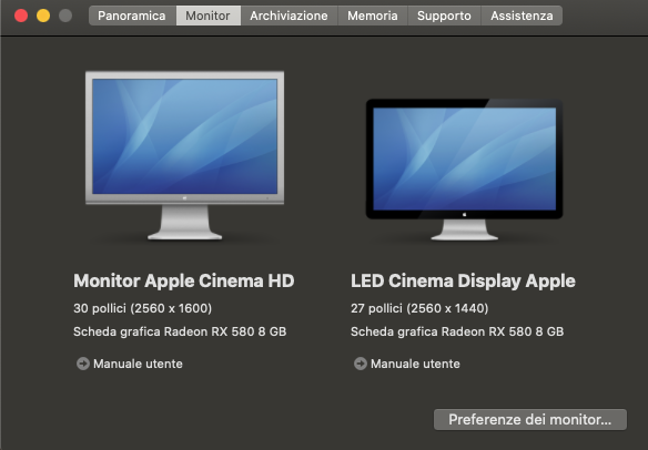

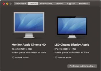

First of all I hope to be in the right thread!
I don't have a MacPro 2019, but I have a MacPro 5.1 with the AMD Radeon VII graphics card and Apple Cinema Display 30".
In order to connect the monitor to the graphics card, I had to purchase a StarTech "DisplayPort to DVI DualLink Active Adapter" which, however, does not seem to work well!
In fact (as you can see from the attached Image 1), when you start the Mac (both from Mojave and Catalina), the monitor indicates the Default Resolution, 1280 x 800 and therefore every time I have to change the resolution from monitor preferences to bring it to the maximum of 2560 x 1600.
Also, every now and then, the monitor shows annoying flicker!
The same thing happens with the Sapphire RX 580 graphics card (which has both the DVI-DL and DP port) when I try to connect it to the DP port with the same adapter (unlike when it is connected directly to the DualLink DVI port as seen in the 'Image 2 attached).
So it looks like this adapter is not working well!
Based on your experience and your use, if I used the original "Apple Mini DisplayPort to DualLink DVI Adapter" with the addition of a DP adapter ---> Mini DP (which I am already using successfully with the second monitor LED Cinema Display 27"), could you solve the problem and have the Default Resolution of 2560 x 1600?
Thanks in advance for all the help you want to give me!

That could work as long as you're not planning to use Windows. In Windows the Radeon Pro and regular Radeon drivers clash, so you can only use either the Pro 580 or Vega 64 at once. I've my Radeon Pro 580 sitting in storage for now for this reason.
Yes this solutions seems to work really well for me. Might just be an advantage of compatibility with Apple's own Mini DP ---> DL-DVI adapter. I always get the correct 2560 x 1600 by default with no issues on my setup, and that's using it with a DP adapter ---> Mini DP from my Vega 64. So probably worth trying this before giving up 🙂
