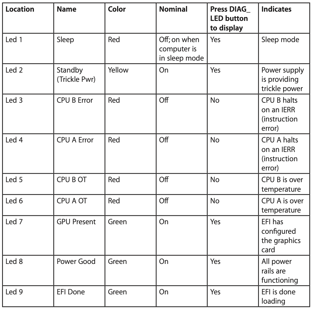

Reactions: user1647
Good to have that table for future reference.
